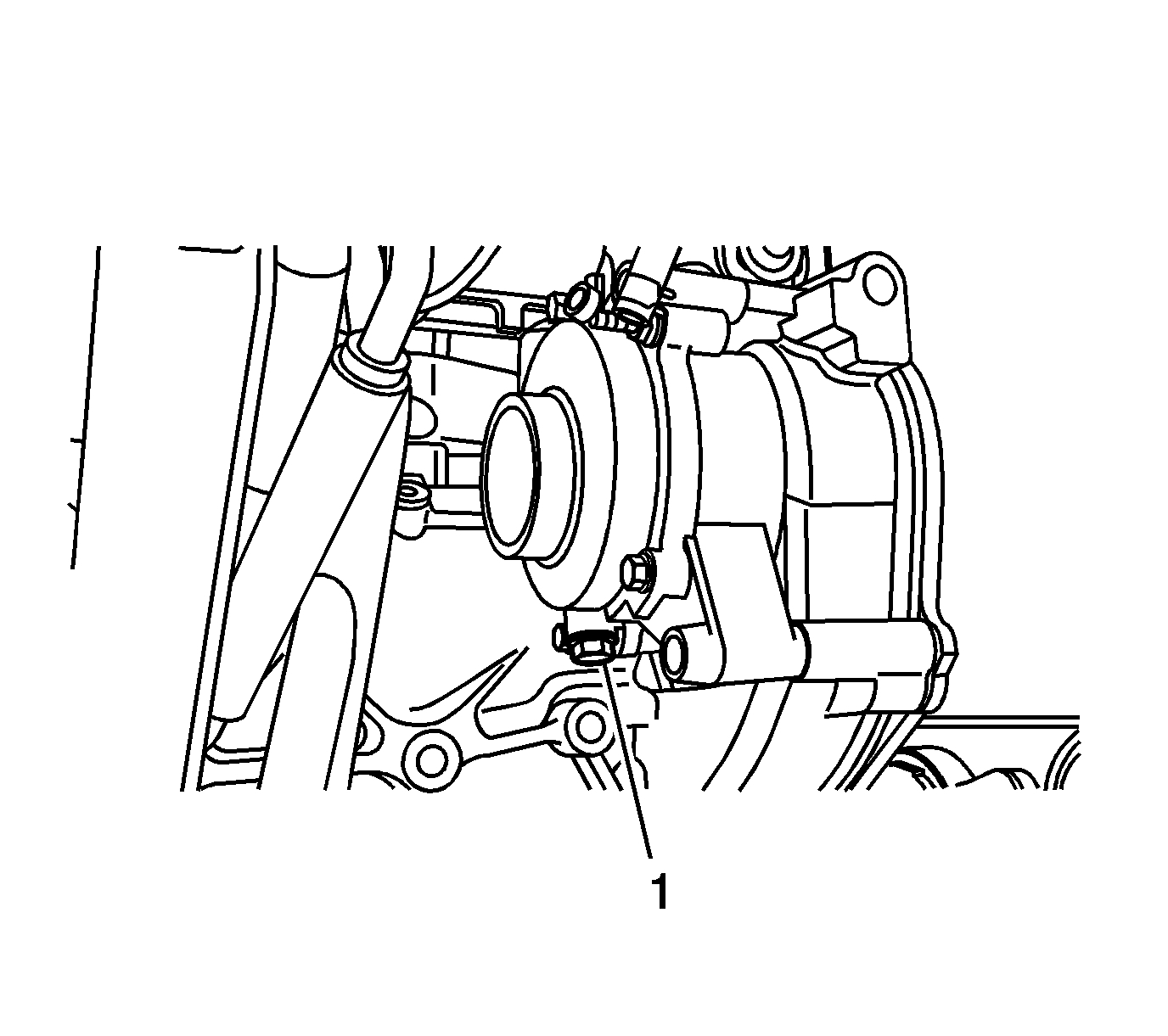

I have flushed and filled coolant system and changed thermostat. I have added new coolant. The temperature gauge will randomly start overheating! The heater sometimes will not get warm!
Please help!

What you described with the heater makes me question if there is air in the system. Do me a favor, take a look at this portion of the coolant refill procedure, and see if it helps.

1. Tighten the radiator drain cock to 2 Nm (18 lb in).
pic 1
2. Install the water pump drain plug and tighten to 10 Nm (89 lb in) if removed during the draining process.

When you refilled the coolant, did you use dexcool? Is there any chance that the original coolant (dex-cool) was mixed with a different type of engine coolant?
Let me know if this helps.
