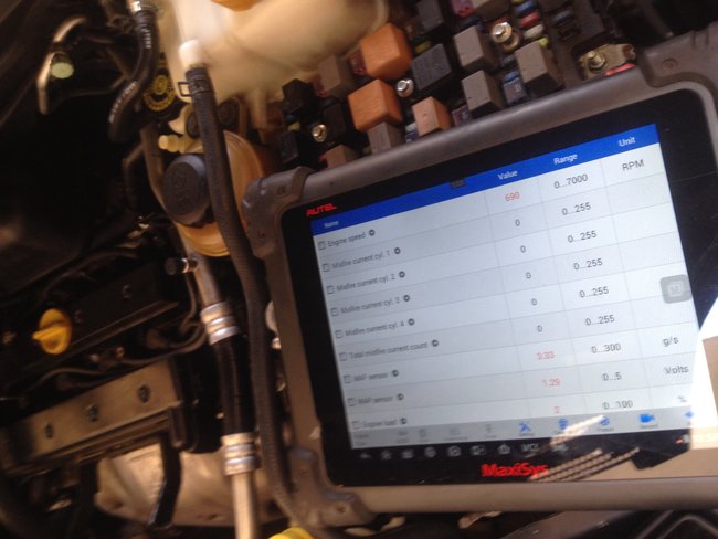

Hello
In the morning it does not start up from first try and the next problem is the idle is too low and when I put it in drive the rpm's are jumping, but not always. I change the plugs and the coil cable and the distribution and still the same. I opened the throttle I could see oil inside, I cleaned it and after two days the the problem returned. I took it to the garage to have it scanned to see the misfire in all cylinders .
Any ideas?
Thank you

I would check the fuel pump make sure the fuel pressure is not leaking down over night.

Maybe the coolant temp sensor is not reading that its cold. sound like you may have a bad idle control or maybe a bad throttle body. Its hard to diag something like this without seeing or hearing it.

Have you thought of the mass air flow sensor? If this sensor is dirty with contamination it will give a false reading the computer, follow the guide below to clean and get back to us.

If the the mass air flow not working it will show an error in the computer test or the light chek engin go ON but we dont have any error reading in the computer ????
Apr 19, 2016 at 1:45 PM
  • 54,837 POSTS
No error will be recorded because the reading is simply off but not enough to set an error code. Please try to clean it to see how it does, the mileage is perfect for this kind of repair although replacement is the best way to fix this kind of problem, that's why the dealership has an advantage they just pull on off the shelf and then put it back if it doesn't work. let me know what you find.

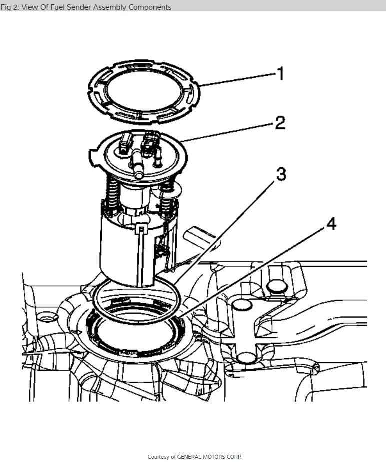

I tried in the morning to turn on and off 4 times and i start the car it turn on from the first time i think the pump pressure has a problem can you please send me the manual of my car and how can i repair or replace this pump.

To change the fuel pump you must drop the tank, its best if you have it low on gas or drain the gas,
here is a leak on how
https://www.2carpros.com/articles/how-to-replace-an-electric-fuel-pump
and a pic once you get the tank out

Please i need the manual of the gmc terrain 2009 it will be easy for me to make the installation because its under the rear seat

This must be an out of the country car because we don't have this model in our Mitchell1 software. It will be very close tot he same because there is not much difference.

Is the what you need a pic of the tank or?
