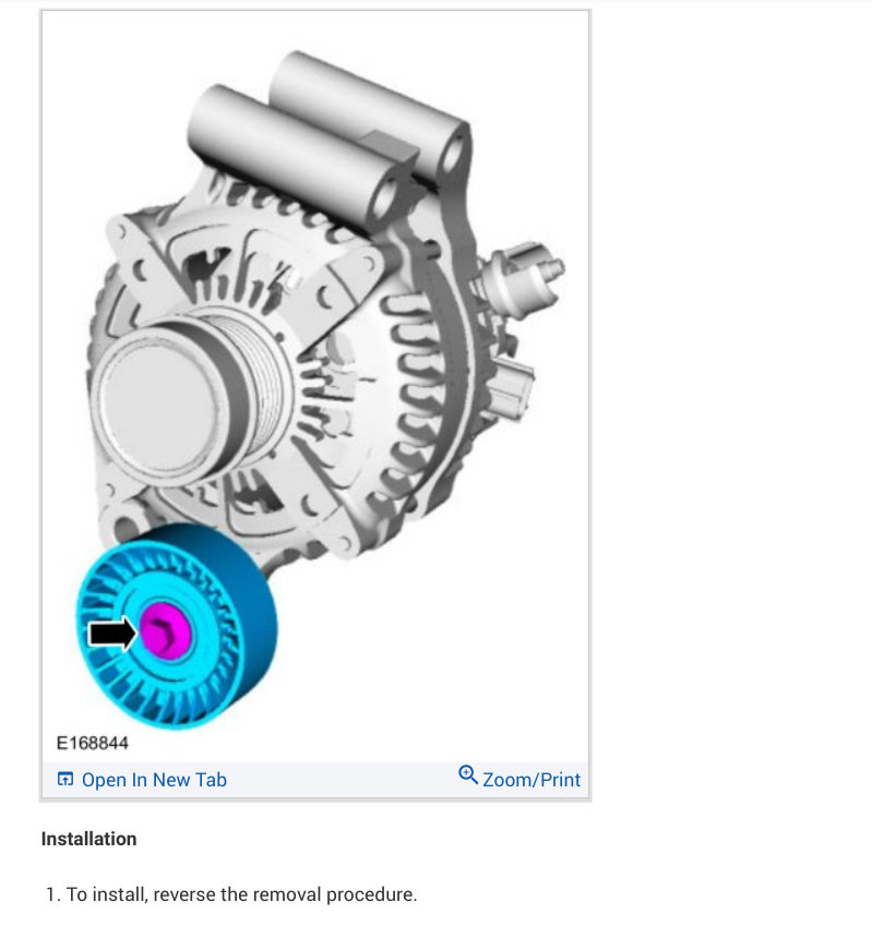

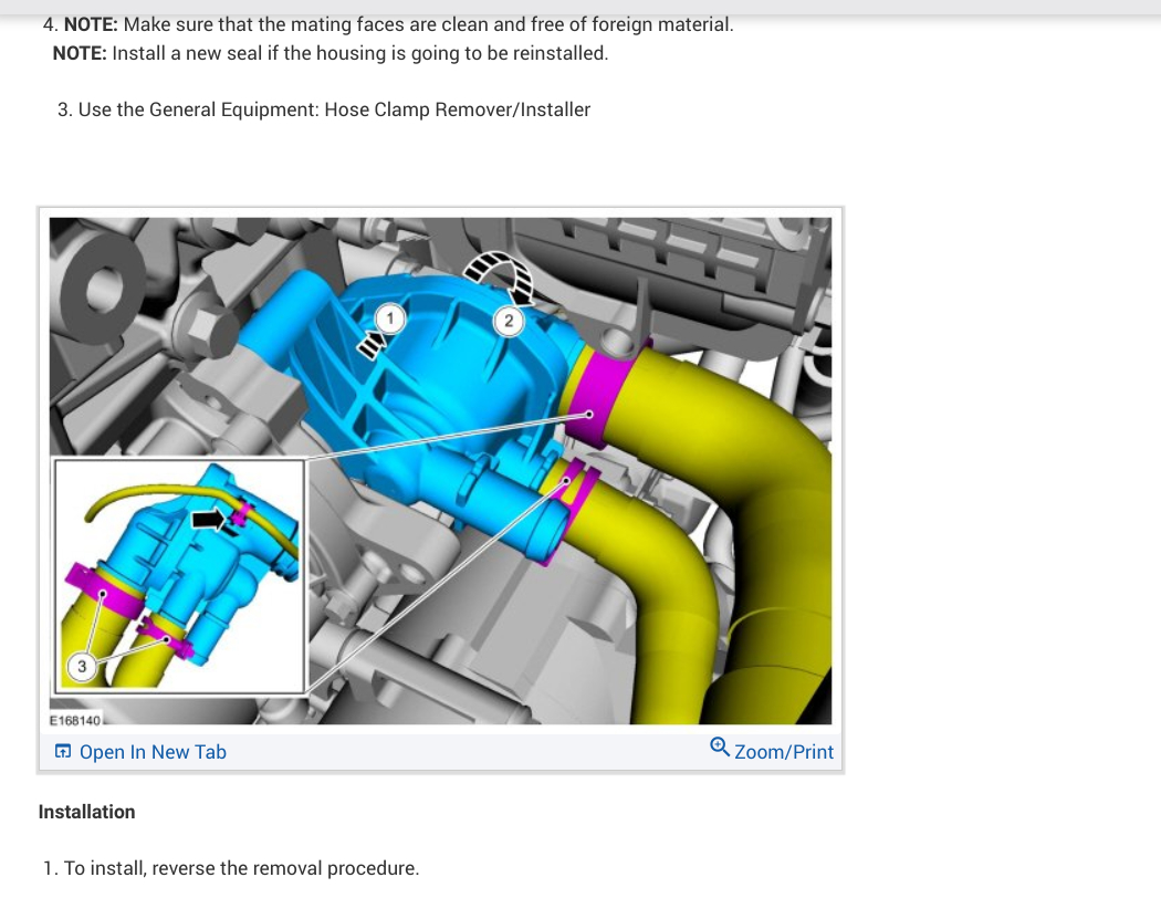

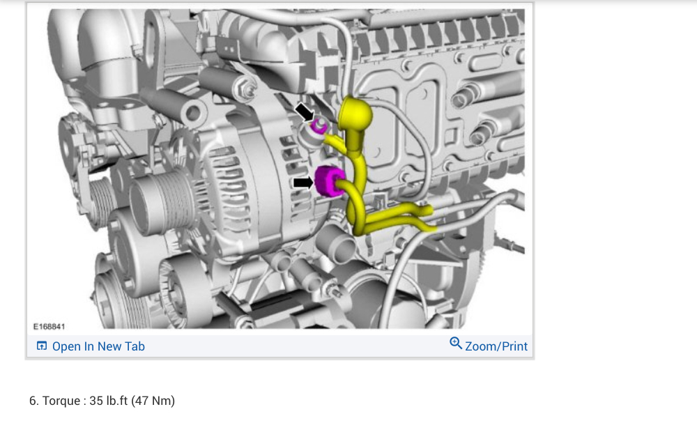

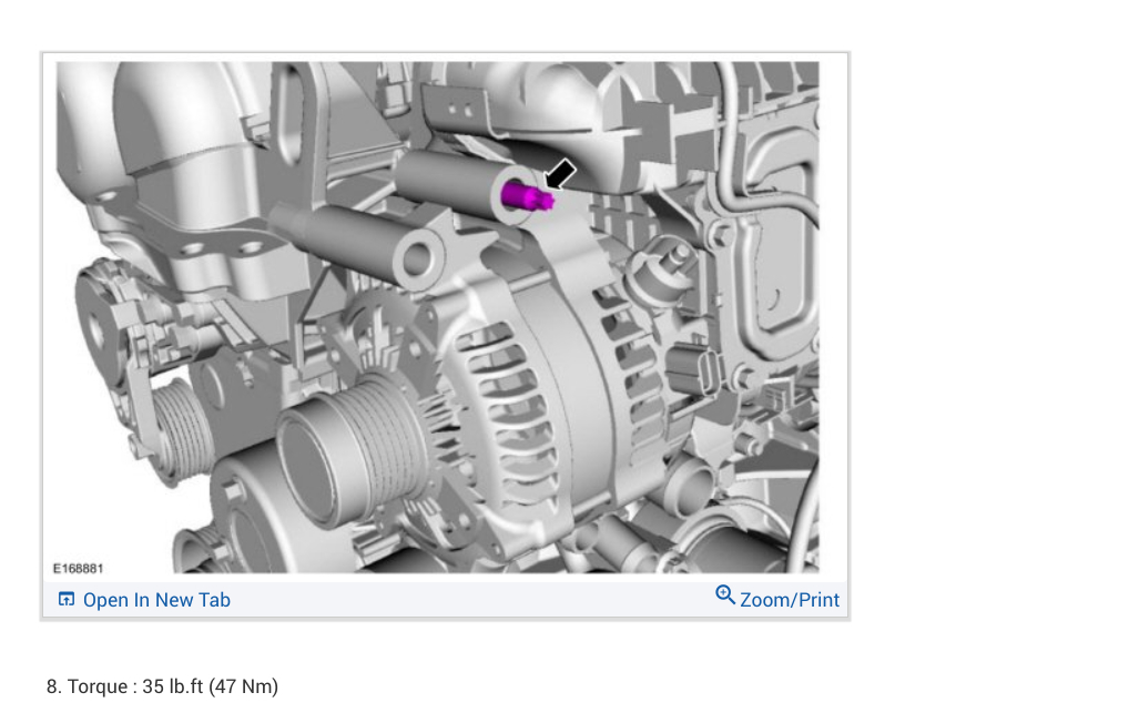

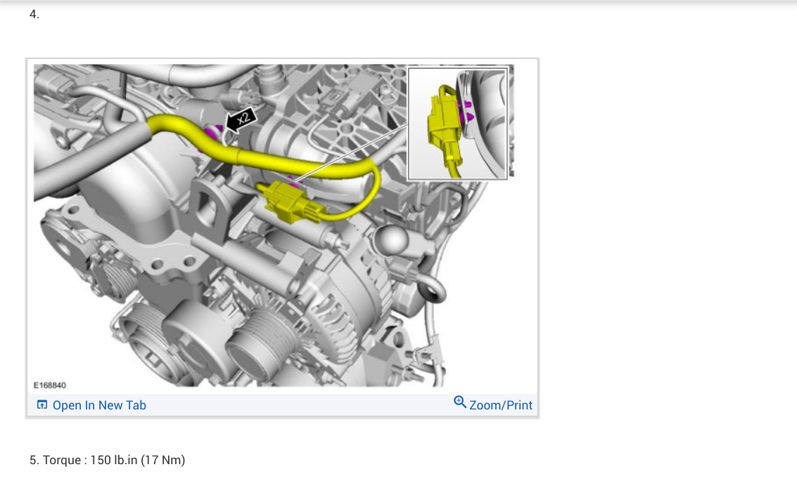

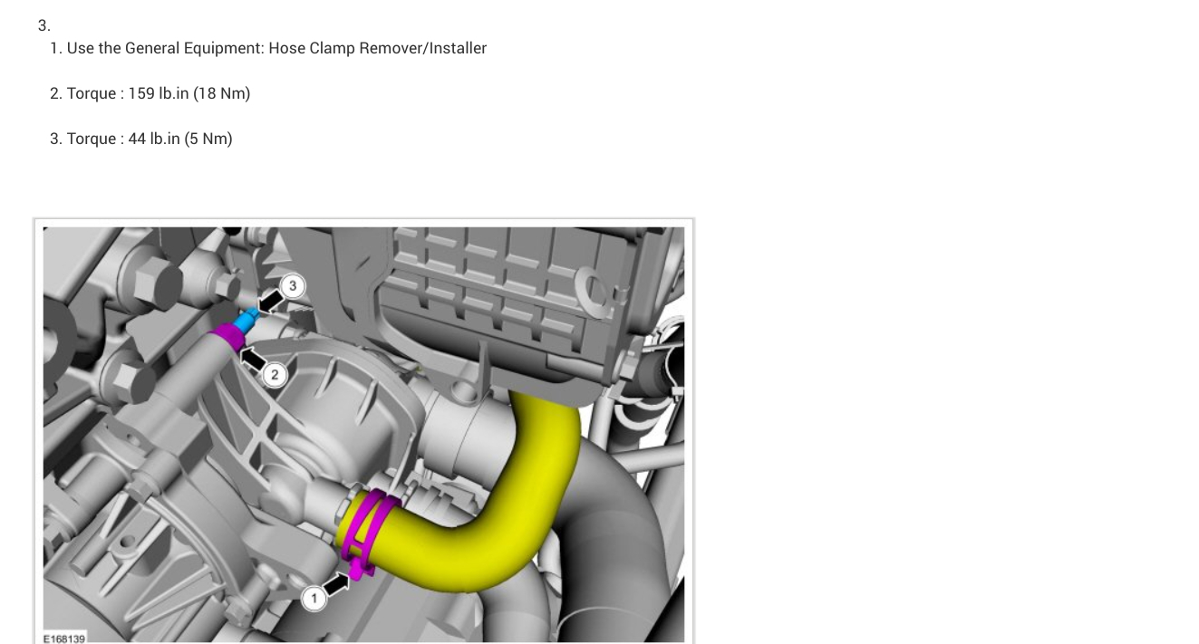

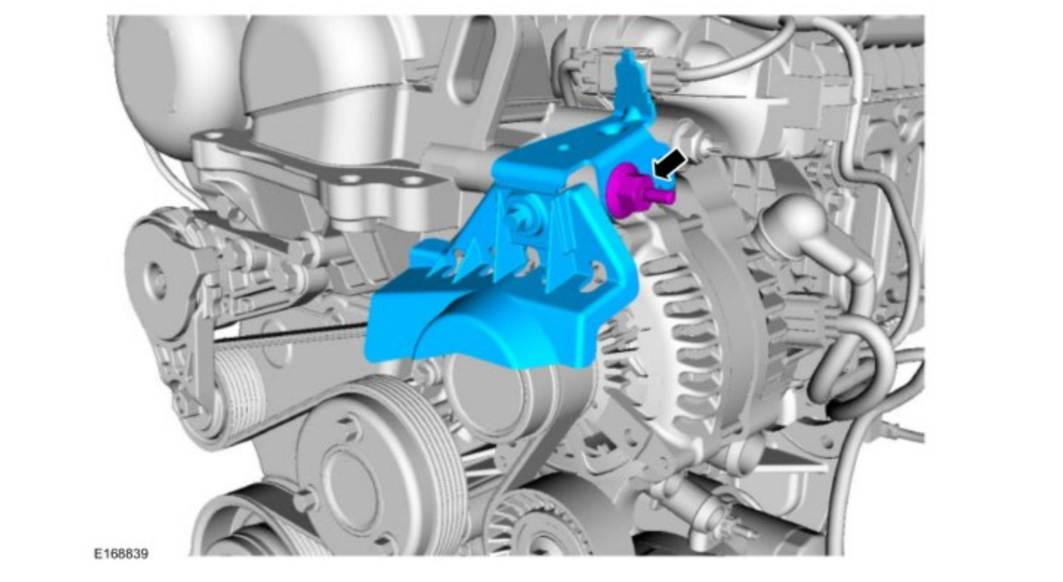

Overheated,replaced water pump.Engine coolant over temperature light still on and in Limp mode.
Dec 30, 2019 at 8:35 AM
SCGRANTURISMO
  • 4,897 POSTS

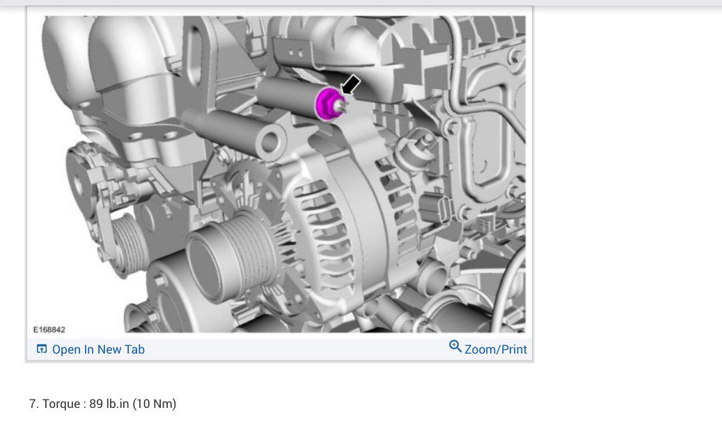

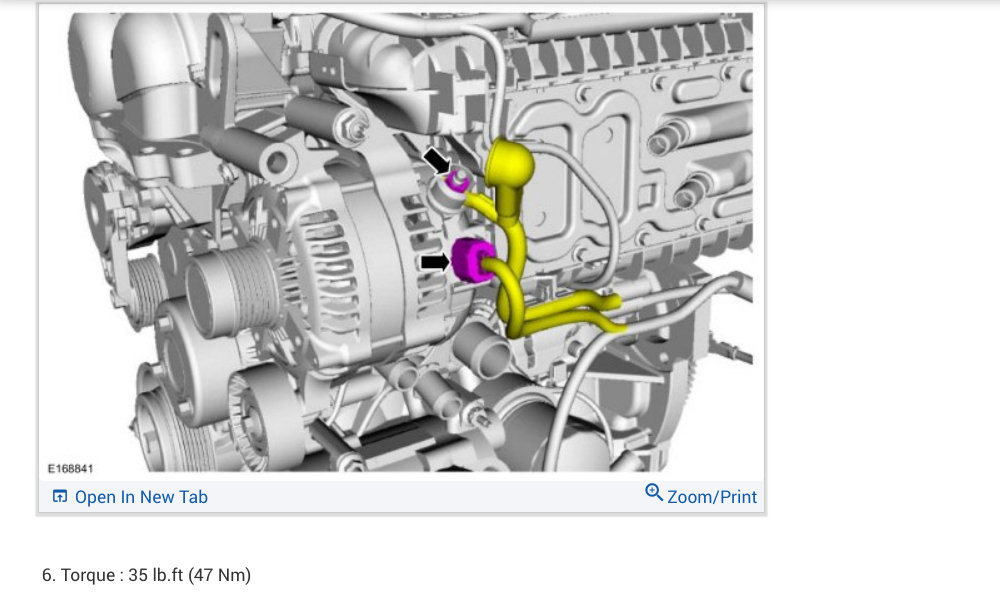

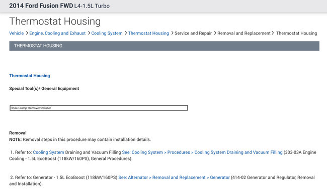

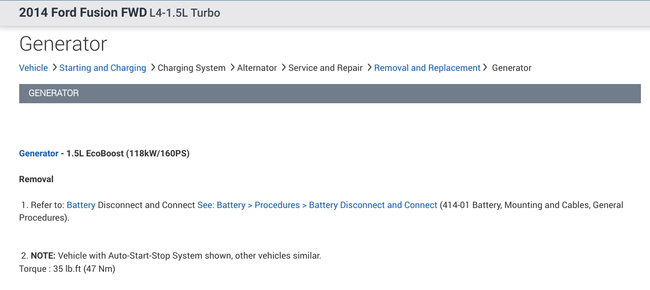

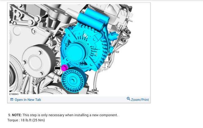

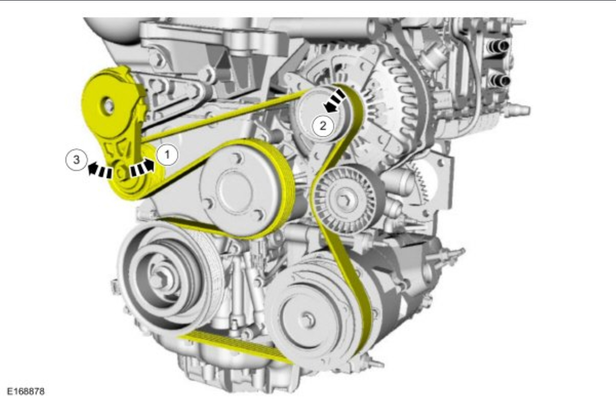

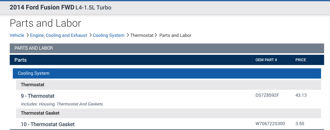

This sounds like you could be having a problem with your vehicle's thermostat. In the diagrams down below I have included the instructions from the vehicle manufacturer for the removal and installation of the thermostat for your vehicle as well as the Original Equipment Manufacturer[OEM] part number for the thermostat. Please go through these guides and get back to us with how everything turns out.
Thanks,
Alex
2CarPros
Jan 1, 2020 at 3:25 AM
