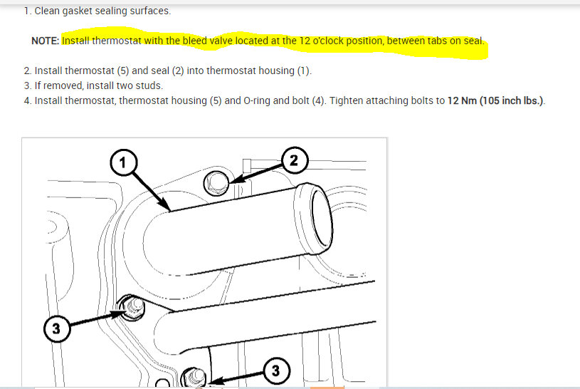

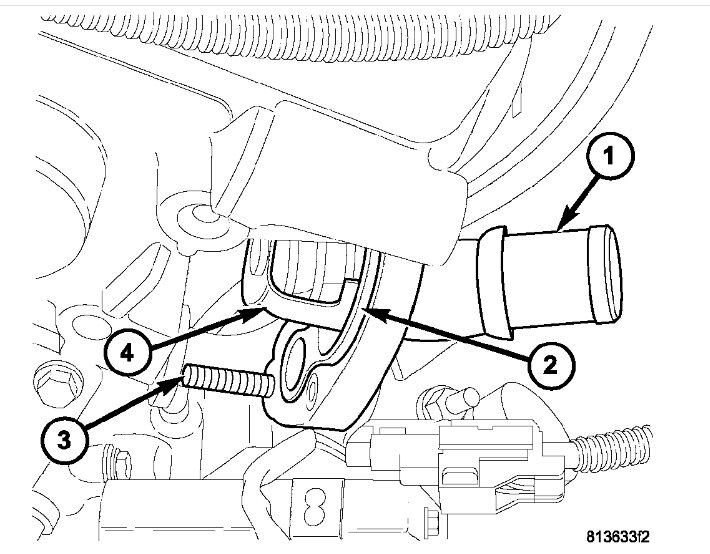

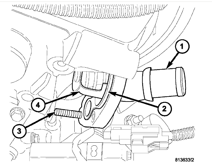

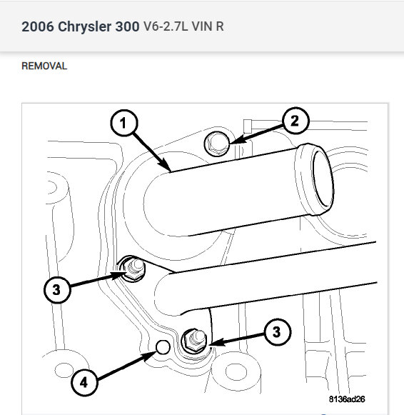

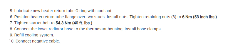

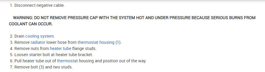

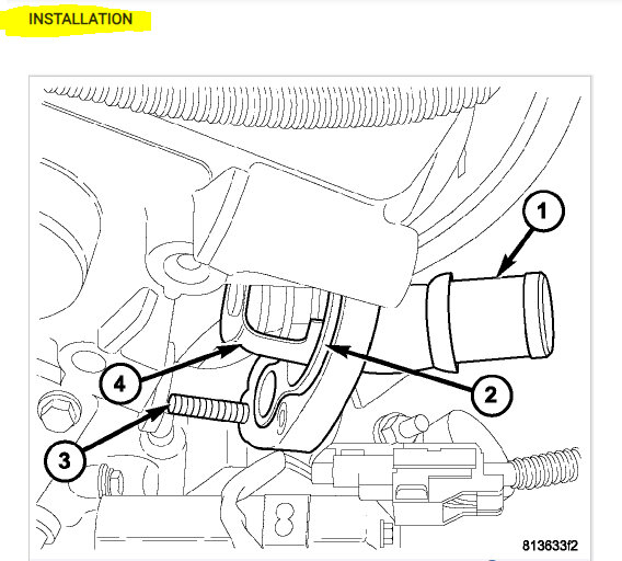

Yes can you give me the steps in order to change my thermostat plz thank you
Jul 11, 2023 at 6:01 AM
  • 110,244 POSTS
No problem whatsoever. To get you started, take a look through this link. It is in general, but the pics sometimes are more helpful than the manual. LOL
If you look below, I attached the directions specific to your vehicle. Take a look through these things and let me know if they help or if you have other questions.
