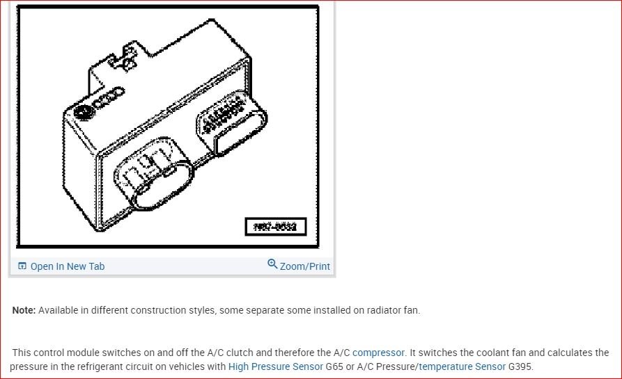

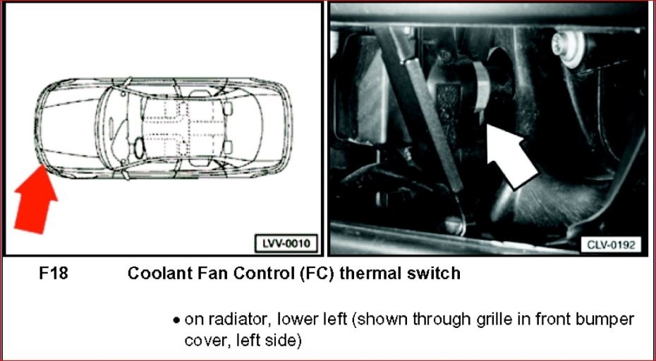

I have replaced both temperature sensors and the cooling fan relay. but the cooling fan won't stay in after about two minutes causing the car to overheat.
Apr 26, 2019 at 3:15 PM
Hi Jennifer,

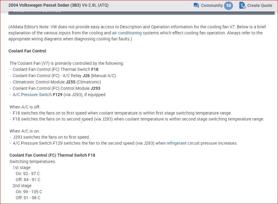

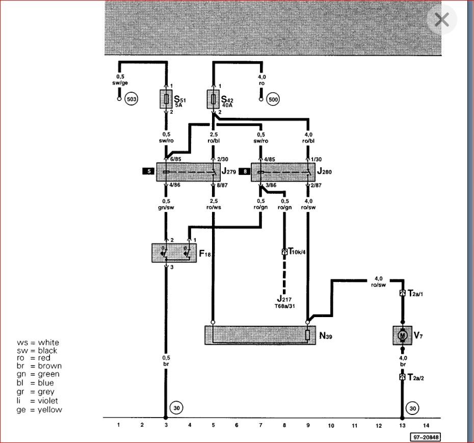

Sounds like if the fan works but then shuts off, the second speed is not coming on. Do you notice the speed of the fan ever increase before it shuts off?

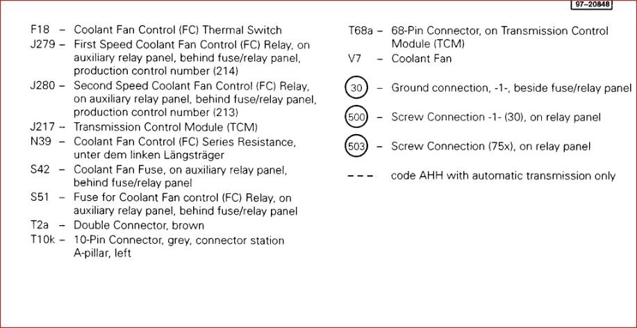

It looks like there are two possible systems for your vehicle. The 80W and 300W.
The 300W system has a second relay that controls the second speed for the fan. It could be as simple as this.

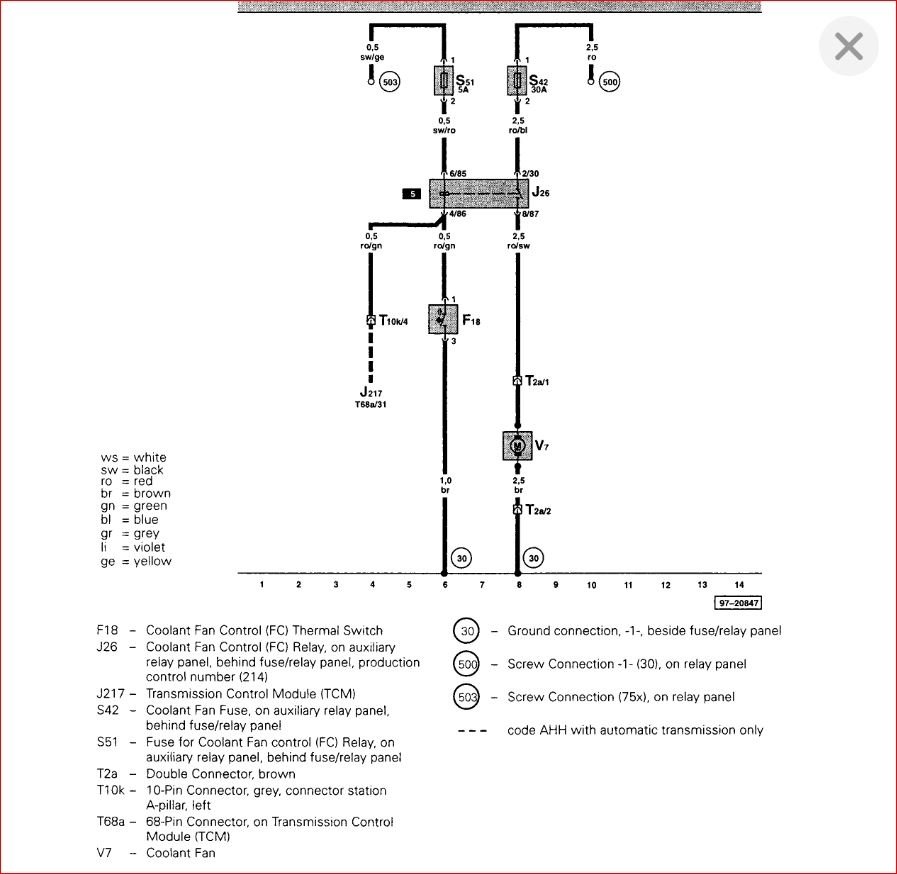

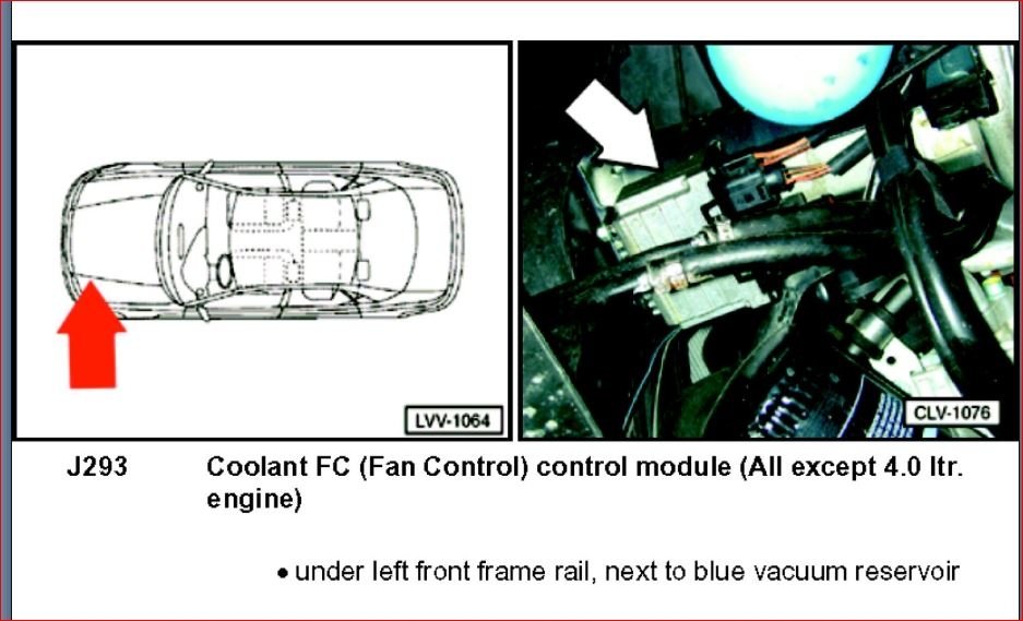

However, there also appears to be a coolant fan control module that controls this system. Take a look at the fifth attachment and it explains the operation.
Take a look at this material and let me know what you think and we can go from there. Thanks

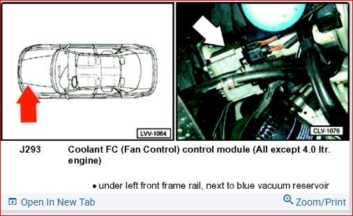

So I'm not sure these diagrams are helping me any, but I'm looking. When I said cooling fan relay switch I should have said control module. I basically followed the power from the fan back to the battery, changing sensors and relay module along the way. After changing the two temperature sensors there was still no fan, so I changed the control module (located at the bottom front of the frame). The fan then turned on for about two minutes before shutting off again, and I haven't seen it running since. The fan spins freely by hand so I don't believe the bearing are seized.

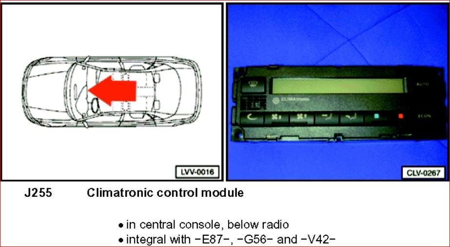

The fact that you said you replaced the relay and the module on the frame rail, I assume you have manual AC? Auto or Climatronic is controlled by the fan control module alone and not any relays.

I don't have a voltage meter. I do have Climatron. AC works but causes overheating so I'm afraid to turn it on. This has been an ongoing problem. The thermostat, thermostat housing,radiator and reservoir are all new. I tested the fan by direct connection to the battery and it worked. That's when I started changing sensors. Is it possible that the fan is the issue or am I missing a sensor somewhere along the way?

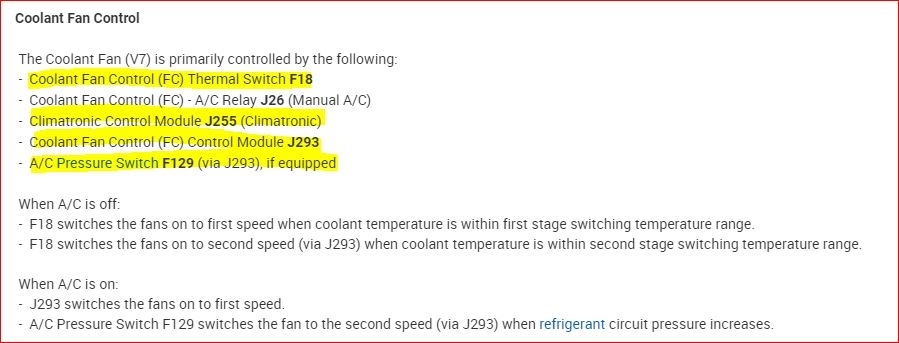

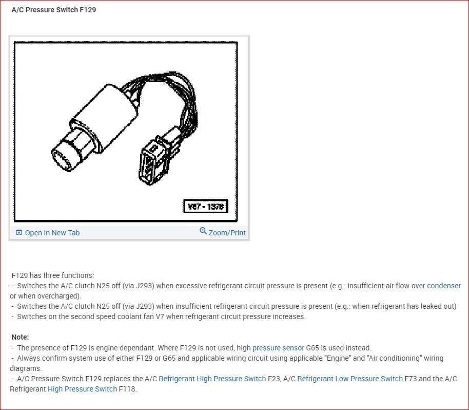

What I can't wrap my head around is you changed the fan control module and it ran for two minutes. This makes me nervous that you either have a bad module that failed or something is shorting the module out. There are basically four things that control the fan and they are highlighted in the attachment. I don't think your issue has anything to do with AC because your coolant fan should be running in most cases even with the AC off.

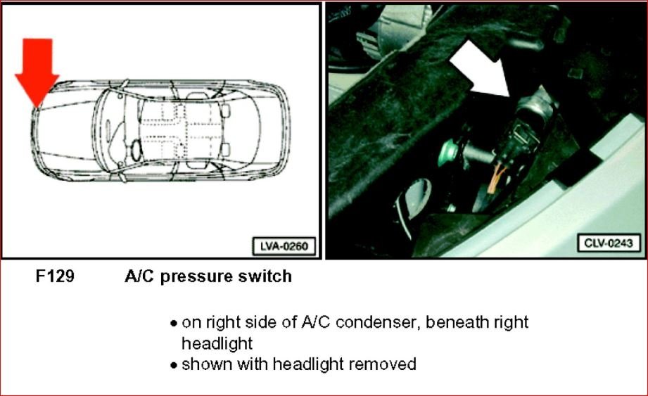

Just to be sure, your vehicle has two fans correct? And the one on the driver side of the vehicle is the one not running or do you only have one fan? If you only have one fan then it could be the AC pressure switch.

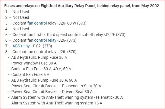

What I would suggest at this point is to have the vehicle hooked up to a scan tool capable of monitoring the Fan Control Module. We need to see what this is doing. Is it commanding the fan on and it is not on? Is it reading a sensor that is telling it not to turn a fan on which would indicate a faulty sensor? Are the sensors reading properly and the fan control is just not commanding the fan on?

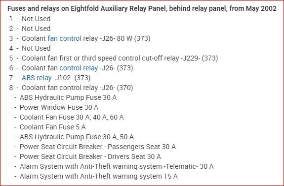

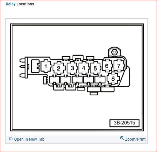

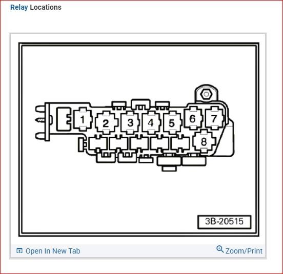

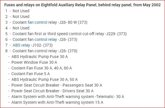

The other thing you can check before you have it checked out with a scan tool is if you checked the relays for the fan control module? You do not have fuses/relays for the fan itself but you do have two for the control module. I find it unlikely that these are your issue because I don't think you changed them and you said the fan came on after the module was replaced. This would show that they are okay but it is worth checking. They are in the relay panel (Eight-way) behind the main relay panel.
