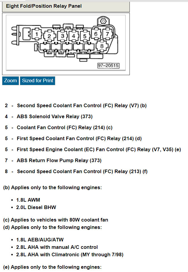

My cooling fan is not working and cannot locate the fuse for it. can anyone tell me where to find the cooling fan fuse box? 2.8 L v6.

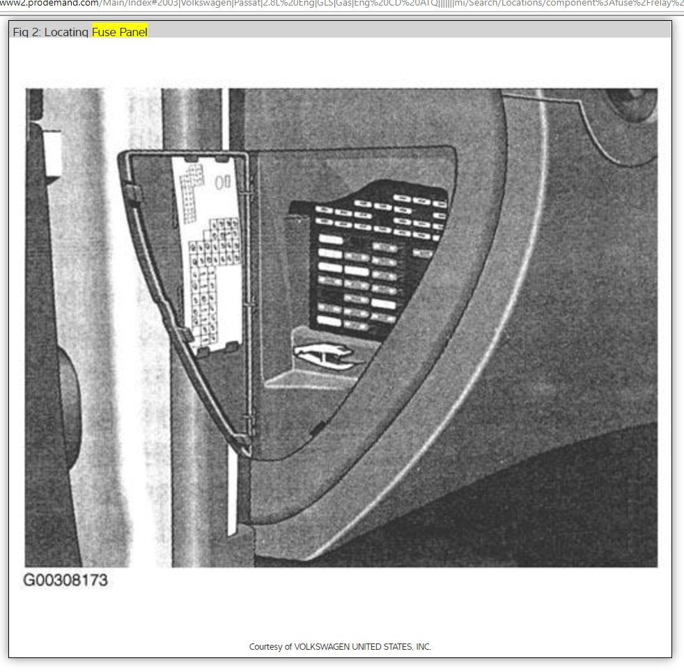

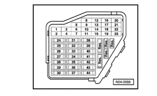

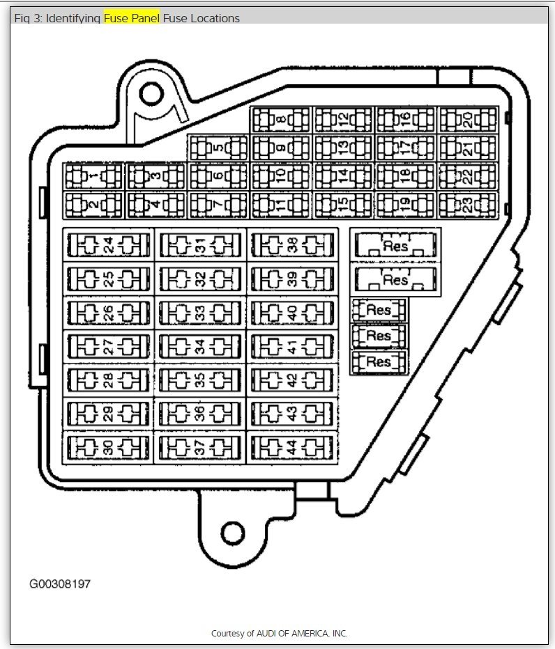

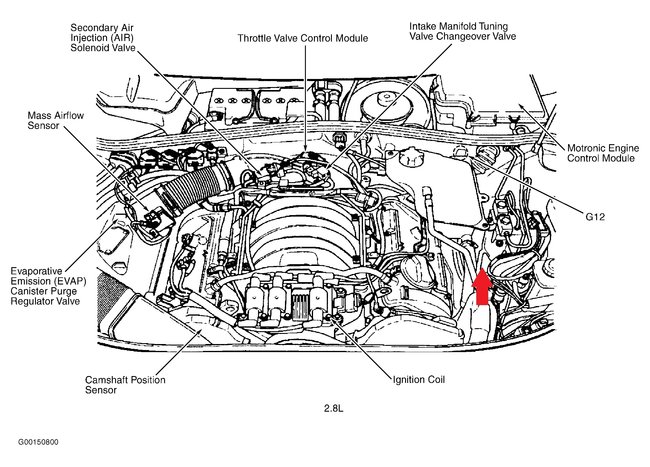

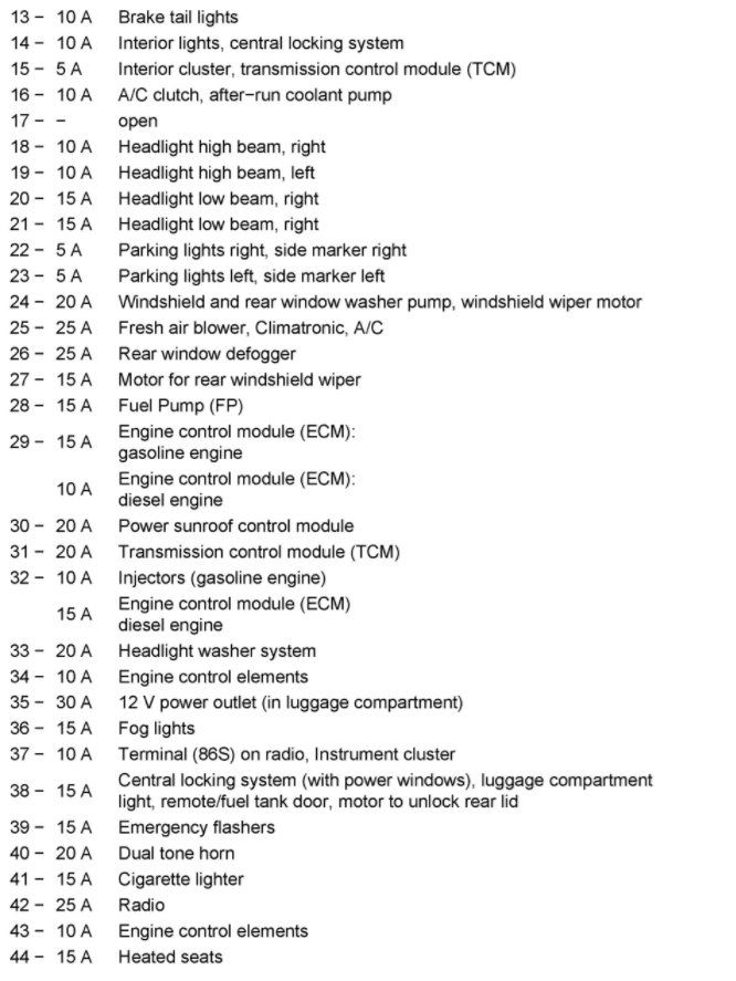

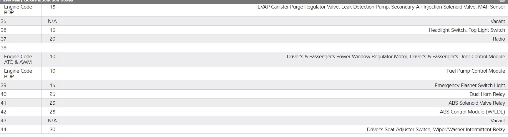

There are two fuses under the left side of the dash. Fuse number 42 is a 40-amp fuse, and fuse number 51 is a 5-amp. Both circuits feed an electronic fan control module that is mounted on the left front frame rail, near the vacuum reservoir.
Feb 13, 2017 at 5:09 AM
IDALIS
Is this under the hood and I can't locate the box at all and I need detail by detail a little bad at this
Feb 13, 2017 at 6:33 AM
CARADIODOC
  • 34,380 POSTS
My source shows almost every part, . . . except the fuse box and fan control module. They only list a description in the component locator guide. The module is listed as, "on the left front frame rail, near the vacuum reservoir". The fuse box, and all three relay panels, are listed as "under left side of dash". I added a nifty red arrow to the third drawing where it sounds like the control module is buried. From looking at the diagram, it appears the module has one two-wire connector, another six-wire connector that has only four wires in it, and two more wires that appear to be hard-wired and not in a connector.
Check the radiator fan to see if it spins freely by hand, or if it's tight. When you fling it with your fingers, it should coast to a stop after a few revolutions. If it doesn't, it has tight bearings. That will cause it to blow the 40-amp fuse. When the insane engineers feel the need to add an unnecessary computer module to the circuit, that can also be damaged by a tight motor, so be sure to replace the motor, if it is tight, before replacing other parts, otherwise those new parts can be damaged again.

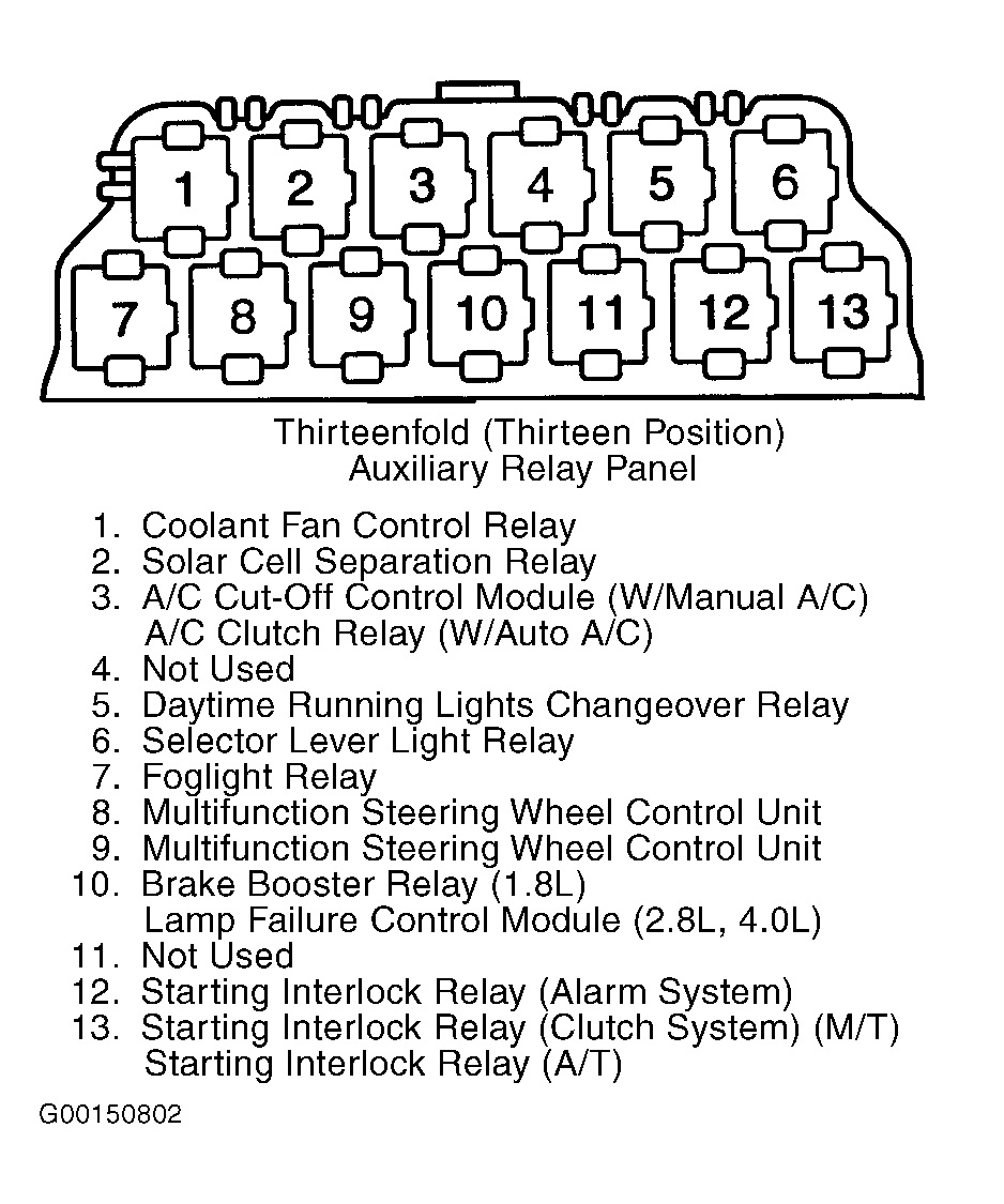

Ok lets run a quick test to see if the fan relay is working ok. Now what I need you to do is with the car running and the A/C on check for power at the fan relay check the brown wire with the black stripe. If this is good then check for power at the a/c pressure switch on the condensor below the right side headlight (passanger side). Let me know what you find here and we will go from there.
Jun 26, 2019 at 6:29 AM (Merged)
KZCPD

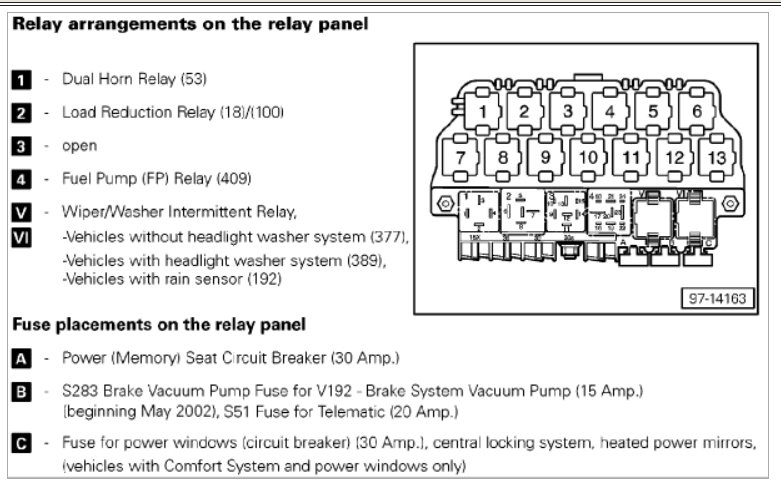

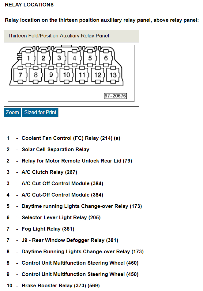

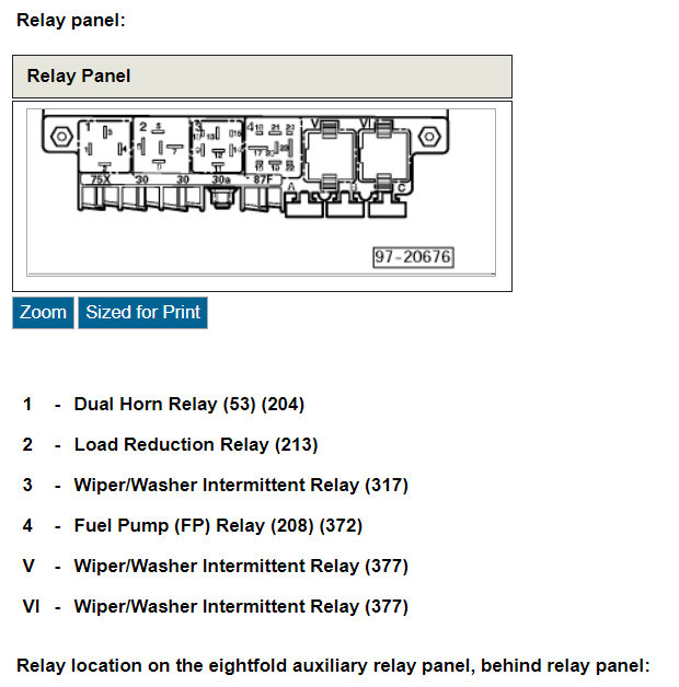

Where's the relay for the cooling fan? Is there a number on the relay? Is it in the under the dash by the fuses?

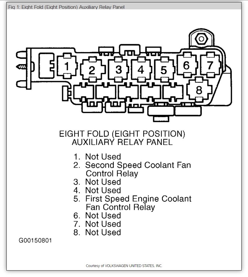

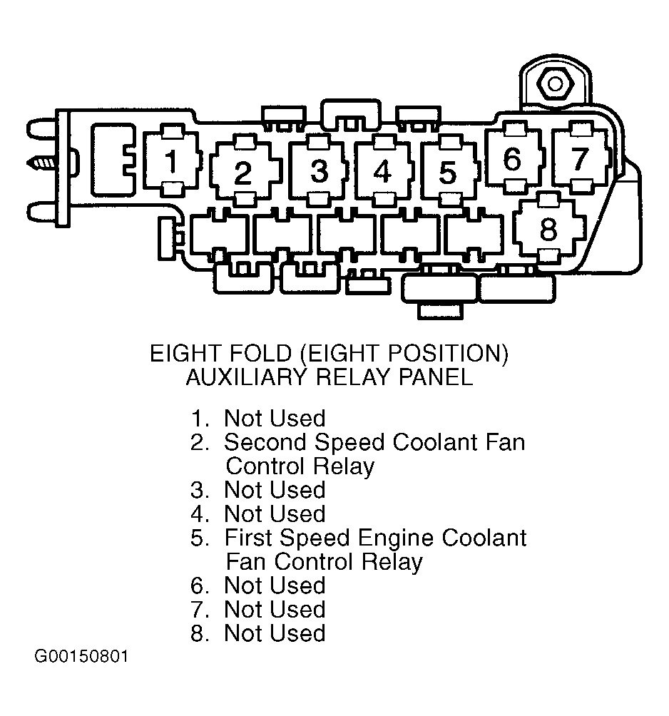

RACEFAN966
  • 5,029 POSTS

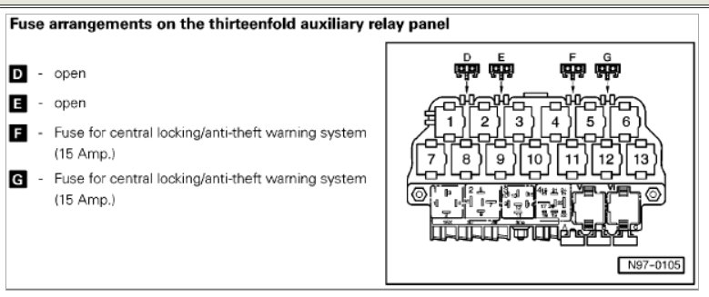

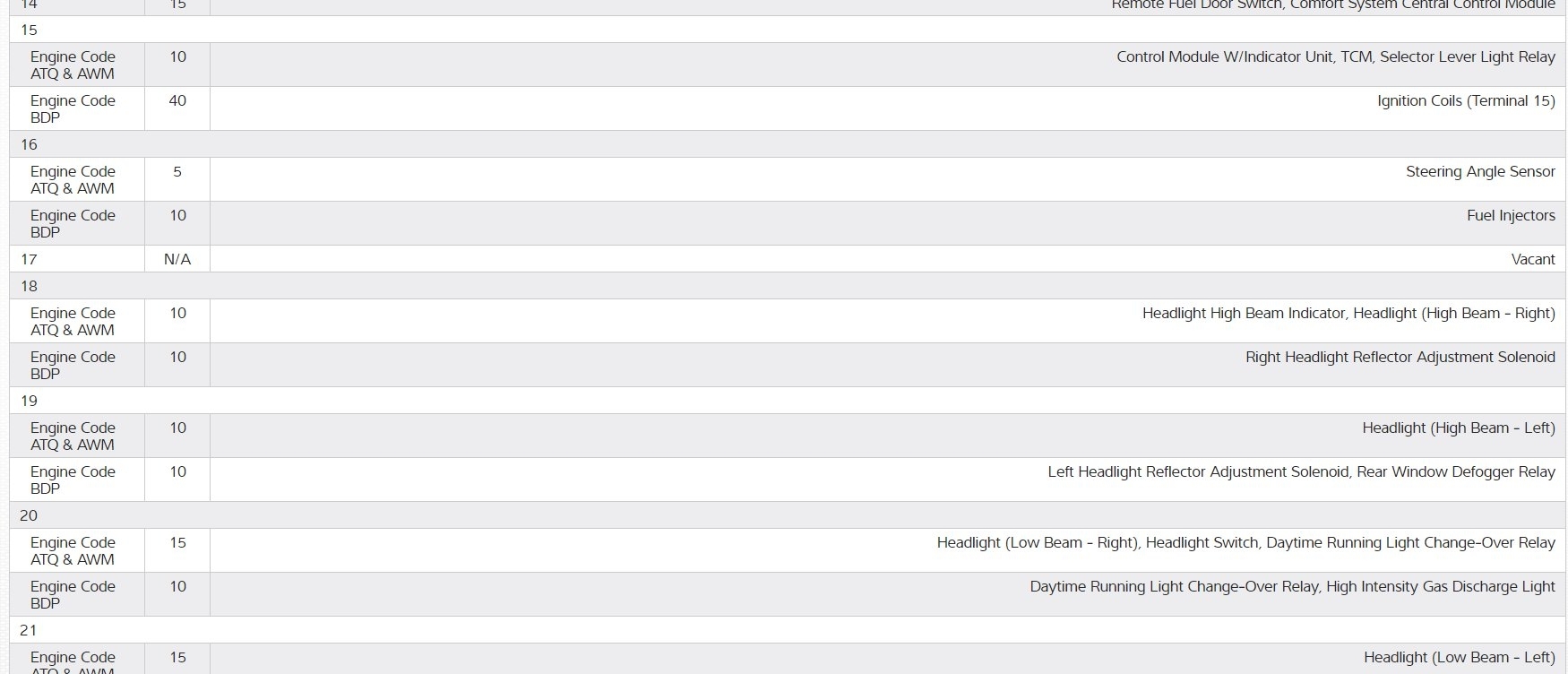

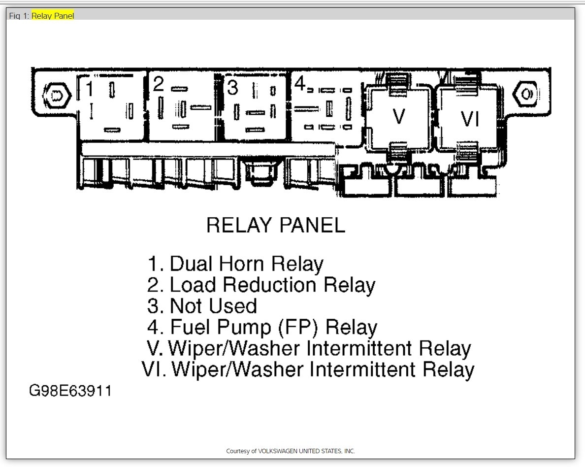

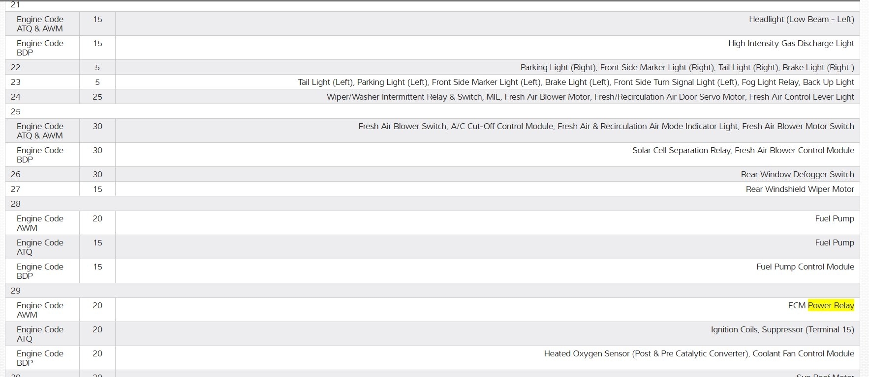

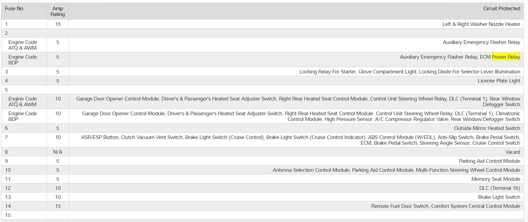

Here are the fuse panel diagrams and guides to help you find the fuse and relay and how to test them.
and
Cheers

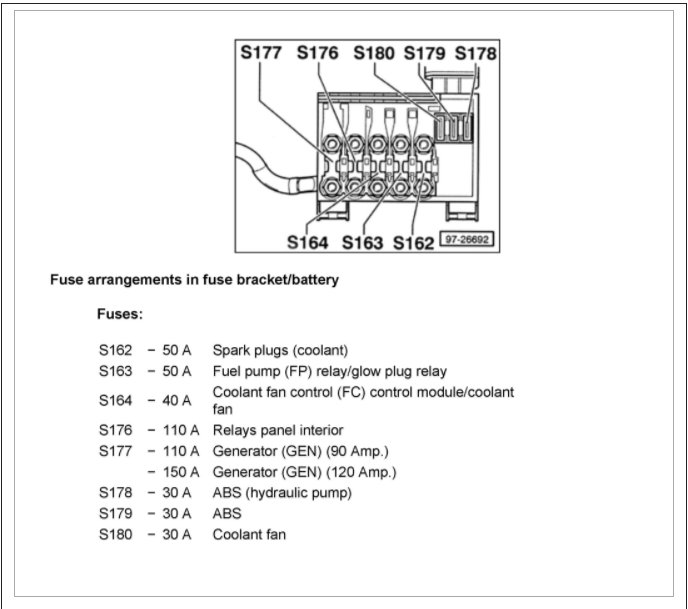

I need to know the relay number for radiator fan relay. Can someone tell me please?

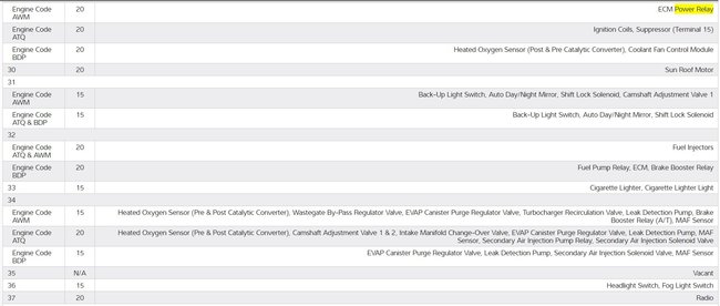

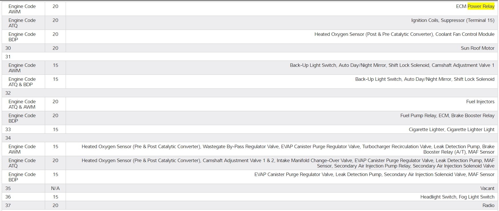

  • 55,402 POSTS
The relay is located under the hood, here are some guides and diagrams (below) to help you get the job done.
and
and
