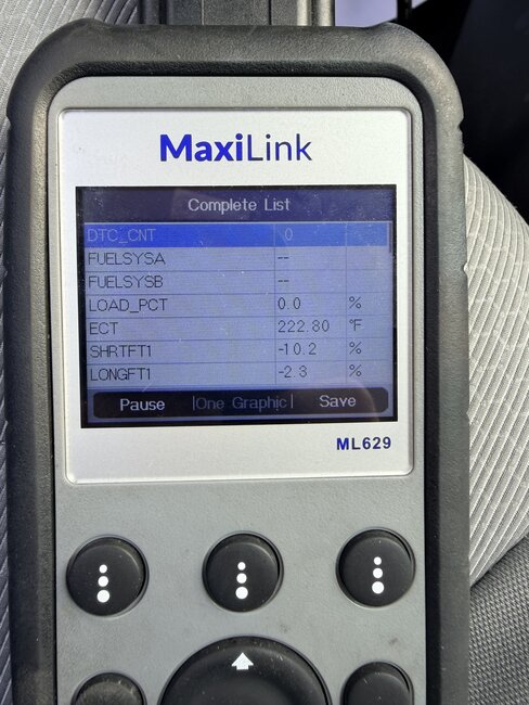

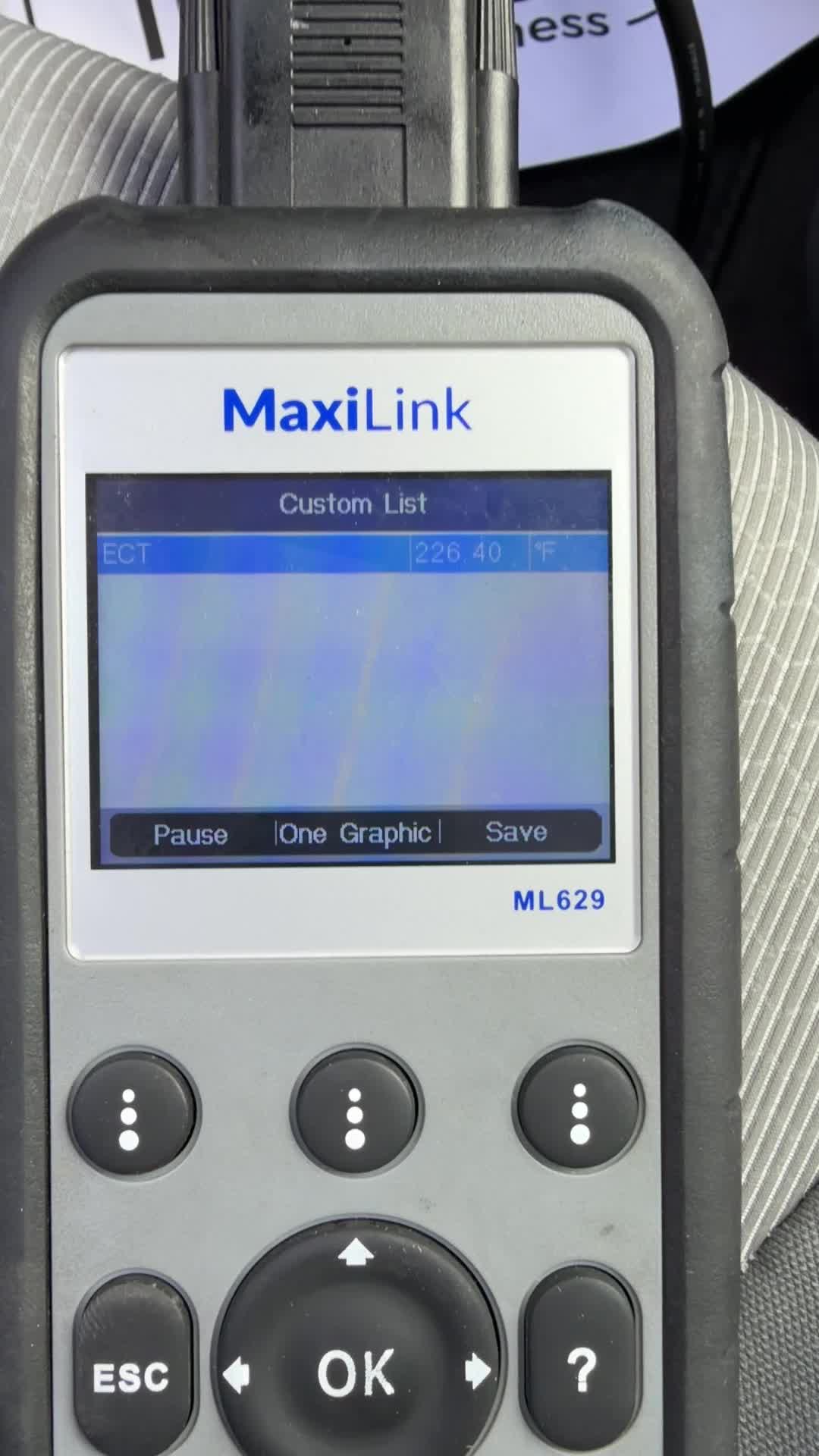

BHAMDOC1
  • 423 POSTS
Started it again and its now dropping to 226f. But a bit of rough rpm then stablizes. Now 224f

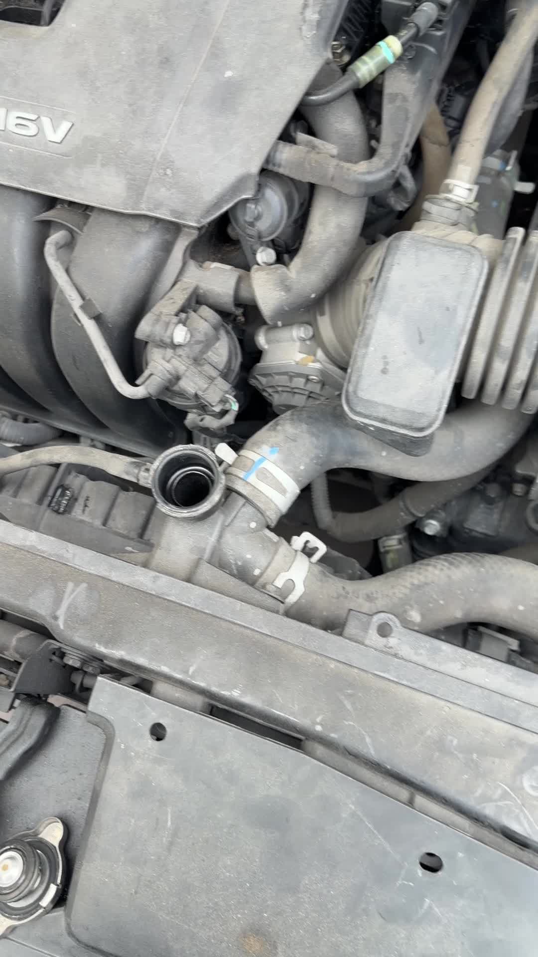

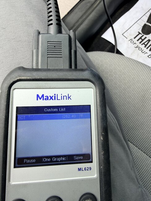

Kept it running a while while washing and all good took kt for quarter mile drive and it was fine on the way back all of a sudden goes up to max temp and idles funny. Stopped it and waited few then got home. Scanned it and was showing 262 dont make no sense it climbs that high that quick. Hoses are cool. Fan running, i also noticed no heat while driving, i was trying to get it to cool down. Even opened the radiator cap without any pressure and wasnt even hot. Then added water and started getting some smoke as you see. Let it sit then added ton of water most likely the radiator leaking . I just noticed few drops. Does the car go into limp mode if it overheats?
Jul 14, 2026 at 4:12 PM
  • 55,694 POSTS
Yep, this will be the ECT sensor which you replaced correct? Or you have a bad connection at the sensor or the PCM is bad.
Jul 15, 2026 at 9:34 AM
BHAMDOC1
  • 423 POSTS
no I only replaced the crank position sensor
Jul 15, 2026 at 9:37 AM
  • 55,694 POSTS
Then I would do the engine coolant temperature sensor for sure. I show you here it is at above.
