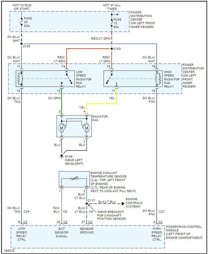

Fifteen minutes after starting the engine starts to overheat?
132,000 MILES • 2.7L • 6 CYL • 2WD • AUTOMATIC
DANDICKTEN41
The coolant reservoir is full. The thermostat is new.

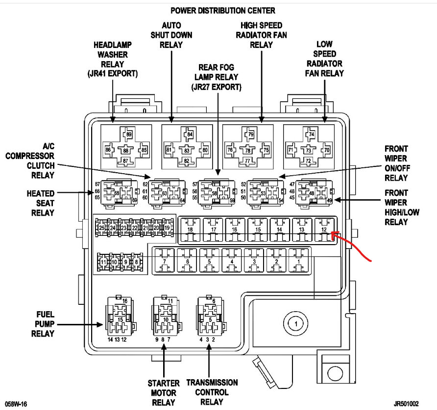

When the engine is overheating can you hear the cooling fans come on? If not, this is your problem. I would check the fuse #12 in the fuse panel under the hood for the cooling fans first.
These guides can help:
and go over this guide as well:
https://www.2carpros.com/articles/engine-overheating-or-running-hot

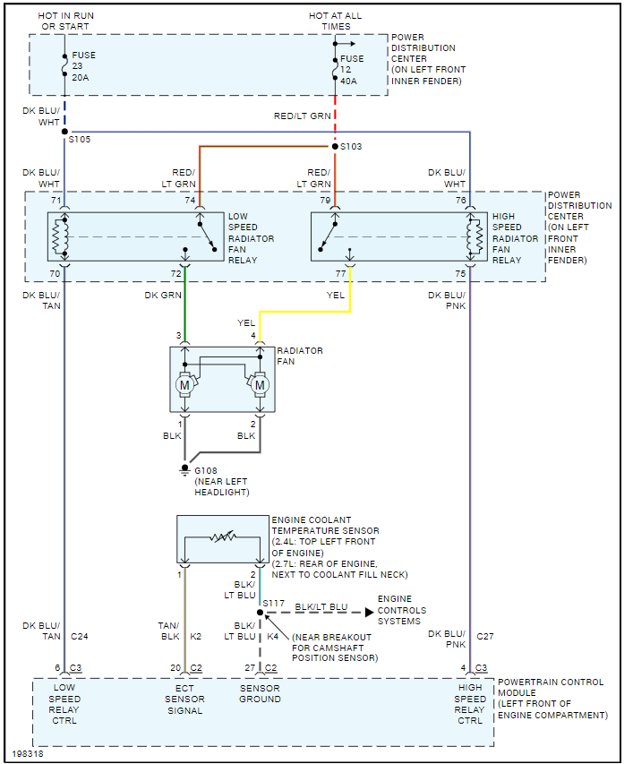

Here are the radiator cooling fan wiring diagrams so you can see how the system works. Check out the images (below). Please let us know what happens.
