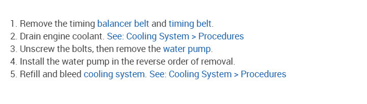

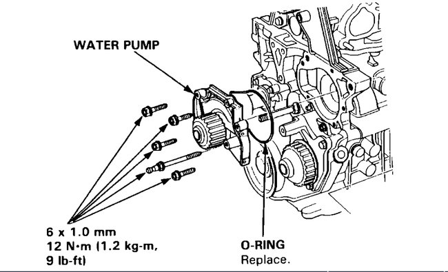

I used bars leaks for a blown head gasket and it fixed my HG. Then I replaced my lower radiator hose and the heater hose burst, fixed both. Put in new thermostat and gasket and revealed that there was no previous thermostat in the car. Still showing on temperature gauge overheating. Flushed my radiator with Gunk Cleaner Flush and it is still over heating it's gauge is reading overheating and ideas on what to do next? please help!
Oct 20, 2019 at 3:16 PM
SCGRANTURISMO
  • 4,897 POSTS

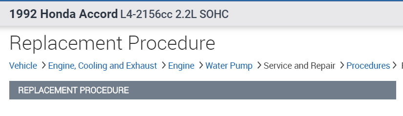

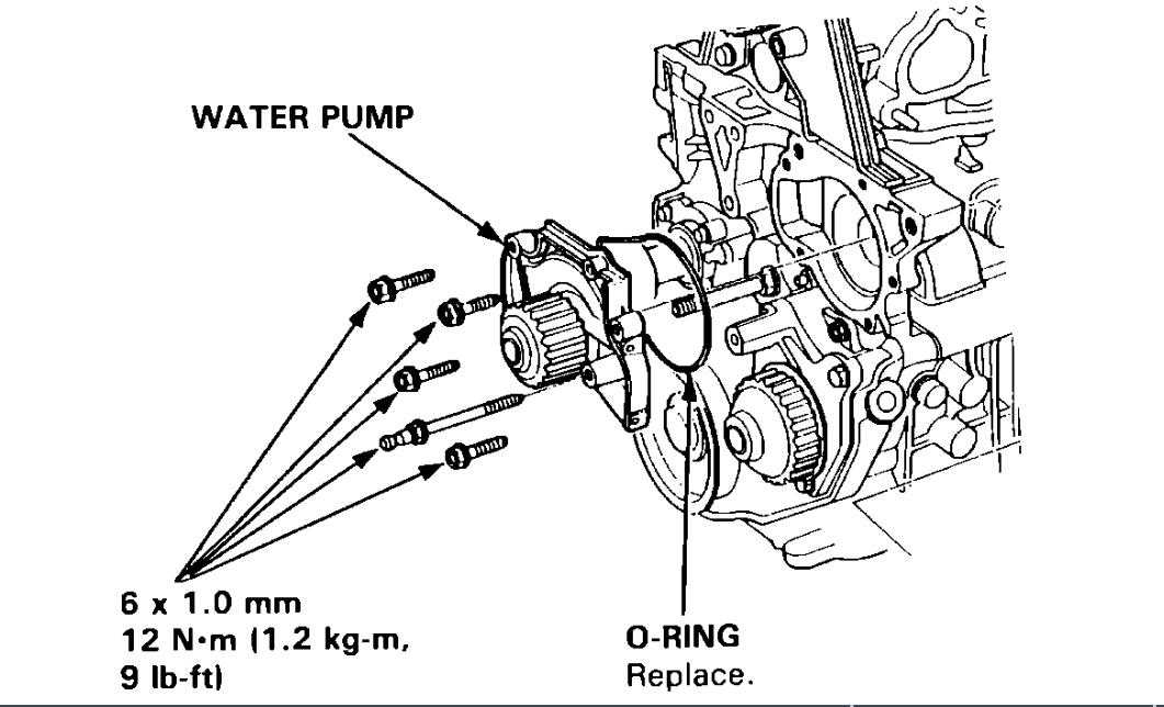

This sounds like your vehicle's water pump may have failed. In the diagrams down below I have included the factory instructions for the removal and installation of your vehicle's water pump. Please go through this guide and get back to us with what you are able to find out.
