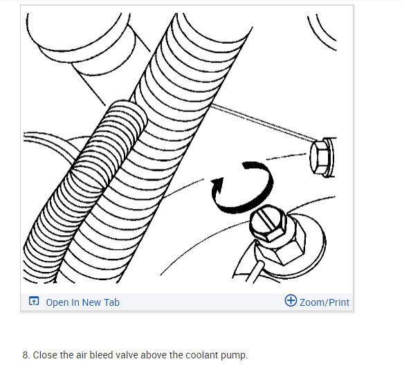

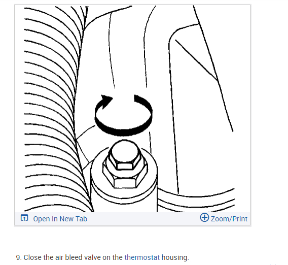

New radiator, new radiator cap, new thermostat, the OEM required a new water pump, heater core flush, radiator flush, and still overheating. I need help what is wrong with this car.

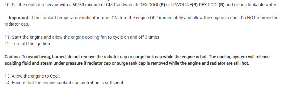

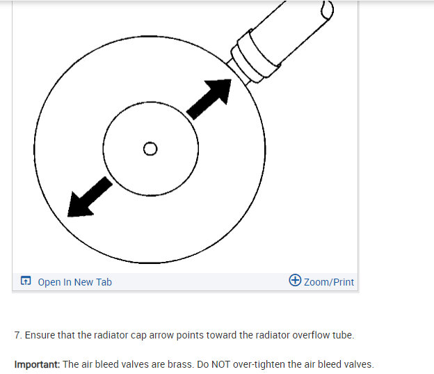

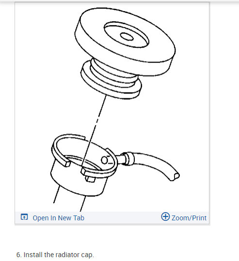

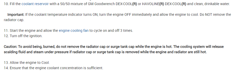

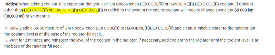

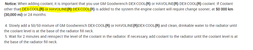

If the heater works on and off, there must be air in the system. That could be causing the issue. Are you aware there are two bleeders? Also, did you use the correct coolant and replace the radiator cap?
Take a look at the refill directions below. Note: The directions start on number 4 because steps 1-3 explain how to replace the reservoir. You won't be doing that.
Take a look and let me know if this is what was done. Also, please let me know if you mixed a different coolant with the OEM dexcool.
