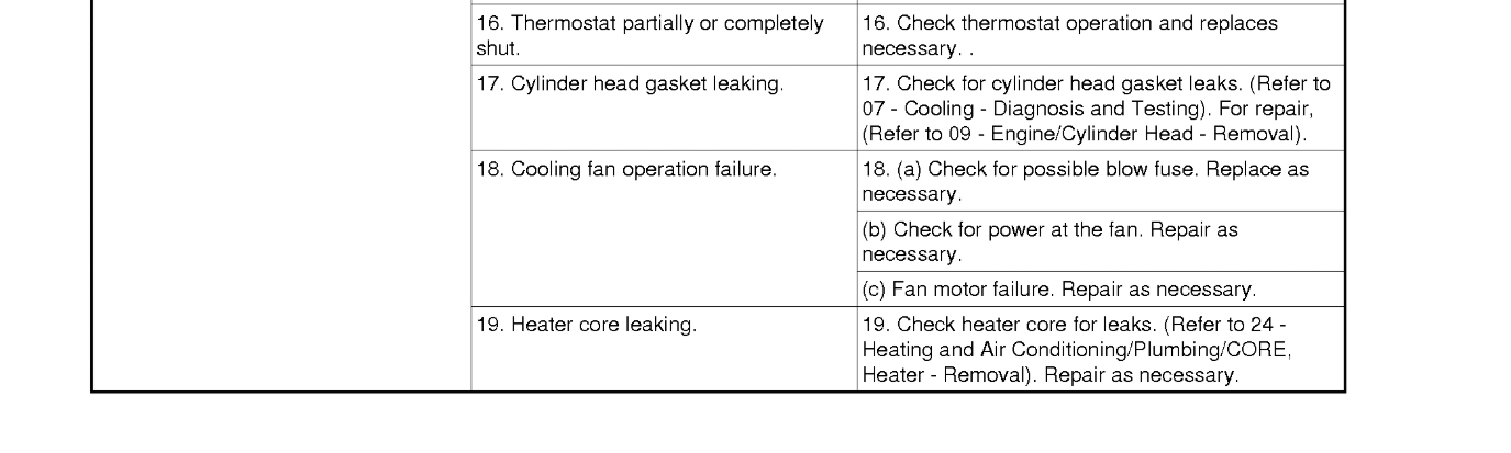

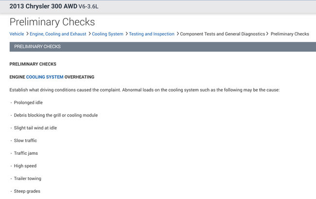

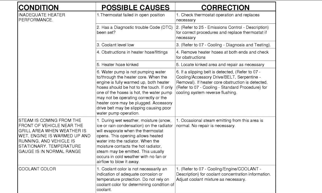

I have been to several shops with no help. My car is still overheating. Passed block test and coolant pressure test. Cap replaced twice. Radiator replaced. Thermostat replaced 4 times. No signs of heater core being bad. No visible leaks. Please help.
Dec 10, 2019 at 10:40 PM
SCGRANTURISMO
  • 4,897 POSTS

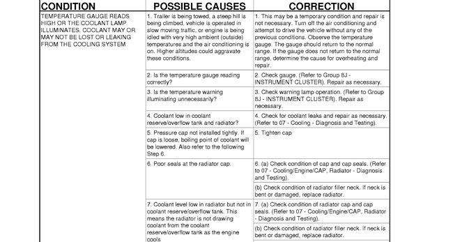

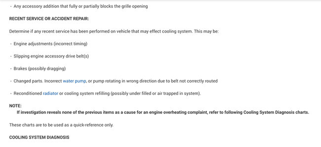

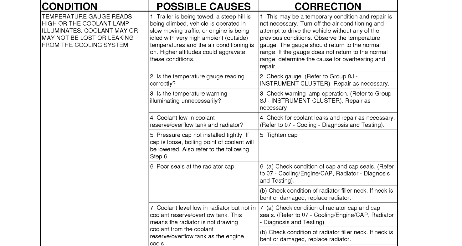

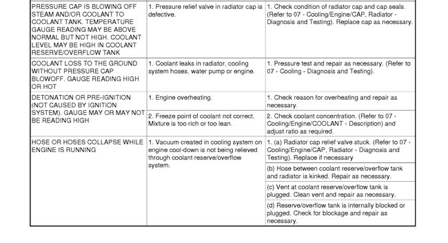

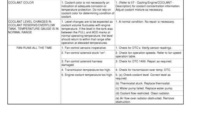

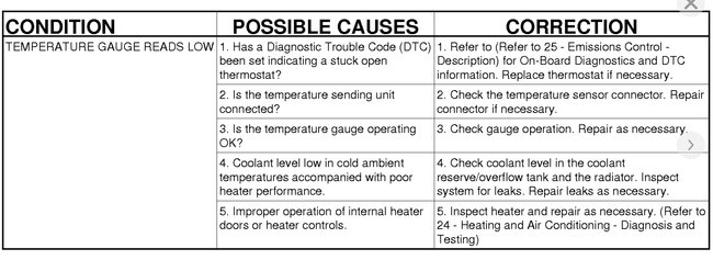

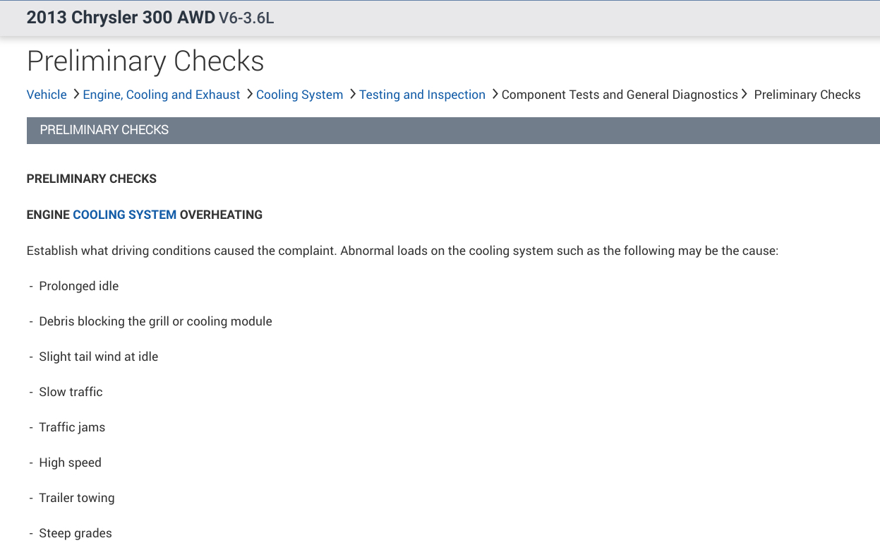

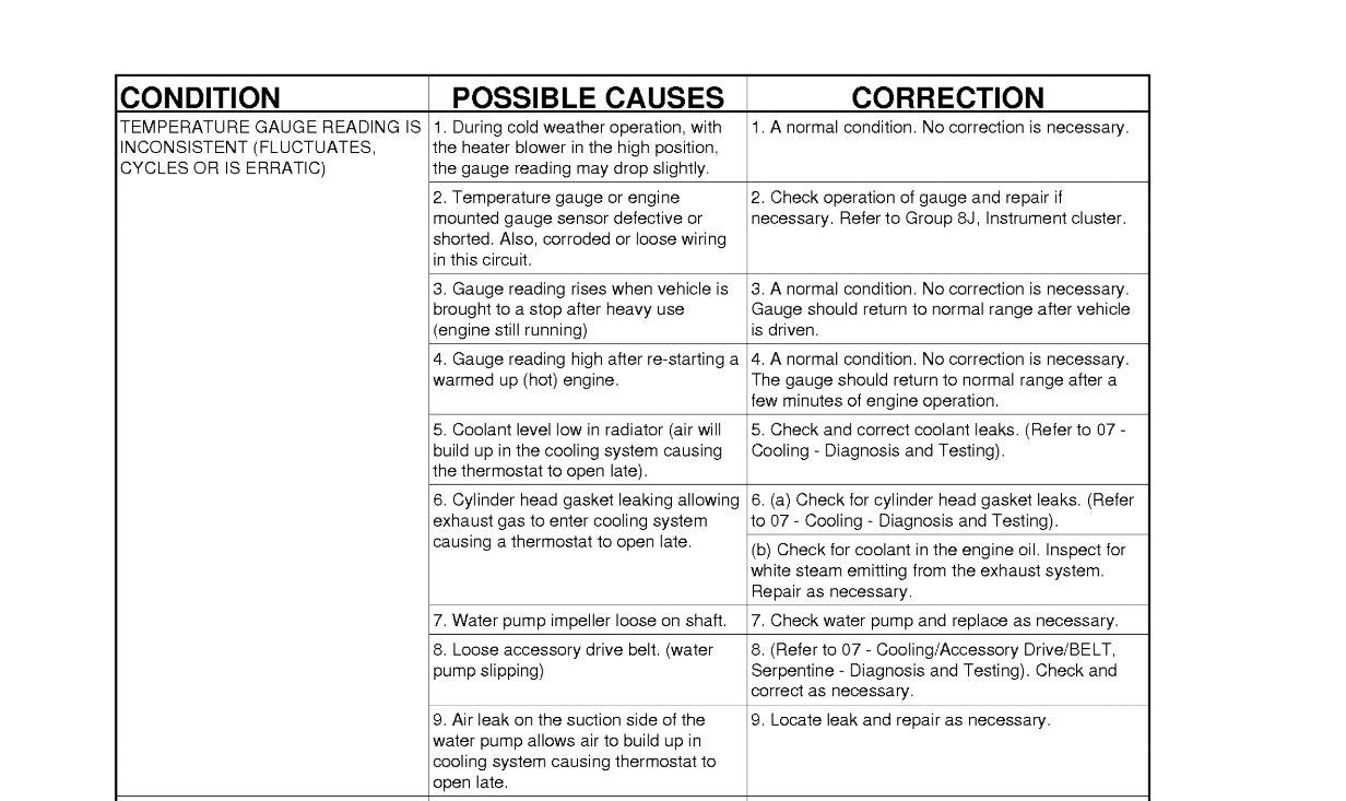

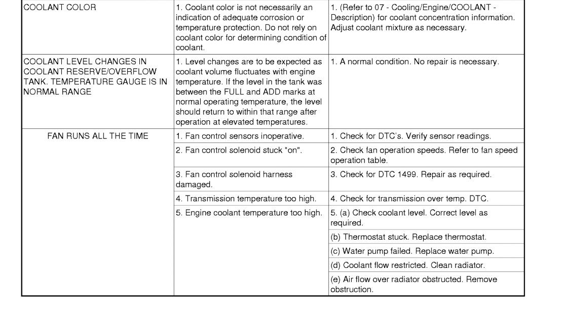

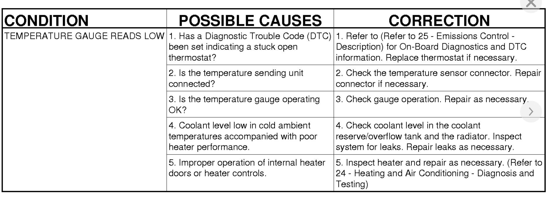

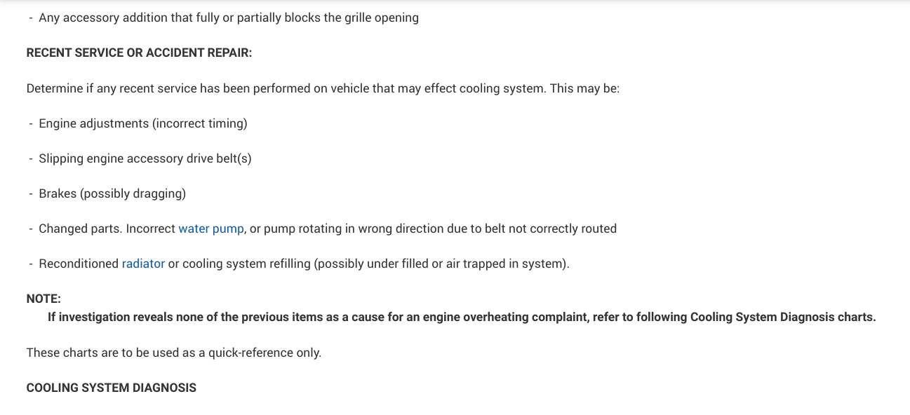

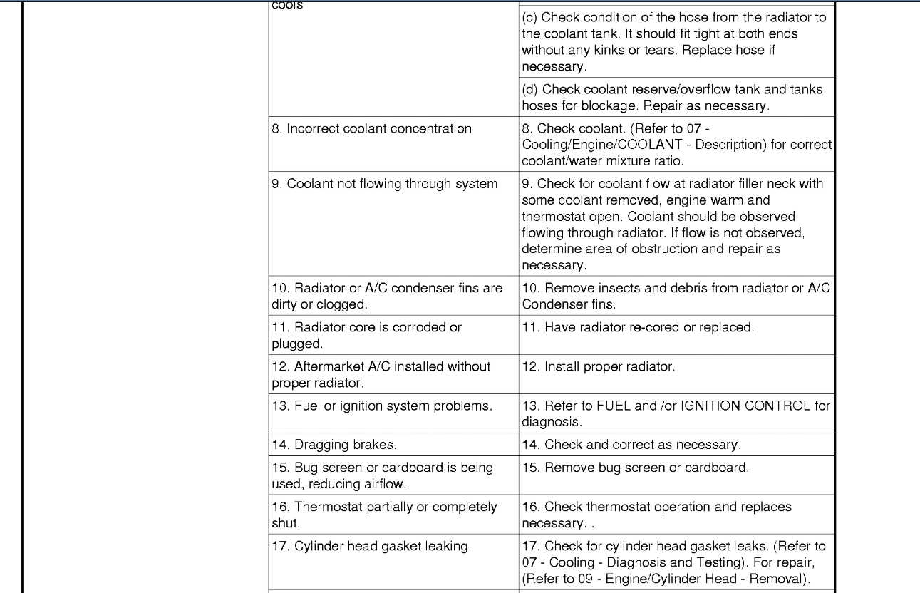

This could be a problem with your vehicle's water pump failing. Before we condemn the water pump, though, I have included in the diagrams down below I have included the factory diagnostic flowchart for your vehicle cooling system. Please go through this guide and get back to us with what you find out. We can go from there.
Thanks,
Alex
