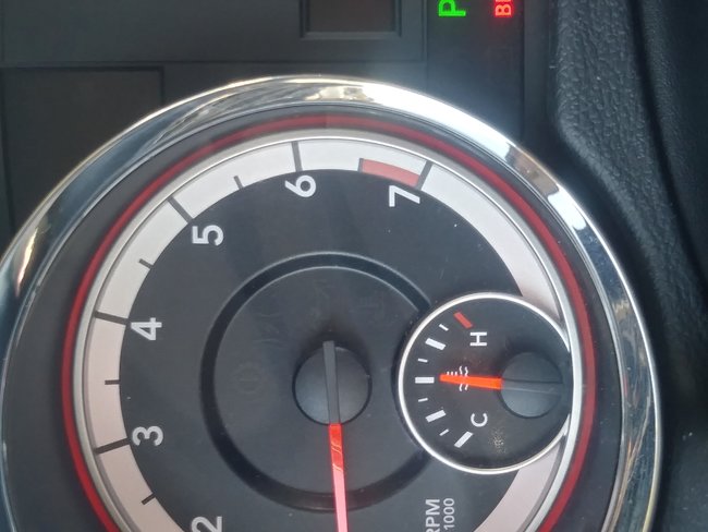

I bought the car used so not really sure what was done. However, it seems to want to overheat. It has not gone to the red lines but it moves a lot pass have especially when I have AC on. A mechanic says he does not see a problem. What else can I do? And is it normal for my gauge to move a little is it suppose to stay still?

That is above normal.
It should be below the center line.
I would suggest changing the thermostat first.
Other possibilities:
1. Thermostat
2. Cooling fan not working
3. Radiator clogged
4. Leaking head gasket
5. Low in coolant
6. Bad radiator cap.
