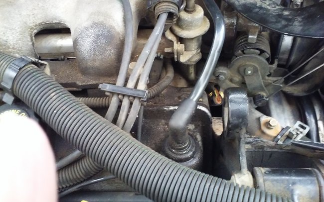

I got it out drove 7 miles, began to overheat. took back to shop they said fan only comes on low, not high. they said wiring problem, need PCM, and they do not do that.

Thank you for providing information. I will try to explain what I have been told by shop. I just looked at cool fan 2 fuse. It is 30 amp and appears to be new. They told me they replaced a dirty fuse. I have been told only low fan is coming on. When I first picked up van after repairs... I drove around town fine for a few hours. Next day when I got on highway at 65 mph only got 5-6 miles, gauge went all the way to red zone. I pulled over, waited for engine to cool. Went 2-3 miles pulled over, repeated until made it back to shop. Next thing I was told they were replacing heat sensor. I have attached picture of new sensor they told me goes to gauge in dash.

Neighbor suggested to start vehicle, let run until warms up, to see if bubbles in coolant overflow tank because of possible bad head gasket. Overflow was empty. I added 3/4 gallon antifreeze. Started motor. It took about 30 minutes to heat up. As soon as gauge reached between 1/2 and 3/4, both fans kicked on, and gauge went down to 1/2. Did not see any bubbles in overflow while motor running. Neighbor suggests Bars Leaks Block Seal Intake and Radiator Stop Lock because of possible intake manifold gasket.
