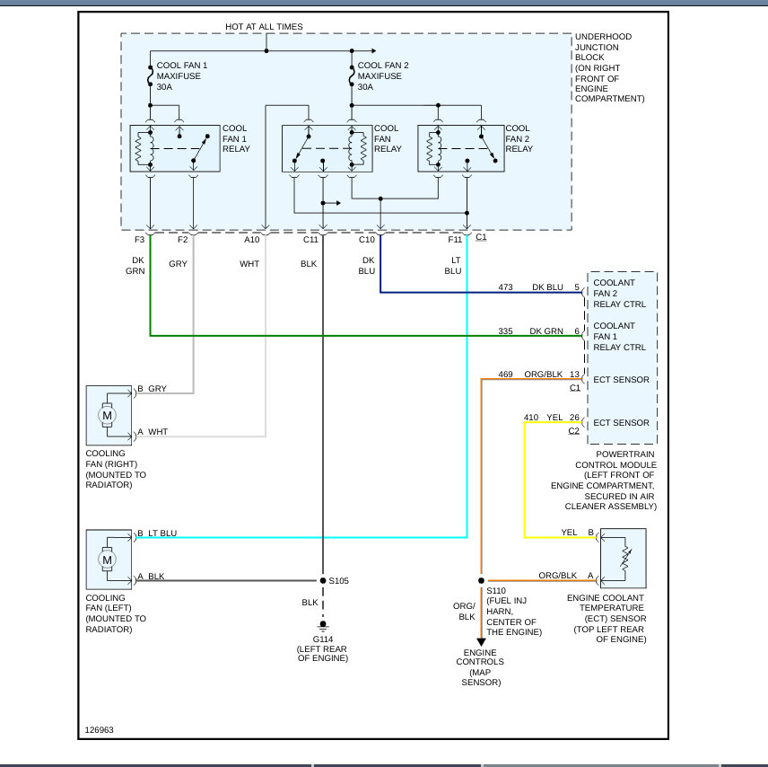

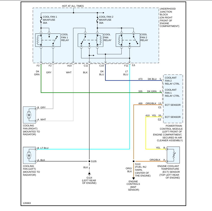

I got it out drove 7 miles, began to overheat. took back to shop they said fan only comes on low, not high. they said wiring problem, need PCM, and they do not do that.
Dec 9, 2019 at 12:51 PM
SCGRANTURISMO
  • 4,897 POSTS

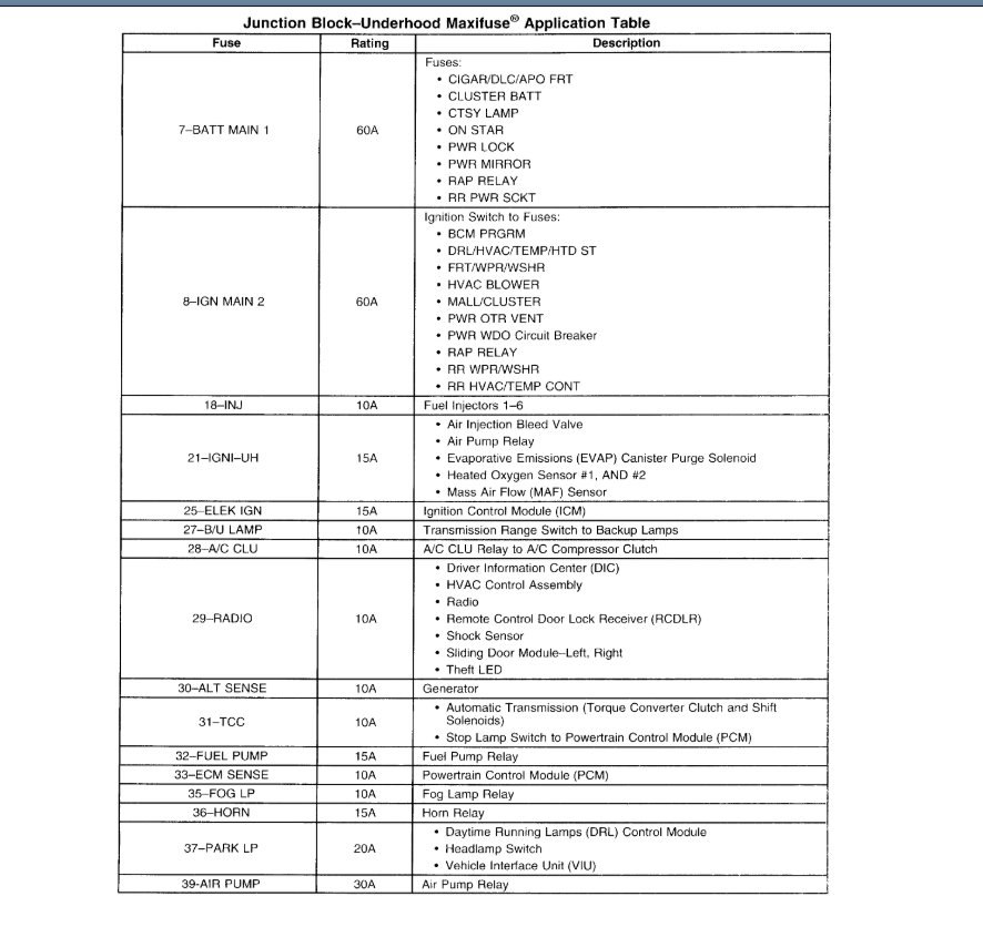

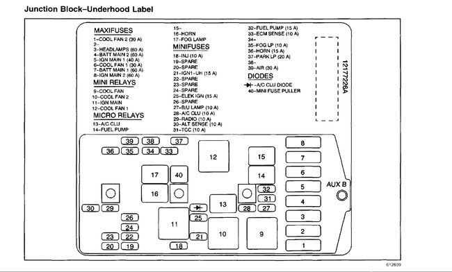

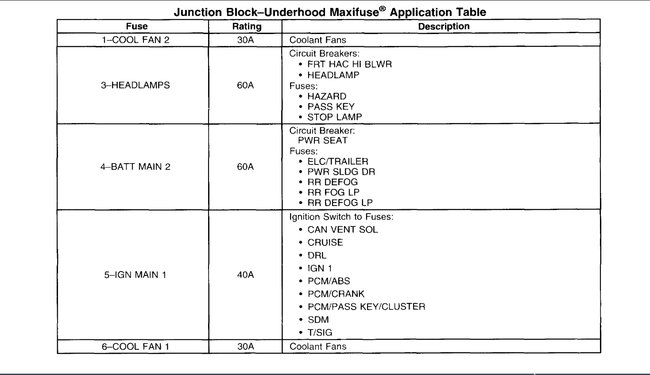

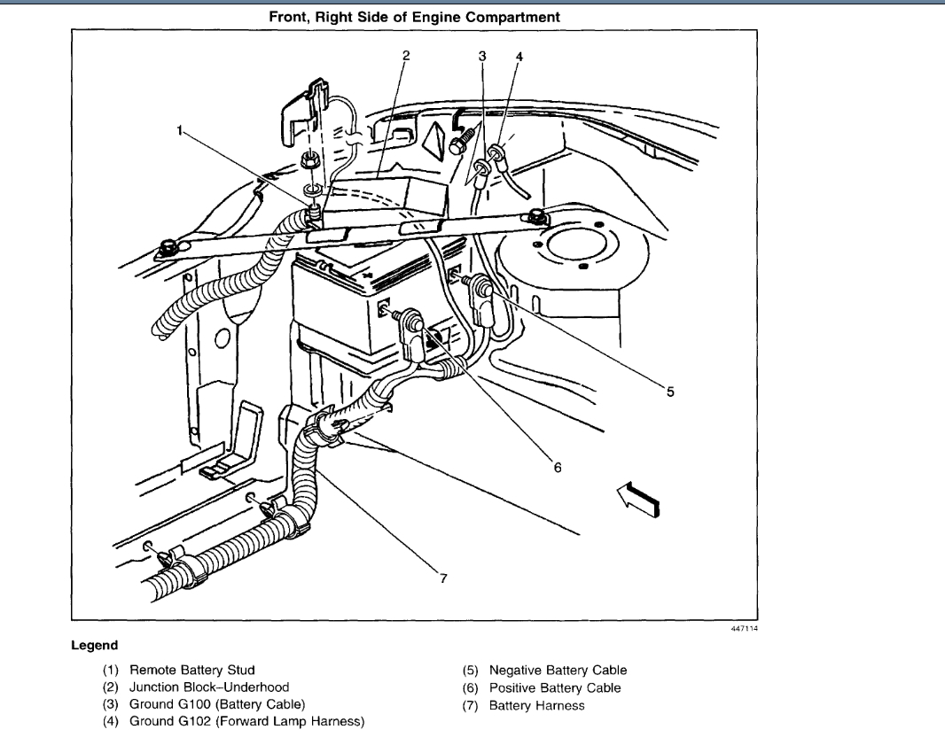

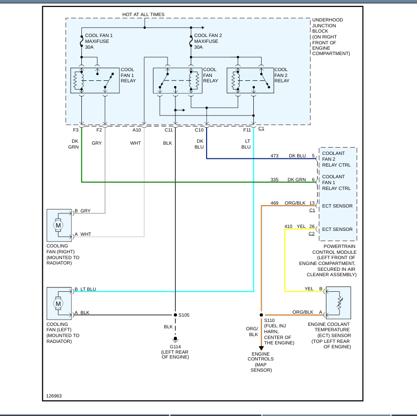

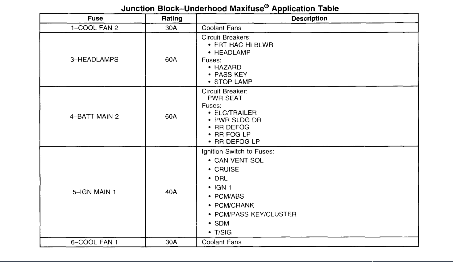

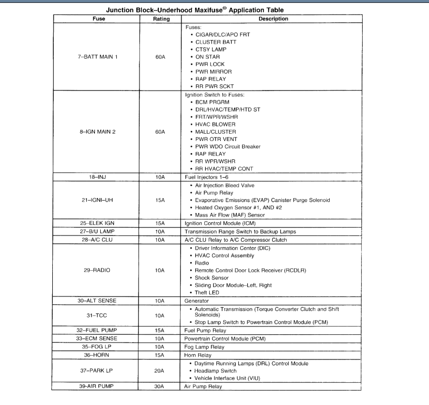

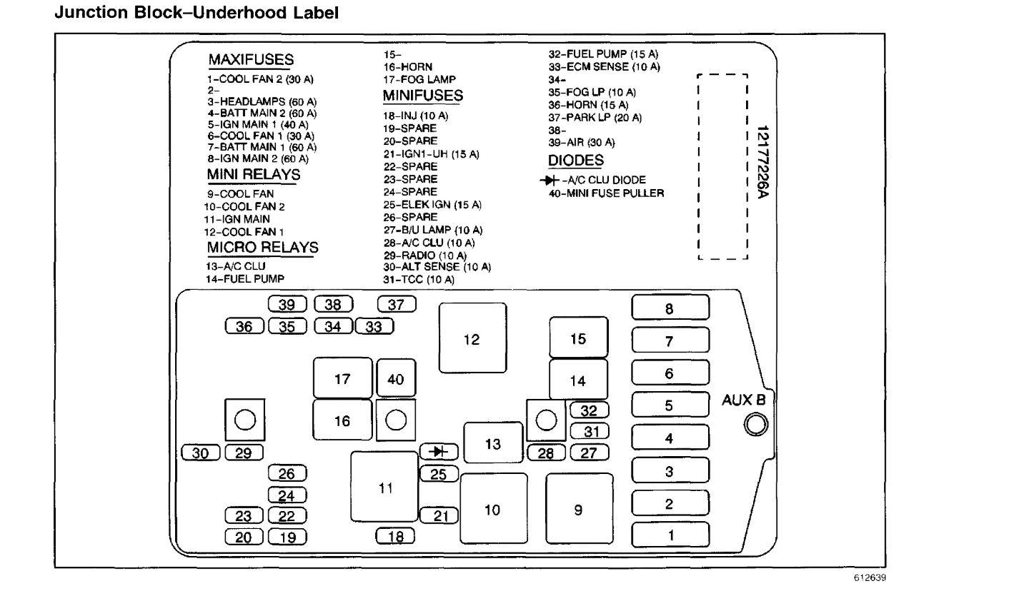

Okay, so let's work through this circuit together. First off in the diagrams down below I have included a wiring diagram of your vehicle's cooling fan circuit for your reference. I have also included the diagram with call out for your vehicle's Under hood Fuse Box. Can you please check the Cooling Fan 2 fuse in the Under hood Fuse Box for us. Here is a link down below explaining how to check a fuse, if needed:
Please get back to us with what you find out and we can go from there.

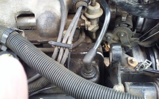

Thank you for providing information. I will try to explain what I have been told by shop. I just looked at cool fan 2 fuse. It is 30 amp and appears to be new. They told me they replaced a dirty fuse. I have been told only low fan is coming on. When I first picked up van after repairs... I drove around town fine for a few hours. Next day when I got on highway at 65 mph only got 5-6 miles, gauge went all the way to red zone. I pulled over, waited for engine to cool. Went 2-3 miles pulled over, repeated until made it back to shop. Next thing I was told they were replacing heat sensor. I have attached picture of new sensor they told me goes to gauge in dash.

I don't feel good about the doing the gasket test myself. Is there a test I can do to check why the fans are only on low speed and not high speed?
Dec 11, 2019 at 7:24 AM
SCGRANTURISMO
  • 4,897 POSTS
Hello again,

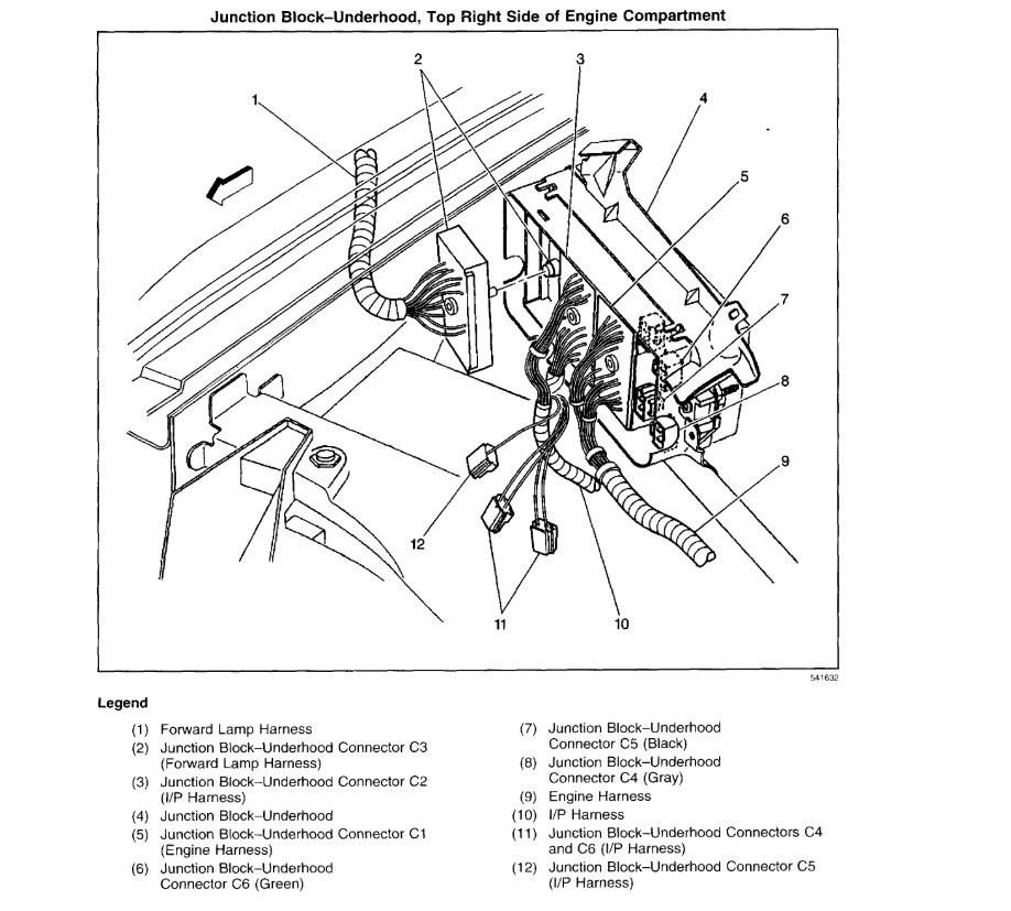

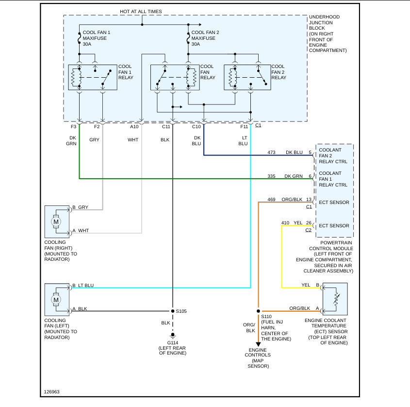

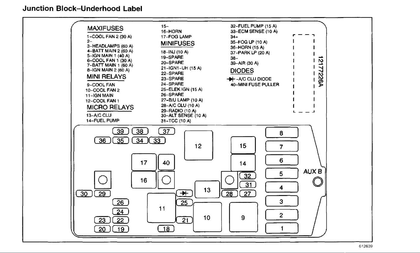

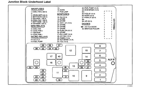

Sure, we can run down that problem. You will need to use a Digital Multi-meter [DMM] to run down the problem, so, here is a link to a guide explaining how to use one, if needed, below:

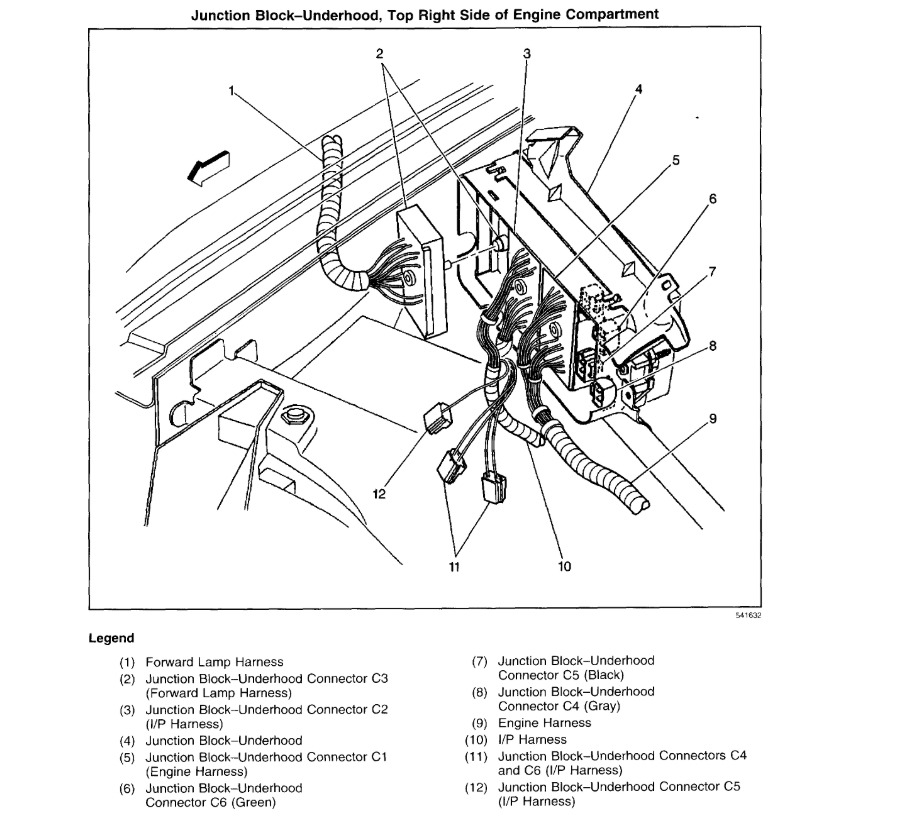

In the diagrams down below I have included the wiring diagram for your vehicle's radiator cooling fans circuit, and the location and layout diagram with call out for the Under hood Junction Block for your vehicle. Please check the Cool Fan 2 relay in the Under hood Junction Block for us. Here is a link below explaining how to test relays, if needed:
