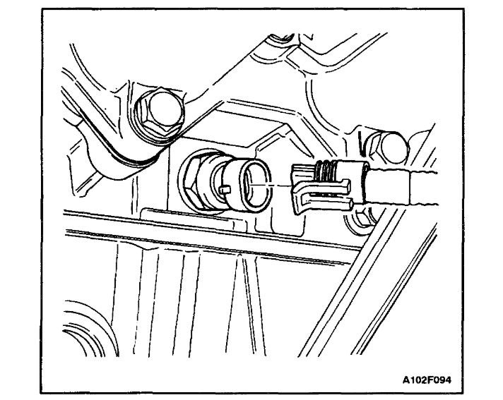

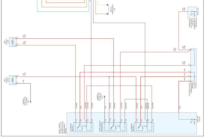

Fans come on at boiling point if i unplug fan switch on cylinder head fans come on heat gauge stands on below normal.
Nov 6, 2019 at 6:38 PM
Good morning,
By removing the plug, it sends a hot signal to the ECM and the ECM commands the fans to come on.
https://www.2carpros.com/articles/engine-overheating-or-running-hot
Sounds like the switch that you disconnected may be the issue or the thermostat may be the issue.
