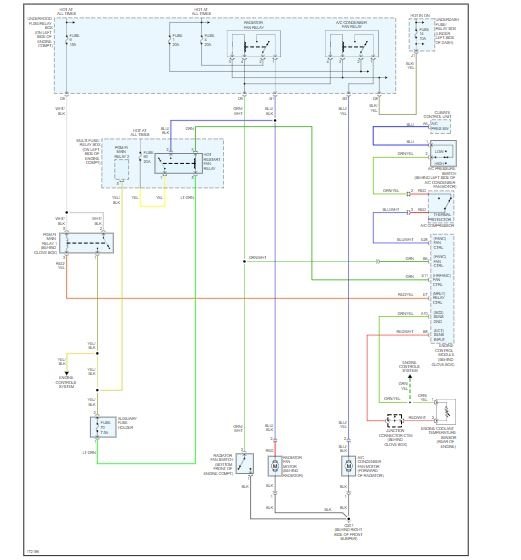

I changed the thermostat, the radiator cap and flushed the radiator . i don't hear fans come on. my heat comes out cool when it comes on. Sometimes it does not blow out.
Apr 24, 2020 at 9:59 PM
Good morning,
From your description, it sounds like the heater core may be clogged with debris. I would remove the heater hoses and use a garden hose to flush it of all debris. I would do it several times back and forth until you get a good even flow.
https://www.2carpros.com/articles/replace-heater-core
If that does not take care of it, the heater core will have to be replaced.

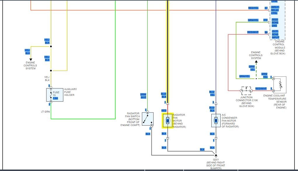

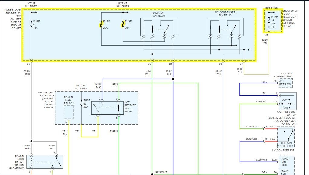

As far as the overheating itself, I attached a wiring diagram for the fans. Without the fans working especially at idle, the car will overheat as there will not be enough air flow through the radiator.
https://www.2carpros.com/articles/engine-overheating-or-running-hot
https://www.2carpros.com/articles/how-an-electric-cooling-fan-works
Do you have a voltmeter or test light to do some checks?
