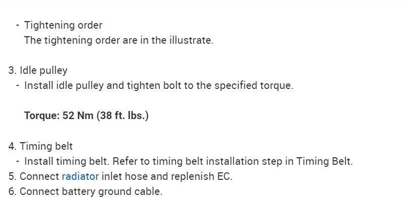

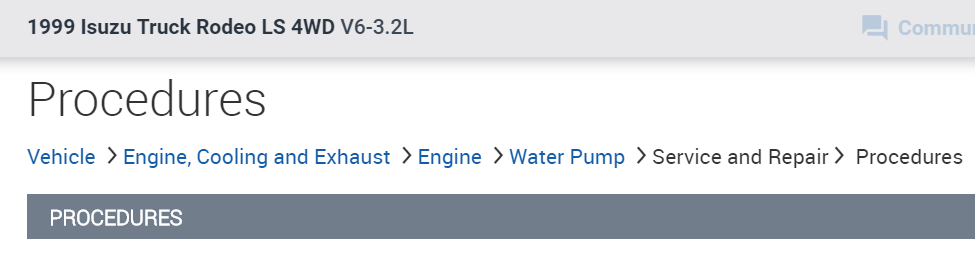

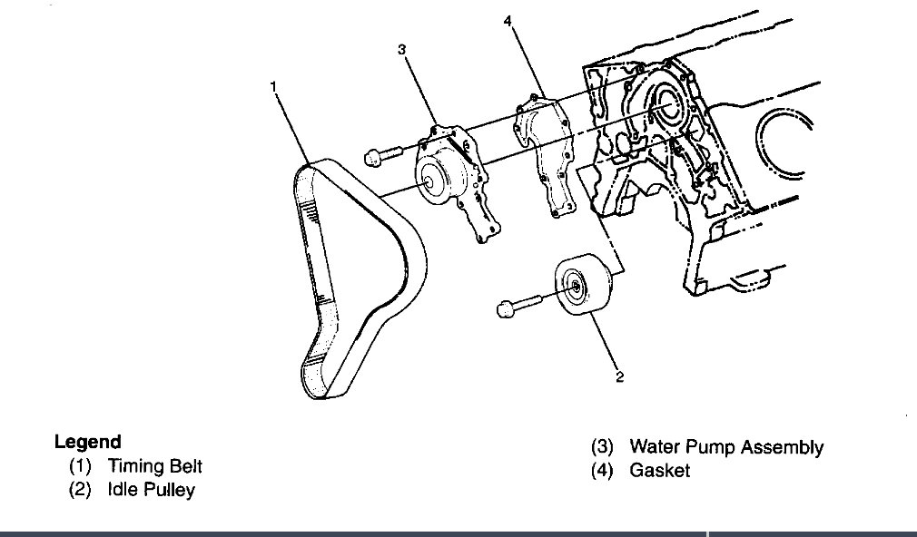

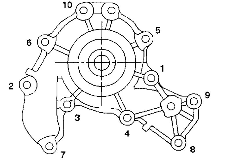

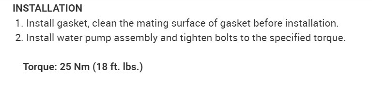

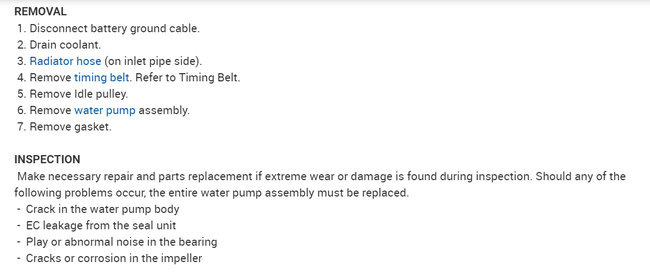

Hello again,

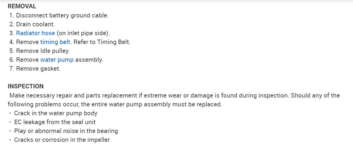

Yes, your vehicle's water pump is driven by the timing belt. It is still a fairly easy straight forward procedure to inspect, and if needed, replace it. I have included the step by step directions for this procedure in the diagrams down below. Please go through this guide and get back to us with what you are able to find out.
