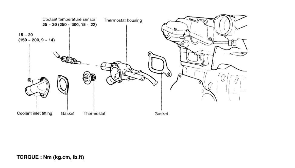

Can you please help me with overheating problem on my car? Last month did the same bursting pipes and we replaced the pipes together with the head gasket.
So now it does the same again, if the pipes became too tight with air inside and it will start to overheat, releasing water from the coolant system and having lot of pressure on pipes.
Please help

Did you replace the thermostat with the repair? If there is no circulation, it will build up a lot of pressure and cause this issue.
https://www.2carpros.com/articles/how-an-engine-thermostat-works
Also, the radiator may be the issue if it is clogged with debris.
https://www.2carpros.com/articles/how-to-replace-a-car-radiator
