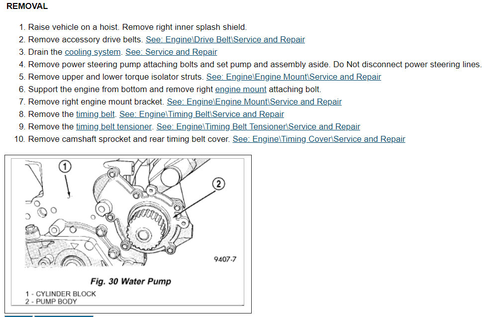

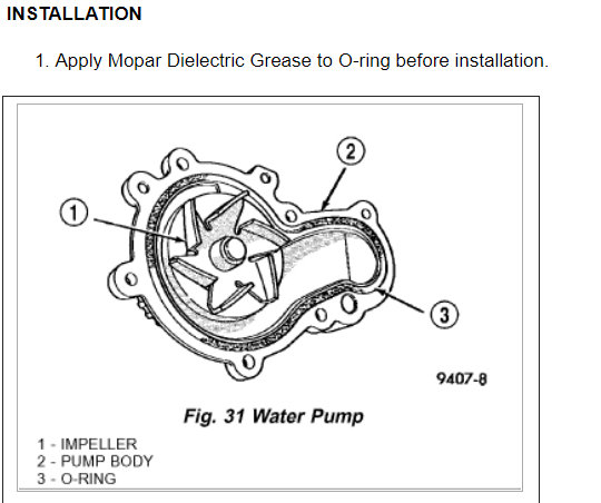

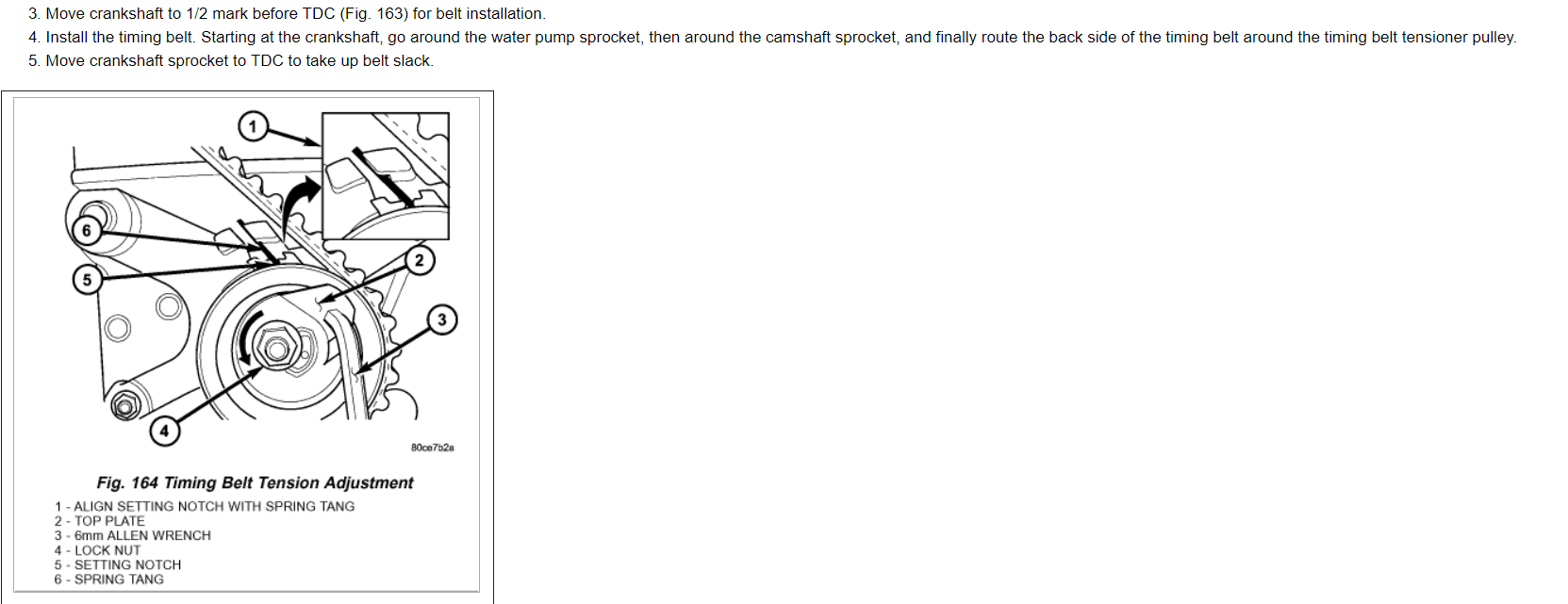

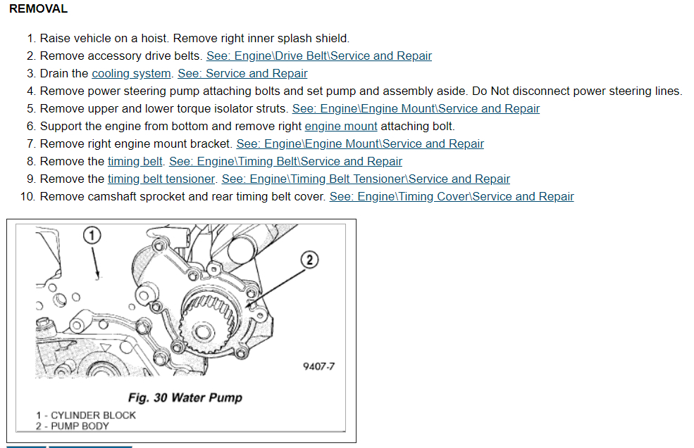

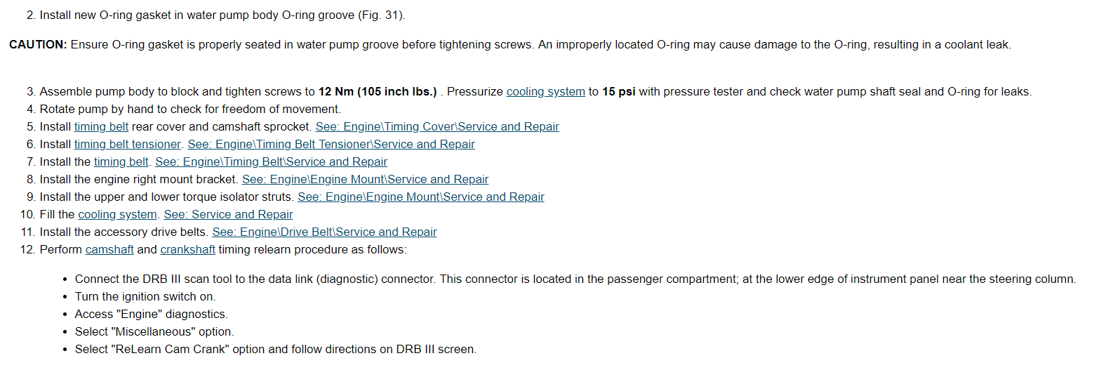

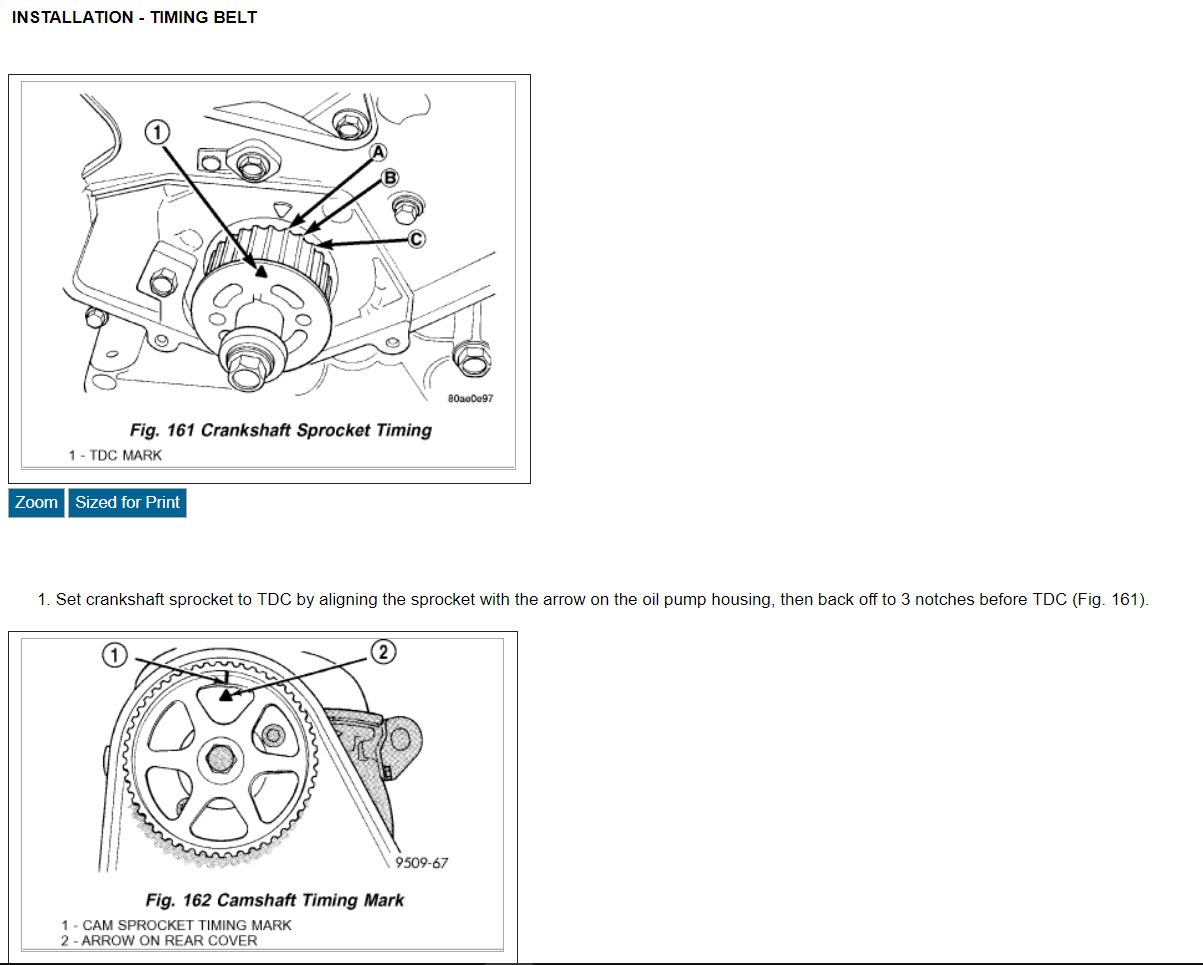

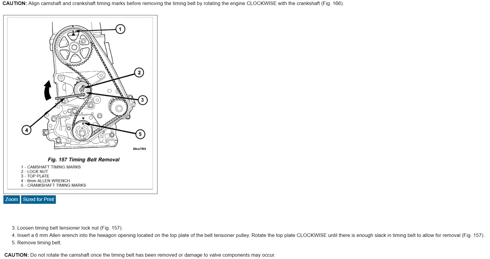

It sounds like one of two things are happening; either you have a blown head gasket which makes it overheat and you are just not seeing the coolant move, which can be tough or the water pump impeller has fallen off. Here is a guide to help you test the head gasket:

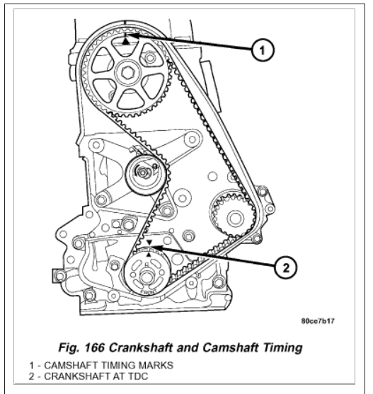

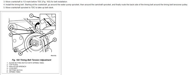

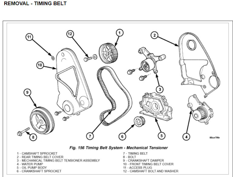

If okay here is what you are in for when doing the water pump and timing belt which you should replace when doing the job.
https://www.2carpros.com/articles/water-pump-replacement
Here is how it will be for your car (below).
