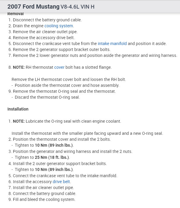

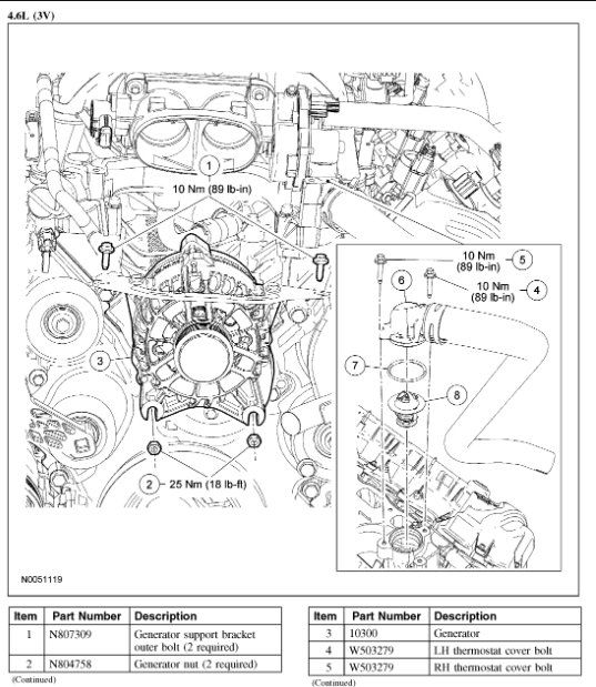

Here is a tutorial showing what's involved changing a thermostat:
I've also attached instructions and picture below.hope you're okay weather wise as I'm in CA and been dealing with a lot of rain for months.Thanks again for using 2CarPros and let me know if you have any questions.Keep me updated.
