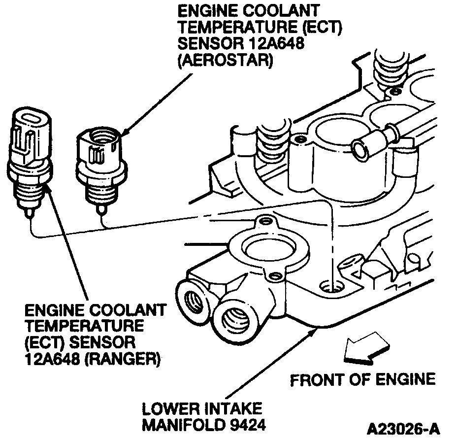

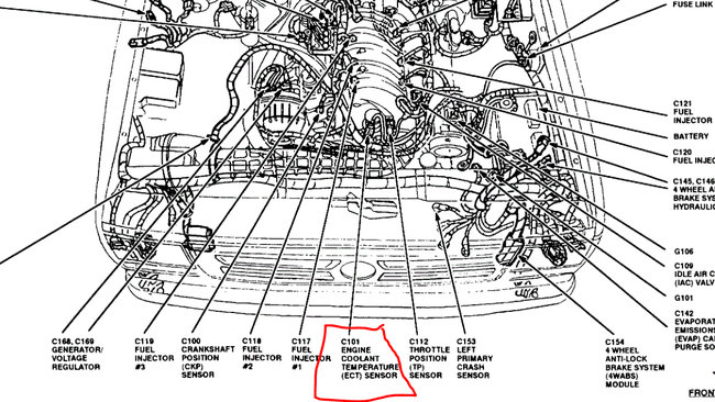

My girlfriends truck is overheating and I can’t find the root of the problem. I have changed the thermostat and flushed the radiator and put all new coolant in. Her father had a brand new water pump put on it and “he says” they flushed the heater core before I could get my hands on it. The temperature fluctuates up and down very quickly. But there is no smoke and the oil isn’t milky and no fouled plugs so I have ruled out the head gasket. Faulty thermostat from AutoZone or air pockets stuck in the cooling system were the last thing I could think of. But I purchased the best/most costly thermostat from AutoZone and used proper coolant and it shows no evidence of a leak because I don’t see coolant on my driveway or any area I park for extended period of time and my coolant levels aren’t dropping enough to have a leak. Could a whole engine flush help? Use synthetic when filling the oil back up? The truck is very high mileage tho, only 129,000. Any help or direction would be much appreciated, thank you.

Has anyone checked the coolant temperature sensor itself? It may have a bad connection or be faulty. Also, try this. When the engine is cold, remove the radiator cap and start the engine. Does coolant shoot out? Are there any air bubbles in the coolant when it is running?

If you look at pic 1, it shows the location of the engine coolant temp sensor (ECT).
Here are directions for replacement:

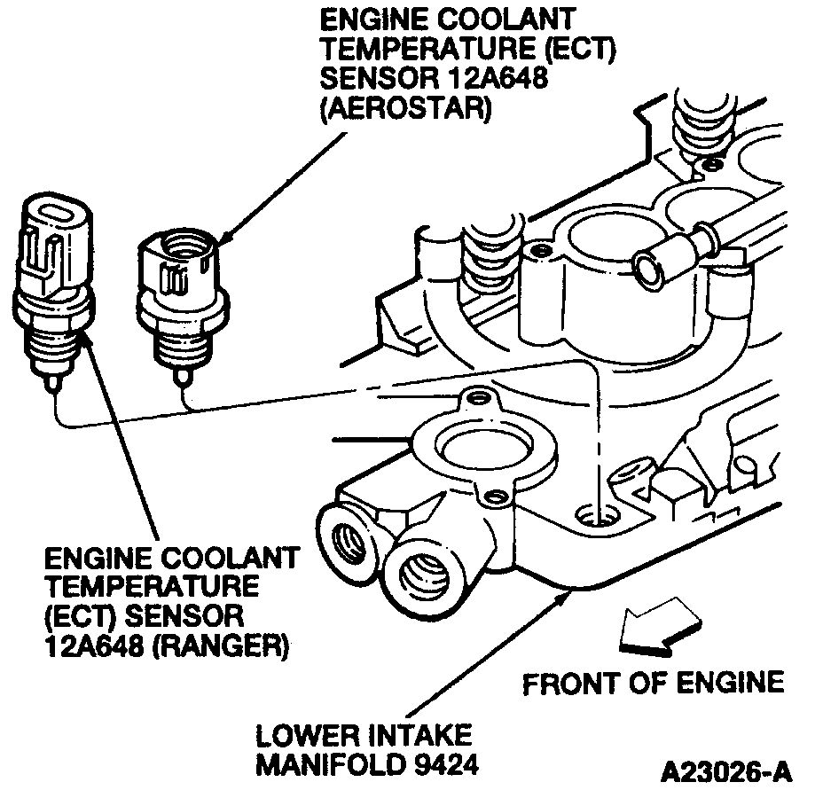

1997 Ford Truck Ranger 2WD V6-3.0L VIN U
Coolant Temperature Sensor
Vehicle Powertrain Management Sensors and Switches - Powertrain Management Sensors and Switches - Computers and Control Systems Coolant Temperature Sensor/Switch (For Computer) Service and Repair Procedures Coolant Temperature Sensor
COOLANT TEMPERATURE SENSOR
Engine Coolant Temperature Sensor
See pic 2
REMOVAL
1. Disconnect battery ground cable.
NOTE: When battery voltage is removed from the Powertrain Control Module (PCM), all learned values will be cleared and reset to predetermined values. When battery voltage is restored to the PCM, the vehicle may exhibit certain driveability concerns. It will be necessary to drive the vehicle to allow the PCM to relearn values for optimum driveability and performance.
2. Partially drain cooling system.
3. Disconnect Engine Coolant Temperature (ECT) sensor electrical connector.
4. Remove ECT sensor from lower intake manifold.
INSTALLATION
1. To install, reverse the removal procedure.
2. Tighten the ECT sensor to 16-24 Nm (12-17 lb ft).
3. Refill cooling system.
