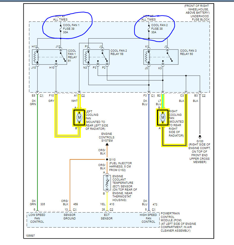

My vehicle overheats while sitting, had new engine.. after that replaced bad gaskets, new radiator, new sensor, new thermostat, new water pump, and bled air from coolant system, but still overheats.

Do the cooling fans work? Make sure they come on when the engine gets hot.
https://www.2carpros.com/articles/engine-overheating-or-running-hot
https://www.2carpros.com/articles/how-an-electric-cooling-fan-works
I attached a diagram for you of the system. Check for voltage to the fans when running and the engine is hot. Test the fuses in the diagram for power on both sides. When there is overheating at idle only, it is usually from lack of air through the radiator.
