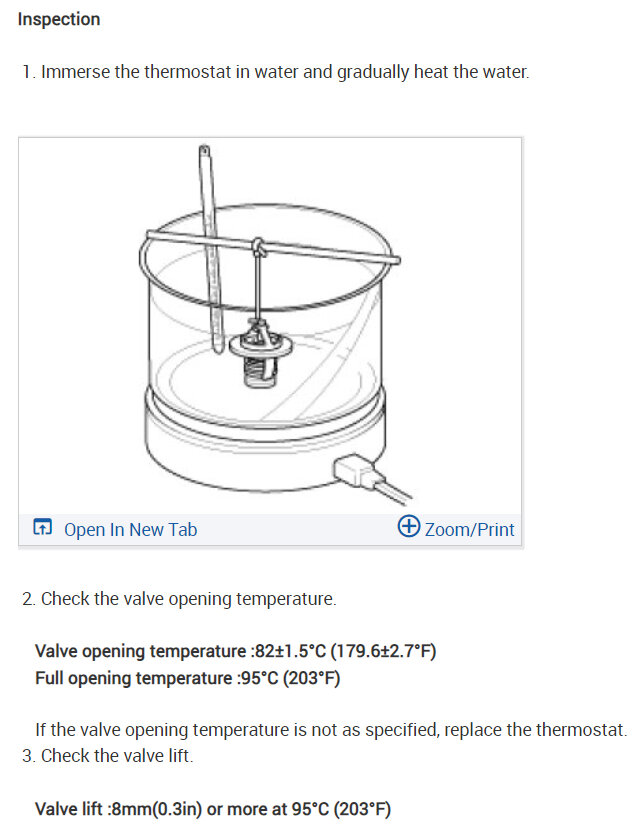

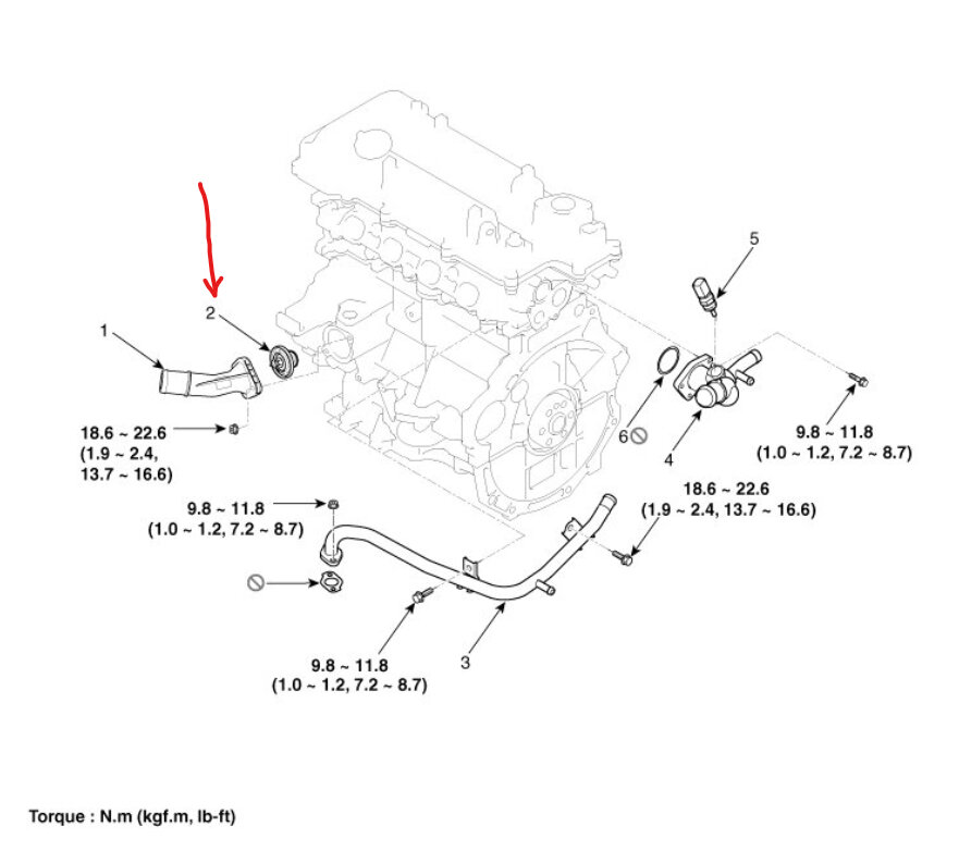

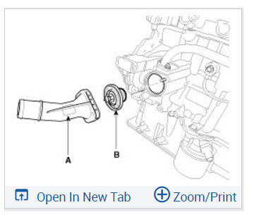

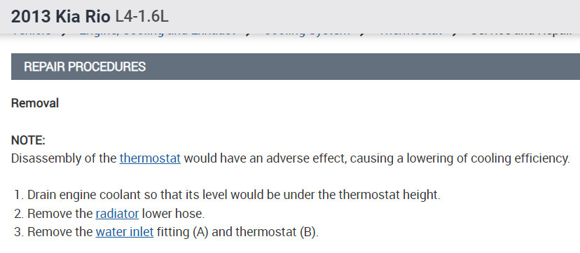

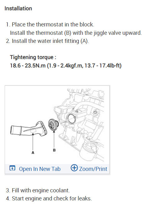

It sounds like the cooling system thermostat is stuck closed which happens, here are two guides to help us fix the problem with image below to help you repair your car:
https://www.2carpros.com/articles/engine-overheating-or-running-hot
Here is a generic guide to help you step by step with instructions in the diagrams below to show you how on your car:
Also, when the car is overheating can you hear the cooling fans running? Check out the images (below). Please let us know what happens.
