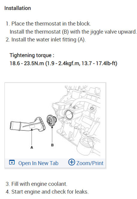

Hello. I've been experiencing overheating issues for a number of months. Flushed out radiator and changed the hoses and radiator cap. There is no leak, but it still overheats. I get a metal clanking sound only when it overheats however, I'm now getting a similar sound when I start the vehicle. It's there when the vehicle is idling and also when it's driving. Any ideas what the problem can be?
Jan 13, 2024 at 10:39 PM
  • 55,224 POSTS

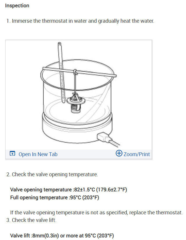

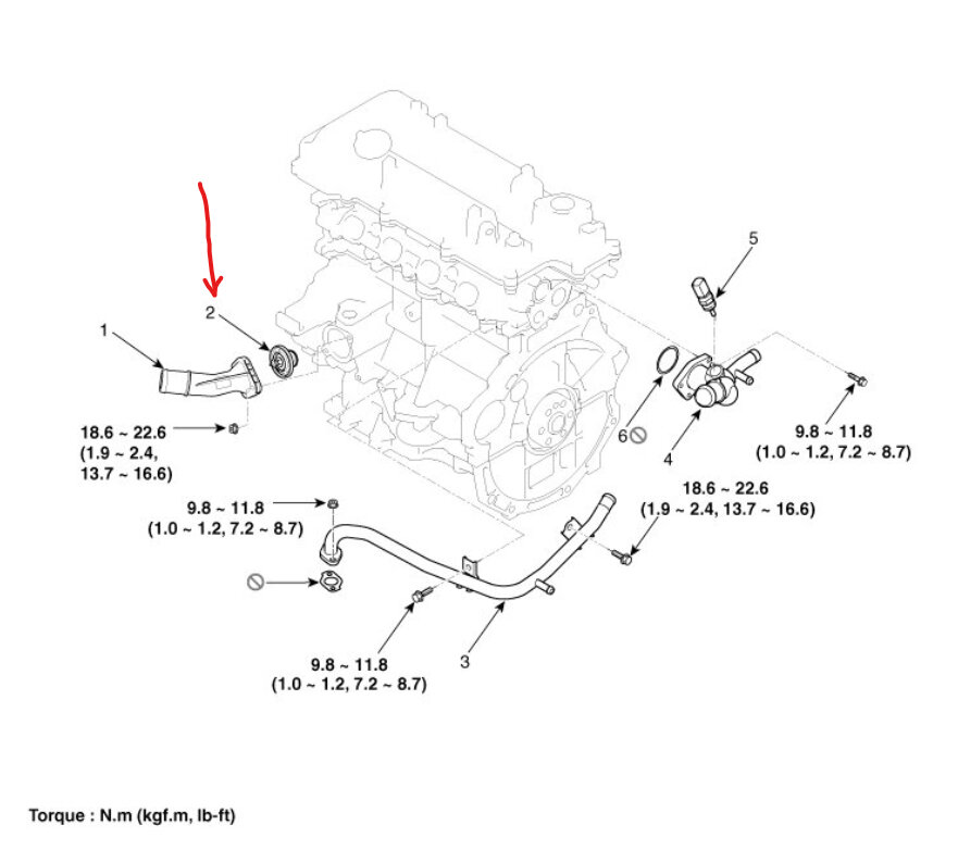

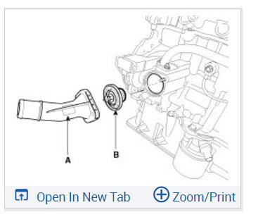

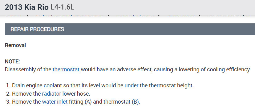

It sounds like the cooling system thermostat is stuck closed which happens, here are two guides to help us fix the problem with image below to help you repair your car:
https://www.2carpros.com/articles/engine-overheating-or-running-hot
Here is a generic guide to help you step by step with instructions in the diagrams below to show you how on your car:
Also, when the car is overheating can you hear the cooling fans running? Check out the images (below). Please let us know what happens.

Hello there. So, I had the thermostat checked and it is fully functional.
I've been reading other posts on this site, and it sounds like the head gasket might be failing or completely blown. I've been advised not to drive the vehicle as it is unsafe to do so.
I wish to thank you for your time in responding to my query.
Jan 16, 2024 at 1:31 AM
  • 55,224 POSTS
You are welcome, I have seen the thermostat start working again once removed so that can fool you sometimes. Here is a guide to check for a blown head gasket to confirm the failure:
