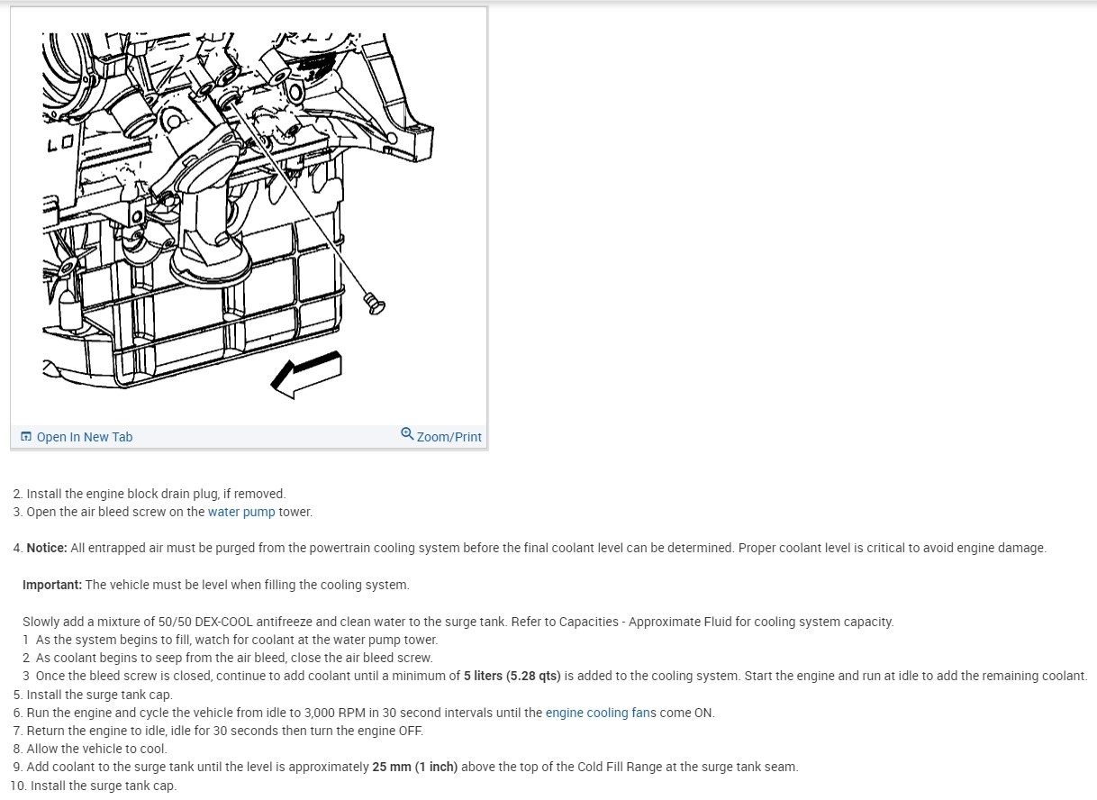

No signs of water in oil or oil in water, no smoke no smell. Changed radiator, water pump, thermo, sensor, reservoir cap and a small hose where heater core was bypassed. Flushed bled and yet air still gets in there. I open the bleeder valve and lots of air. Please help! No leaks either.
Apr 12, 2022 at 11:24 AM
WENDY W
  • 86 POSTS

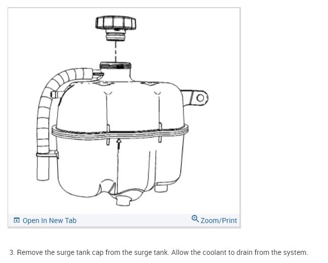

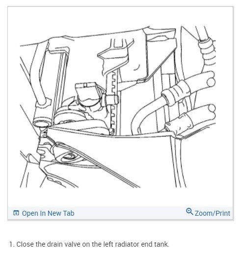

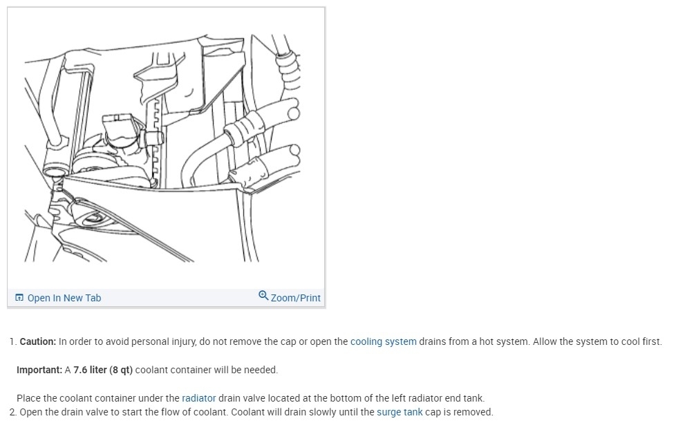

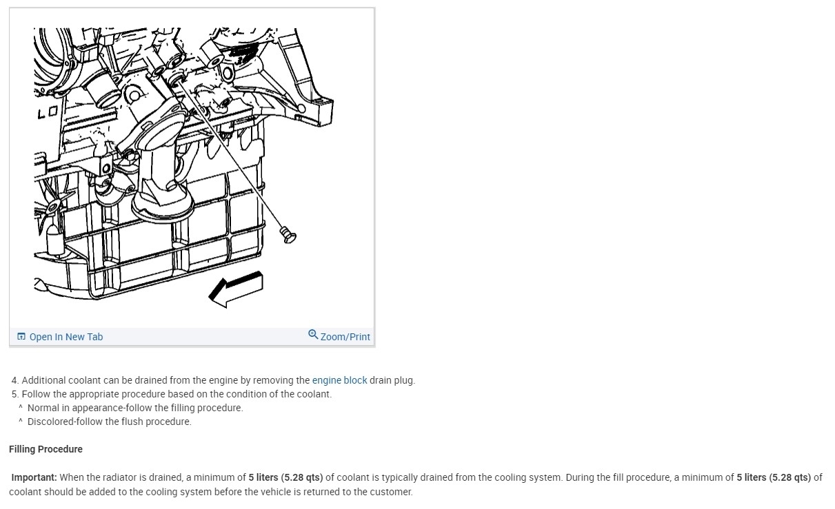

It's possible that air is just trapped in the coolant system from the last time the coolant was drained from the vehicle. I've attached the refill and air bleed procedure below.
This repair guide gives some helpful tips for the coolant flush and refill procedure:
