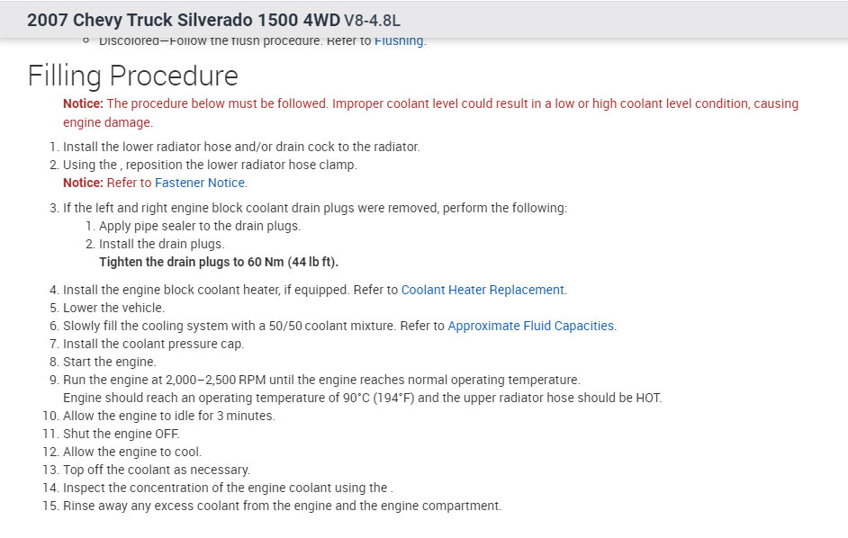

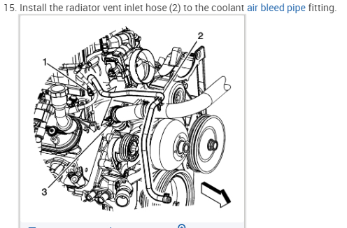

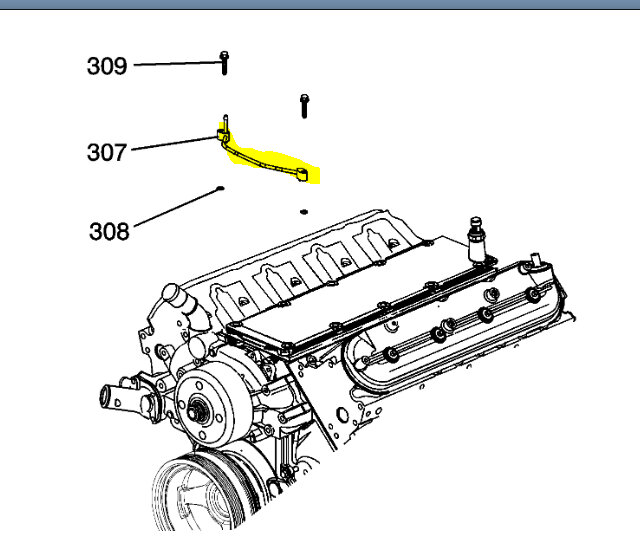

I attached what I have for refilling the coolant after draining everything. I do have a question. The vehicle came with DexCool coolant from the factory. By any chance, did you mix a different type of coolant with it? Also, if I recall, there is an air bleed pipe between the cylinder heads.
See pics below. The first pic shows the hose that runs from the radiator to the pipe. That is disconnected when coolant is added to allow air to exit.
Also, the last pic is what I have for the bleeding procedure. Let me know if it helps.
Nov 30, 2022 at 10:09 AM

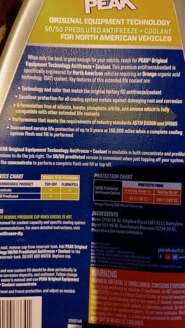

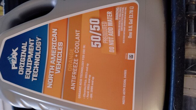

This is very helpful. I didn't drain or fill it correctly. It also makes sense. When i flushed the heater core a few months ago i didn't drain the system. I added the coolant that the auto parts store suggested which does not say Dex Cool on the bottle. So, i probably mixed 2 different kinds which is why it worked fine for a few months? He is a pic of the coolant i used. It the wrong kind?

Is there anywhere on the coolant bottle that indicates what it can be used in conjunction with?
I ask because if the wrong type is mixed, it can cause the DexCool to jell and cause things to plug up.
Dec 1, 2022 at 6:00 AM
TULPA
  • 53 POSTS
It says it is compatible with other extended life coolants but doesn't mention anything specific.
Dec 1, 2022 at 6:42 AM
  • 110,244 POSTS
If there is an 800 number on the bottle, contact them and ask if that is compatible with DexCool. If it isn't, chances are this is the problem.
Dec 1, 2022 at 1:10 PM

I called and they said it is Dex Cool it just doesn't say that on the bottle because the patent has expired. I'm going to flush it all out again today after work. I've noticed the new coolant is already looking dirty. I'm wondering if my radiator is clogged and or rusted inside.

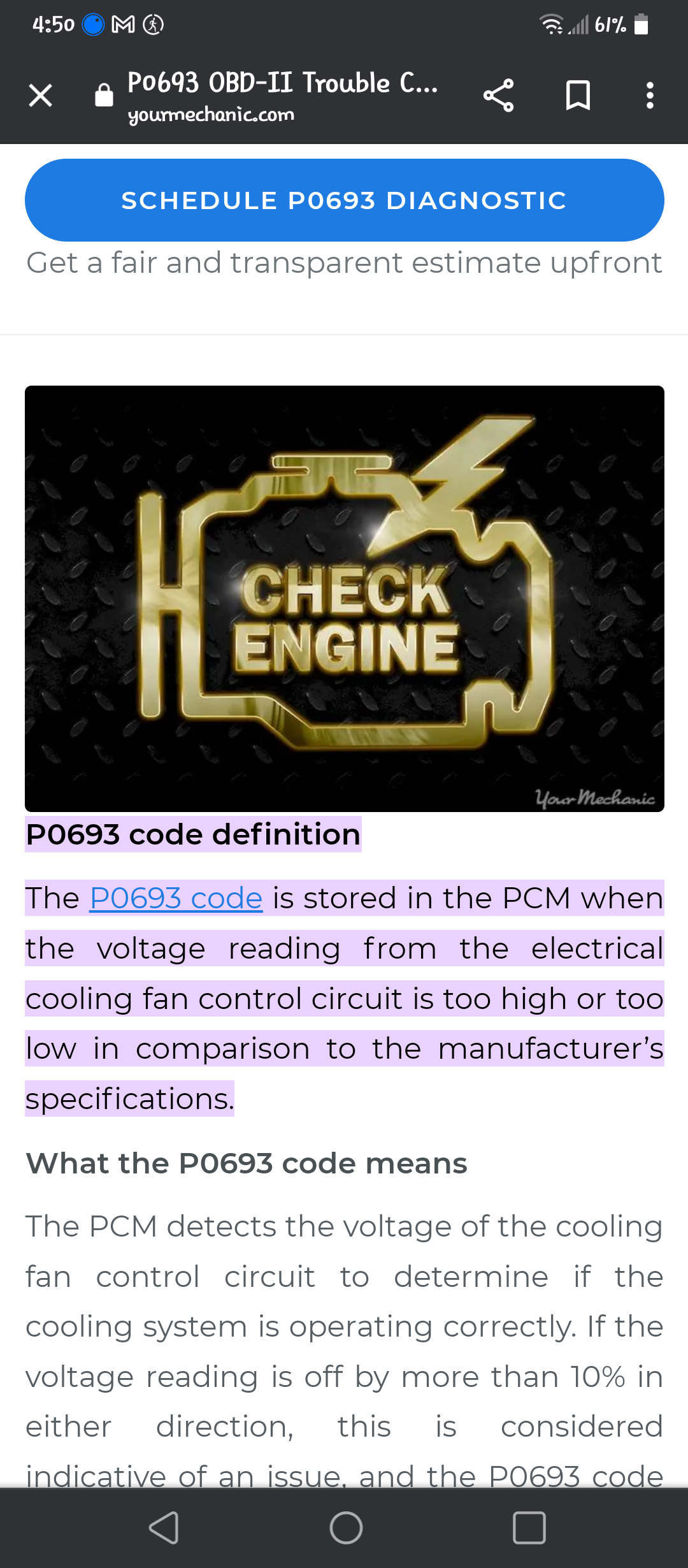

After driving for about an hour i turned the truck off and then turned the key (not enough to start it) and the temperature gauge kept going up until I started the truck, and it went back down...
I used my scanner, and this code came up
When i switch the heater to recalculate it goes cold. Switch it back and it's hot again.
Now only one of te heater core hoses is getting hot the other is room temp.
Dec 2, 2022 at 6:03 AM
  • 110,244 POSTS
Did the heater hose concerns start after draining and refilling the cooling system? Also, the code you have above is related to the cooling fan voltage. Do you hear the fan turn on?
The idea that the temperature gauge went up with the engine off is because the coolant circulation stopped. Once you restart it, the coolant begins to circulate again, and the temp will go down.
Let me know if the P0693 is still present. For some reason, it isn't listed for this vehicle in my manual.
Dec 2, 2022 at 2:04 PM
