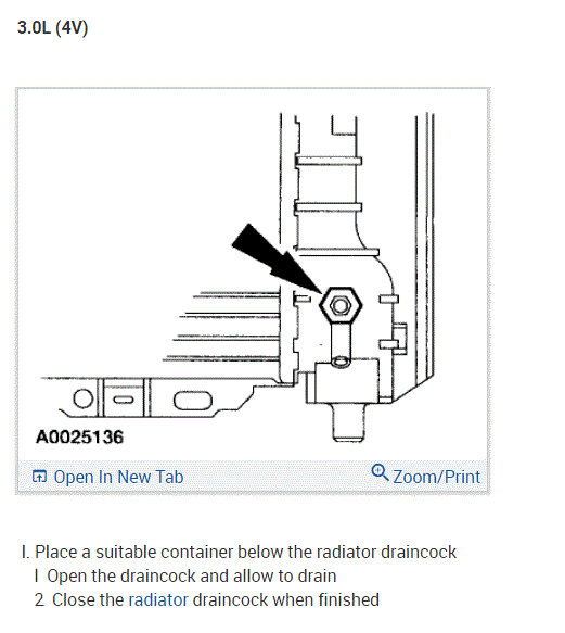

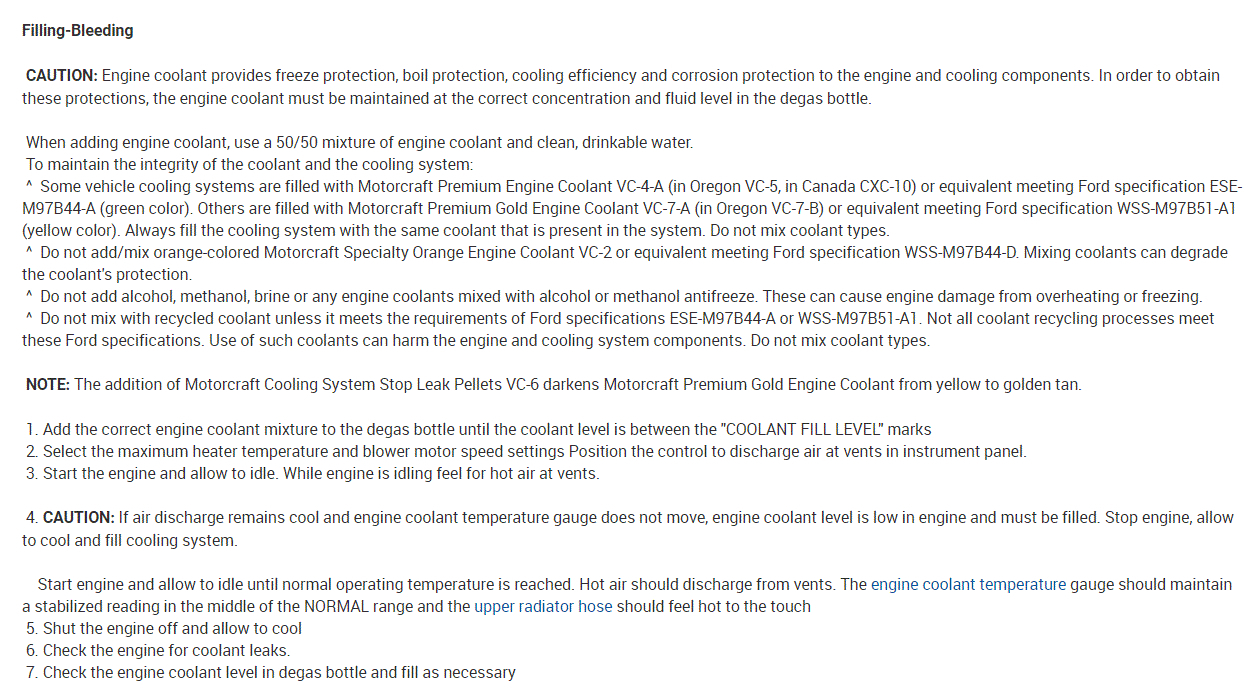

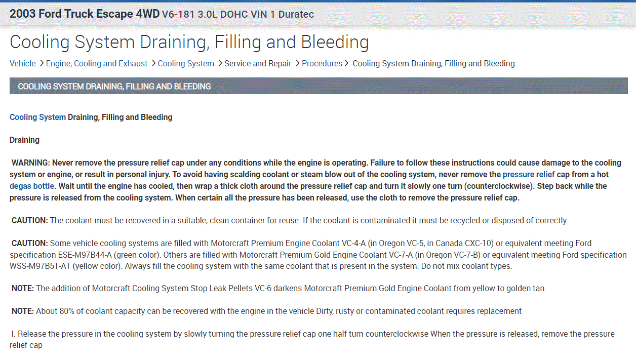

If you have no heat, I agree. There has to either be air in the system or if it low on coolant. Do me a favor. Take a look at the attachments below. They are the drain, fill, and bleeding directions specific to your vehicle. Read through them and let me know if that is how you did the job.

Hi Joe! Thanks for your response. Yes that is how I drained, filled, and bled the car. It is very strange, it's acting as if the call needs to be off to release the pressure, but from reading about it, this is not the case, and I will just lose coolant. I've revved it up at 3500 RPMs to figure 30 seconds, trying to help it release, then turn the vehicle off for 1 minute after. I related this several times, and there's still no heat, and it starts to overheat. I may need to get it vacuumed it at this point, it's just costs a lot for something that's usually so easy.

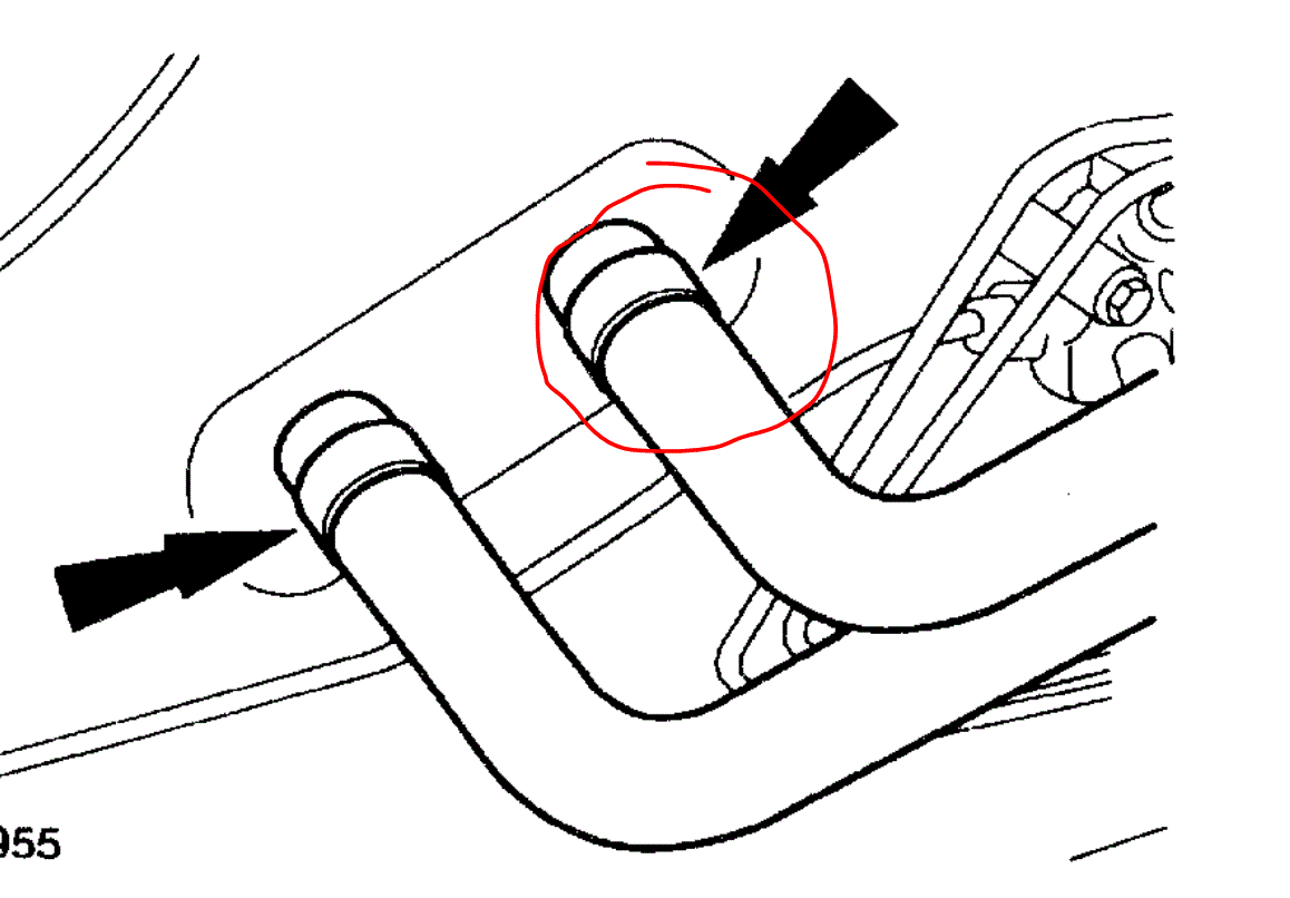

That is odd. Do me a favor. When the engine is cold, loosen the return line (heater core hose at the firewall). With it lose, have a helper start the engine and see if you can get air to come out and then coolant. Since you have no heat, something is preventing the coolant from entering it.
I attached a pic below of the heater hoses at the firewall. If I recall correctly, the one on the right is the return.
Please keep in mind, this will get messy. LOL Protect your eyes and wear old clothes.
