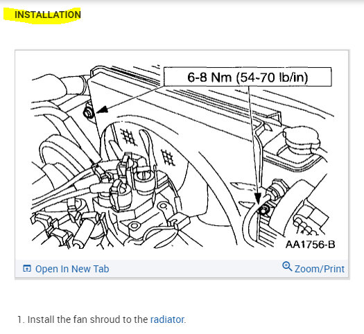

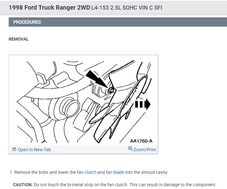

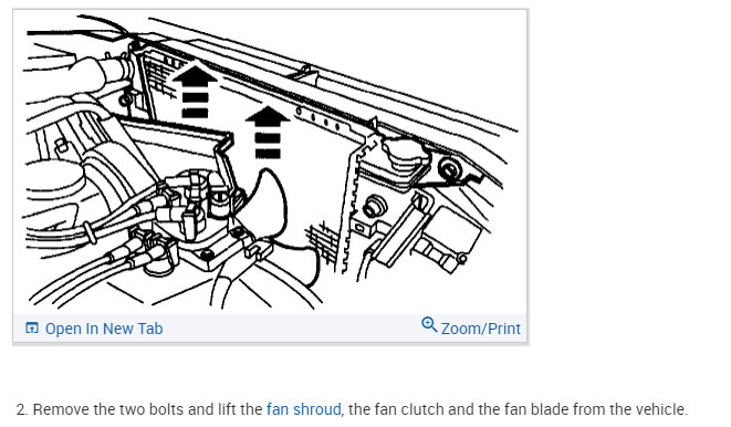

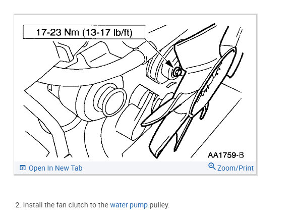

Question. If you drive the vehicle constantly at highway speeds, does it overheat? If not, then the fan clutch is the likely issue.
When the under-hood temperature gets high, you should actually hear the fan spinning faster. Most people describe it as sounding like a jet engine. Have you ever noticed?
If not, then that is what I suspect. If you look below, I attached the directions for replacing it. Take a look through the pics and let me know if you are comfortable performing this.
Take care and let me know if you have questions.

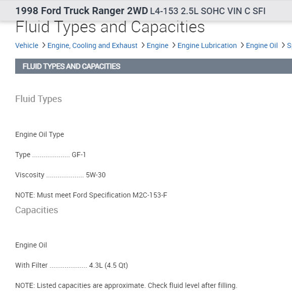

I've never noticed the fan noise so I'm assuming that it doesn't click over to run faster. I'll take a look at that. I also just did an oil change on it since getting it. I accidentally put 5w20 in instead of 5w30 and I was told it wouldn't be a big deal. I drove it around a bit and let it sit and see if it would start getting hot and it didn't get as hot as it normally would. Do you think this may also have something to do with it?

The oil you used is a little thinner and won't provide the same protection, especially if you live in a hot climate. Thinner oil may not provide sufficient protection at higher operating temperatures, potentially leading to increased wear and reduced engine longevity.
Using 5W-20 engine oil instead of the recommended 5W-30 oil in your car is generally not recommended. While both oils have similar viscosity ratings at lower temperatures (the "5W" part), the main difference is in their viscosity at higher operating temperatures (the "20" or "30" part).
I attached the specifications for engine oil below. It does show 5W30.
Let me know if that helps. Also, let me know about the overheating issue. Remember, if it doesn't overheat at highway speeds and only does in stop and go traffic, chances are the fan clutch is faulty and not drawing enough air through the radiator.
