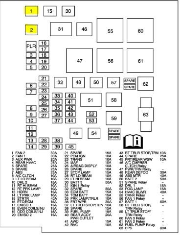

I have done changed everything I can think of . It started running hot about 2 months ago and I bought blue devil and put it there and it fixed it for awhile but now it started back but only when it is idle . I can drive down the road and it cools down where it usually runs at . What could be wrong ?

If this only happens when sitting still, it sounds like an issue. When the vehicle starts to overheat, pay attention to see if the fan turns on.
Take a look through this link. It explains how a cooling fan works.
https://www.2carpros.com/articles/how-an-electric-cooling-fan-works
If the fan does not turn on, follow these directions.
Also, check fuses 1 and 2 in the under hood fuse box. Both are 30 amp and power the cooling fan. See pic 1

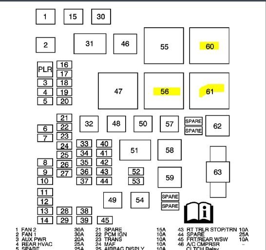

Also, check relays 56, 60, 61 in the under hood fuse / relay box. See pic 2
Here is link that explains how to test a relay:
Let me know if it doesn't turn on or if you have other questions.
