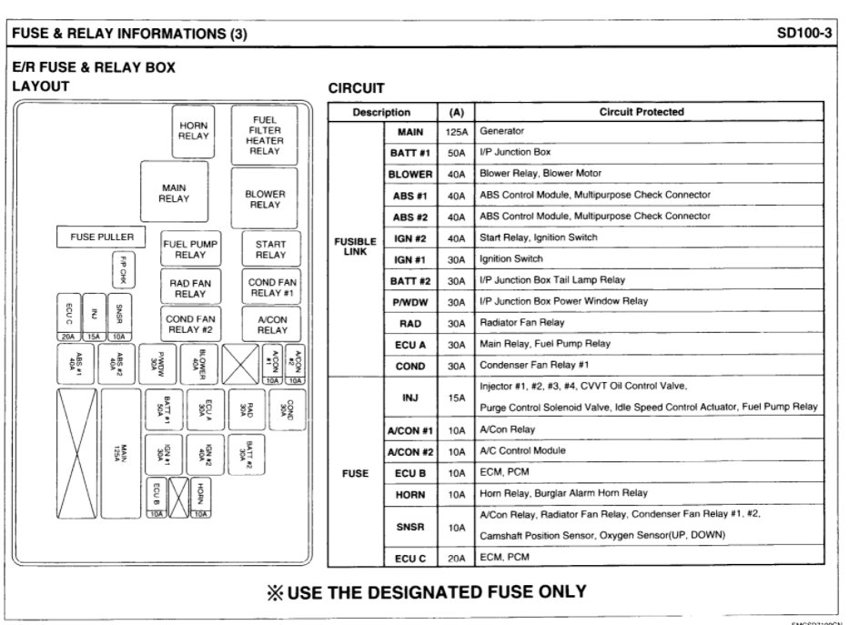

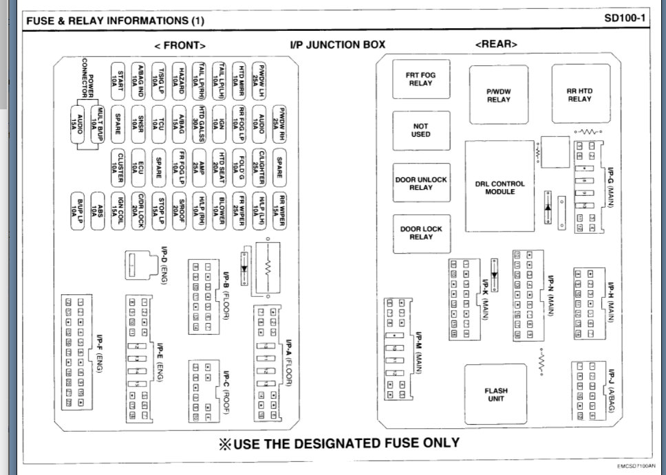

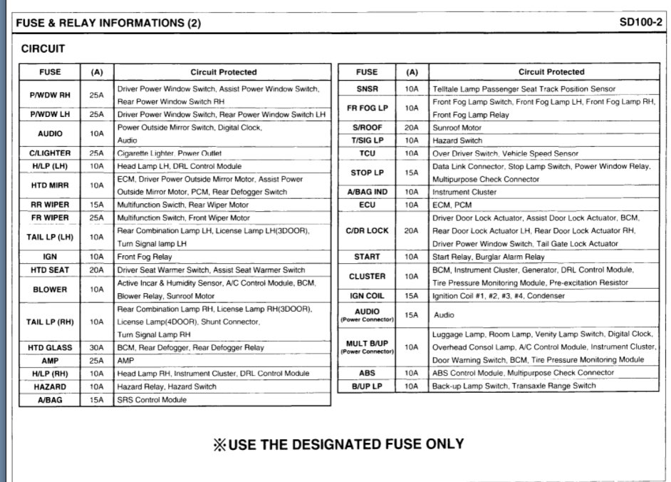

The engine is overheating the fan is not working. Where are the fuses can you help me test them?
Oct 17, 2016 at 2:08 AM
Experienced Mechanic
18,907 POSTS
Here is a guide that will help with testing and replacing fuses if this info is needed:
Below is the info from the manual on the location of the fuses. Please let us know if you have questions on this and let us know what you find. Thanks
