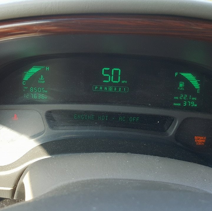

About two months ago my dash panel told me to turn off my A/C due to hot coolant and idle engine, the heat gauge went all the way up. Turning off the A/C caused the heat gauge to come down. when I had a chance I checked the overflow jug and it was fine. The shop said they could not see why it was overheating and suggested that I have it flushed out and replaced the coolant. Car ran fine for a month or so and suddenly the check engine light came on and after a few miles the car overheated again with the same message as last time, only this time when I turned off the A/C it did not bring down the heat gauge. I had the car towed and the same garage said that the radiator cap was no longer holding pressure and my fluids were very low, after replacing it it was not overheating and the check engine light was due to a crack in a boot or coupling on the manifold and unrelated to the overheating issue. Car ran good for a couple days and then a message to check my coolant levels started coming on every time I would start the car. My uncle checked the coolant levels (which was only slightly low) and drove the car and the light went off after three miles and I drove it for two more days and just hit reset and the light only came back on when restarting the car inconsistently. After two days of this the car once again overheated and most of the coolant was gone. Same shop ways that they are now finding an obvious leak on a seal near the rear of the engine near the heater core, but they still cannot figure out why it is overheating. They checked the thermostat and the fans and both appear to be fine. Help! I simply cannot buy another vehicle.

So... ever since the shop replaced the thermostat the heat gauge only rises (1bar and what appears to be at random times or when I accelerate onto the expressway) in the heat of the afternoon and not at all first thing in the morning. However last Thursday when temperatures went above 80 F the gauge went up 2 bars. Needless to say, I am getting worried that I may get stranded sometime soon.

I am attaching an image from when it overheated to demonstrate the bar level. Currently it has been indicating 1 to bars above the middle line (into the more faded bar area) on the gauge during hot weather and expressway acceleration. Until the overheating issues it never went above that line.

Thanks for the upload, a couple things come to mind, first if they installed the thermostat backwards it will cause the engine to over heat which looks like what is happening.

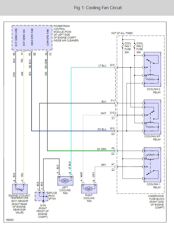

Lets check it this way, When the engine is cold turn the air conditioner on and wait 2 minutes. You should be able to hear the fans running. You can also lift the hood and just look.

I haven't done the fan check yet and I know that they have been diagnosed as kicking on when needed. My uncle is wondering if perhaps they are not kicking on consistently and questions whether or not the connections are solid but says they are difficult to get to. Any suggestions on checking those connections?

A bad connection or relay can cause the cooling fans to work only sometimes.
Here is a guide and some wiring diagrams to help us test the system.
