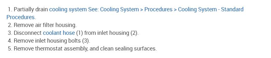

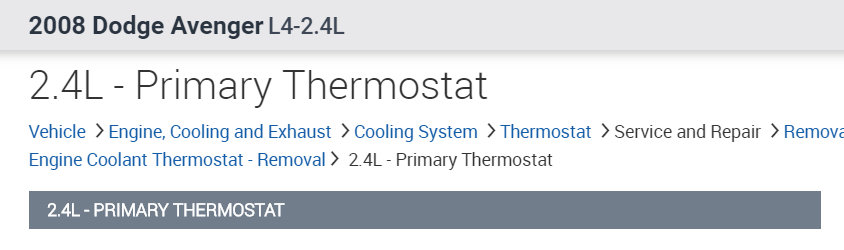

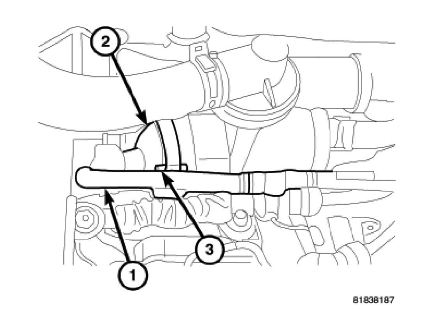

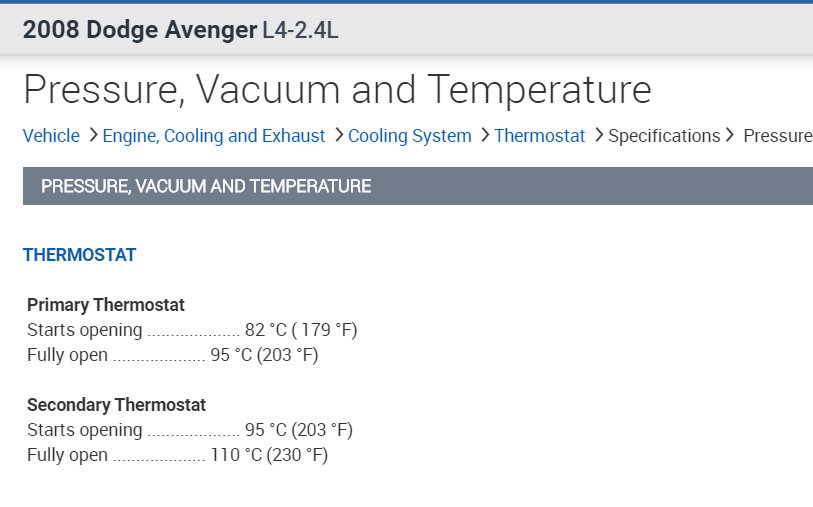

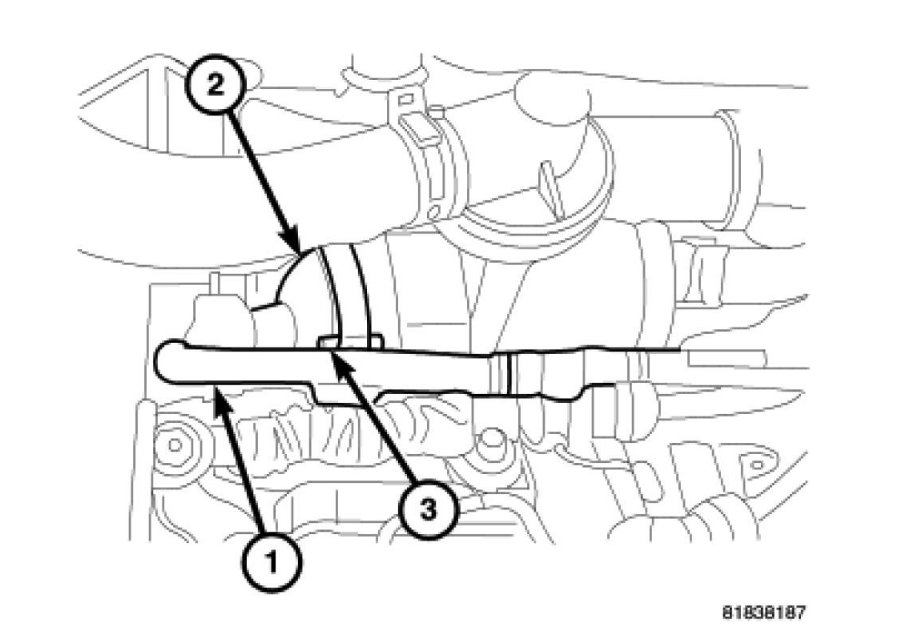

This is probably going to be a stuck closed thermostat and/or a bad gasket that seals the thermostat housing. In the diagrams below I have included the directions for the removal of your thermostat and the specs for the replacement thermostat. Installation is the opposite of removal. Please go through this guide and get back to us with what you find out.
