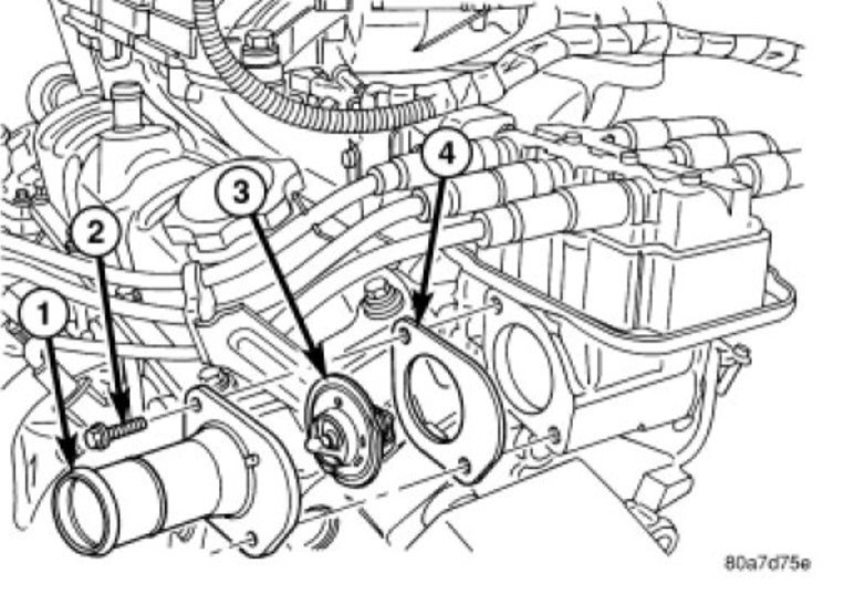

The van started overheating after travelling most of the day in ninety five degree heat, we were using the A/C.
The radiator fan runs, there is coolant in the reserve bottle as well as the radiator. I flushed out the radiator, but the only thing that will help cool the engine is using the heater, (A/C off), full blast. there is noting coming out of the exhaust pipe to suggest a head gasket. I am thinking possibly thermostat, but I do not know how to check it.

The best way to check the thermostat is to replace it. Here is a guide that will show you what you are in for when doing the job:
and
https://www.2carpros.com/articles/engine-overheating-or-running-hot
Here is a diagram on how to do it on your car. (below)
Jul 14, 2017 at 4:54 AM

I replaced the thermostat, but it still over heated. I then back flushed the radiator, (a lot of brown colored water came out), and it has been running okay without the heater on. I can run the a/c, but I can see the gauge climb to close to 3/4 on the freeway.
Is it possible the radiator may still have some clogs in it and just needs to be replaced?

The radiator may have some blocked core tubes, a radiator repair shop can clean this out for you, the tanks need to be removed it is not something that you can do at home.
If it was neglected long enough for brown liquid to come out it may very well be clogged and need a "Rod-out" which requires disassembly of the radiator. New radiators are aluminum and plastic, so after so long they are not repairable and need to be replaced due to fatigue of the materials.
