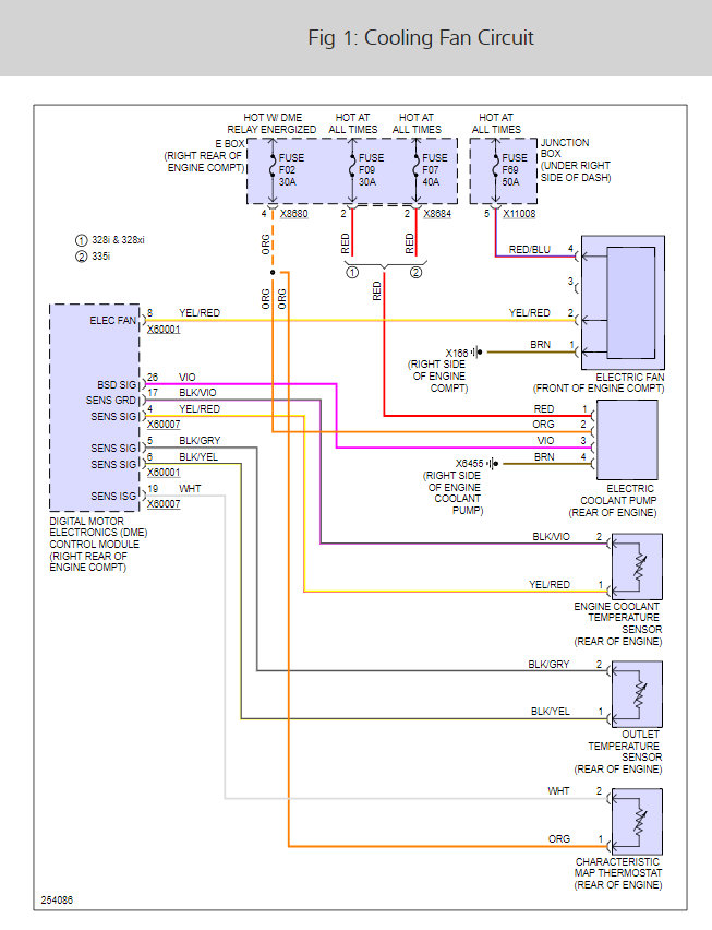

What will happen to the water pump is the impeller with become dislodged from the shaft allowing it to spin sometimes. Also when the engine is overheating do you hear the cooling fans running?
This guide can help
https://www.2carpros.com/articles/engine-overheating-or-running-hot
Here is the wiring diagrams for the cooling fans. (below)
