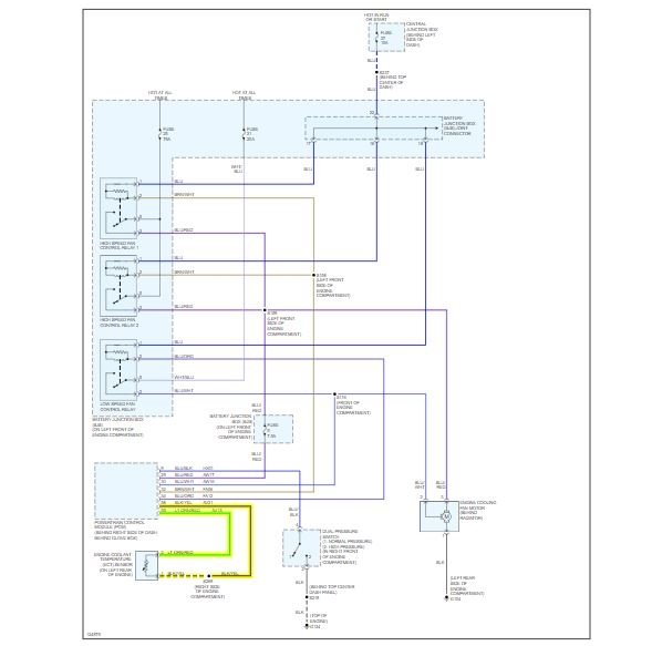

This van is overheating. The radiator fans do not engage even when the AC is turned on max. We have checked the relays, fuses, wiring harnesses, and all test as working. The temp sensor also tested as good. When we unplug the temp sensor the fans engage and run on what sounds like high speed. We did not find any cracks or leaks in any hoses. We have it pulled up on ramps and have let it run and have not seen any leaking. It is not throwing any codes either. I'm not entirely sure that it got to temperature at idle as the OMBII reader showed it at 197 degrees. Someone mentioned that there might be a temperature sensor/switch as well as a sensor but we are not able to locate one.

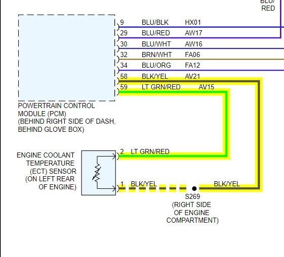

We disconnected the sensor shown in the first photo. It shows voltage on a meter when checked. Are you saying that when it is disconnected and the fans start that the sensor is bad? My husband felt that doing so indicates the sensor is working because it went into fail-safe mode and threw a code. Fans stop when sensor reconnected. We are almost to the point of thinking the PCM is what is bad. Is there a way to check the PCM? Where is it located?
Jun 12, 2019 at 11:48 PM
The sensor measures temperature and sends a signal to the PCM. when you disconnect it, it sends a high temperature signal to the PCM and commands the fans on.
When you jump the 2 pins, it sends a cold temperature reading to the PCM.
Yes, the sensor is bad.

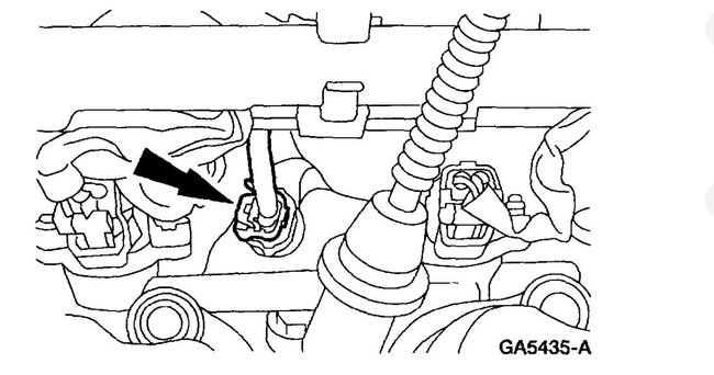

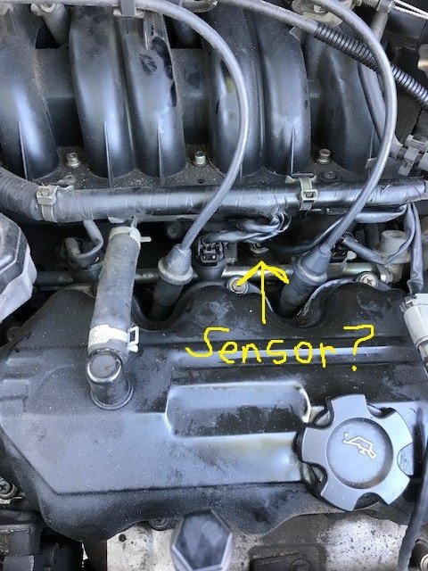

Am I correct in the photo as to that being the temperature sensor?
Jun 13, 2019 at 12:15 AM
That is correct.
