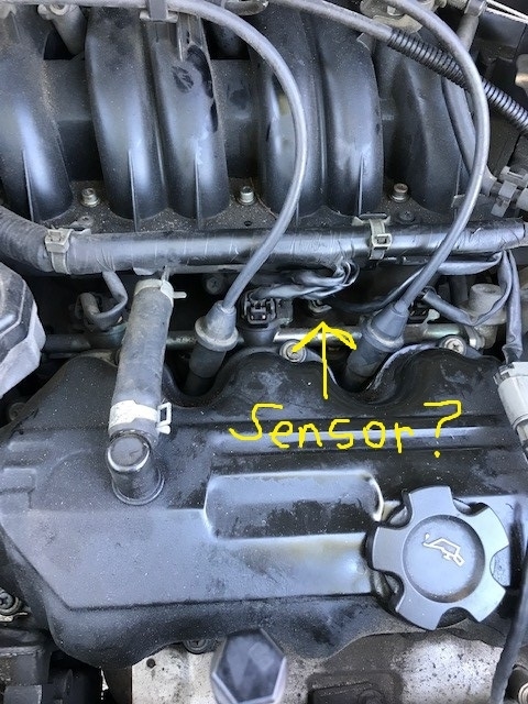

We disconnected the sensor shown in the first photo. It shows voltage on a meter when checked. Are you saying that when it is disconnected and the fans start that the sensor is bad? My husband felt that doing so indicates the sensor is working because it went into fail-safe mode and threw a code. Fans stop when sensor reconnected. We are almost to the point of thinking the PCM is what is bad. Is there a way to check the PCM? Where is it located?

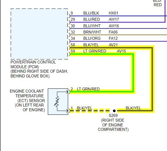

The sensor measures temperature and sends a signal to the PCM. when you disconnect it, it sends a high temperature signal to the PCM and commands the fans on.
When you jump the 2 pins, it sends a cold temperature reading to the PCM.
Yes, the sensor is bad.

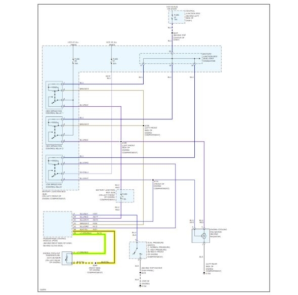

And this applies to the fan not engaging when the AC is turned on max? Shouldn't the fans come on at that point no matter the temperature sensor reading?
Jun 13, 2019 at 12:00 AM
Does the AC system work?
The high side of the AC has to be at 150 lbs for the fans to engage.
Jun 13, 2019 at 12:07 AM

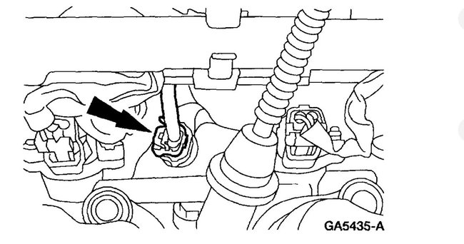

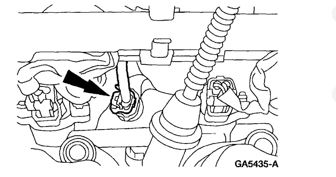

Am I correct in the photo as to that being the temperature sensor?
Jun 13, 2019 at 12:15 AM
That is correct.
The AC must work before it will turn on the fans.
