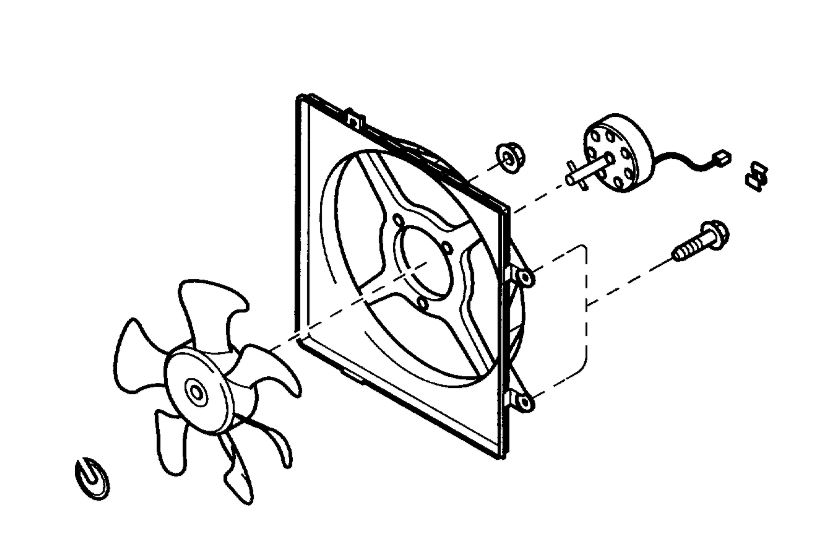

When I run the heater my car runs hot. Radiator has been flushed and refill with coolant, replaced replaced radiator and AC cooling fans, coolant sensor and just replaced thermostat with a 170 degree F. Not losing coolant

Good afternoon.
When you turn off the heater, does the engine cool down?
Usually, it is the other way around.

Yes, or turn an AC will help cool down.
Friday, October 12th, 2018 AT 2:41 PM
  • 52,797 POSTS
Okay, is the cooling fan working at the radiator when it gets hot?
I am wondering if the cooling fan is cutting off and not pulling cool air through the radiator. The fact that it cools down with the AC on tells me that fan is working and cooling the engine.

I was thinking the same, it actually got hot while I was sitting in the drive through. Is the radiator fan supposed to be a two speed motor? The fan is about four months old.
Friday, October 12th, 2018 AT 10:05 PM
  • 52,797 POSTS
No, it is one speed. It is just turned on by the AC system and the cooling system.
