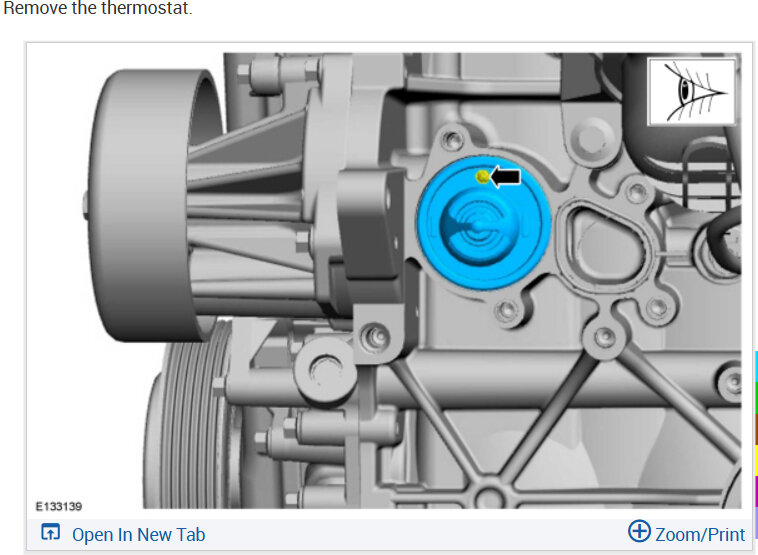

Hi, I recently had a leak and ran hot. It was coming from the radiator. so, I got it replaced. Then the shop told me it was the water pump and got it replaced. Now the shop told me it might be a head gasket, but the car still runs fine until for about 15 miles then runs out of coolant, refill starts to boil but it's not leaking. no more A/C works heat works and check engine light cut on.
Jun 2, 2025 at 12:53 AM
  • 55,691 POSTS
When they did the water pump, did they replace the cooling system thermostat? If not, that is what I would do for the next step, at the same time I would do a chemical test for the cooling system. Here is the location for the thermostat and a guide to show you what needs to be done for the test.
Jun 2, 2025 at 10:04 AM
FAUSTIN360
No they did not replace thermostat.
Jun 5, 2025 at 2:56 AM
  • 55,691 POSTS
That would be the first thing I do, along with a chemical test.
