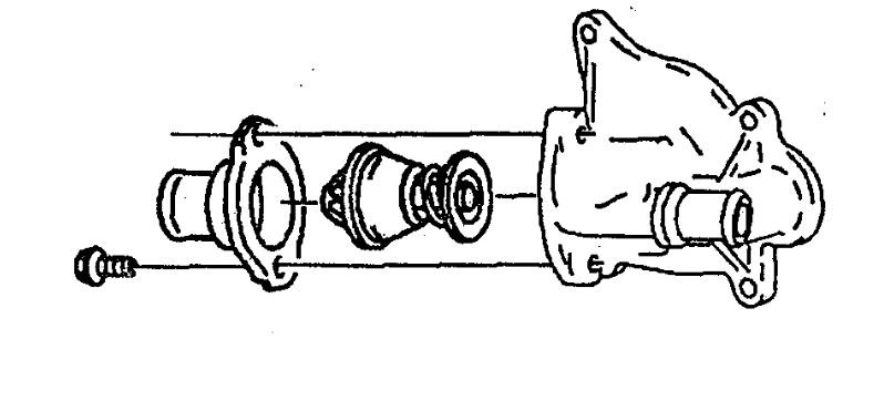

The first thing I would do is make sure the thermostat is working. If it overheats, I would change it.
https://www.2carpros.com/articles/how-an-engine-thermostat-works

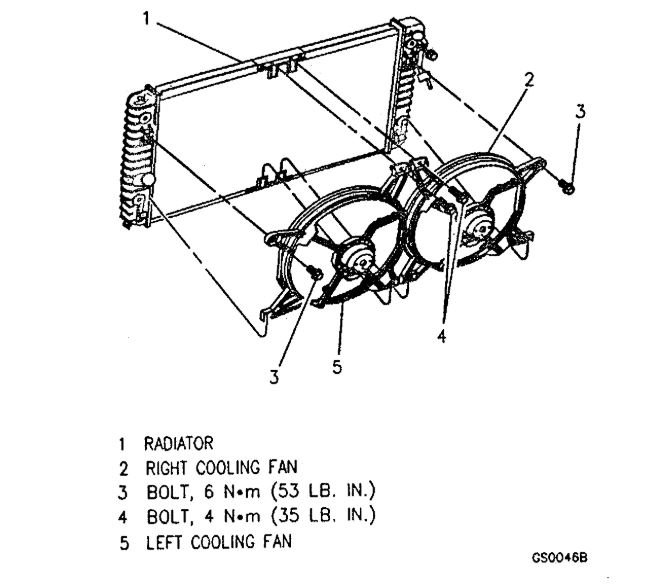

Also, are the cooling fans working? They should come on when it gets to 208 degrees and the when you turn on the A/C the fans should come on.
https://www.2carpros.com/articles/how-an-electric-cooling-fan-works
