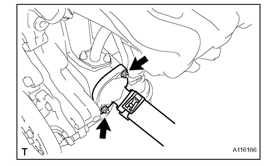

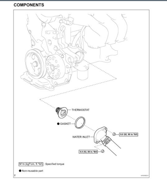

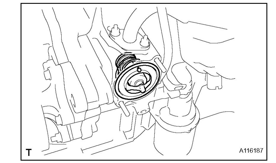

Okay, then that is the reason for the overheating and the engine damage. I attached the procedure for you and some pictures.
You will most likely be replacing the engine from that procedure.
REMOVAL
1. DRAIN ENGINE COOLANT
2. REMOVE WATER INLET
(a) Remove the 2 nuts and separate the water inlet with radiator hose from the cylinder block.
3. REMOVE THERMOSTAT
(a) Remove the thermostat from the cylinder block.
(b) Remove the gasket from the thermostat.
Nov 20, 2020 at 1:47 AM
