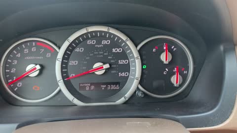

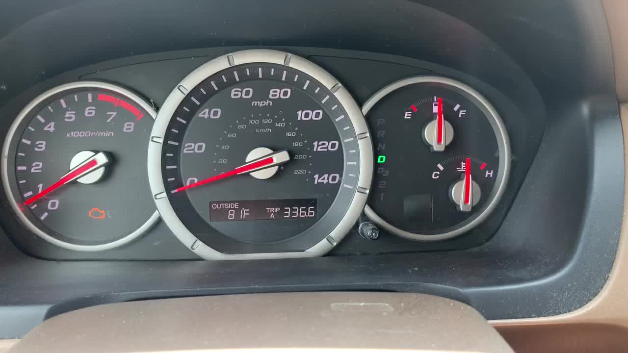

My air conditioning was not working and I fixed it. Now the car overheats at idle. Cools off immediately once I press on accelerator (in gear or neutral).

I filled up the radiator with about half a jug of coolant and so far so good. I let it idle for just a couple minutes and the temperature didn’t rise. I will be able to check again tomorrow.
