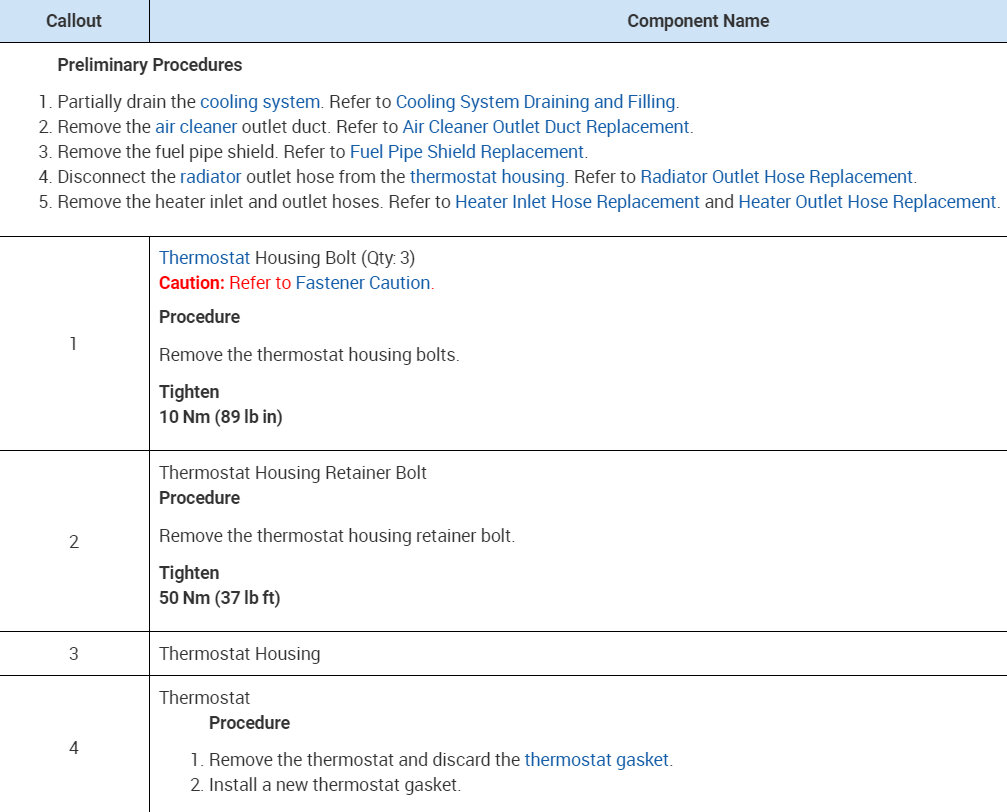

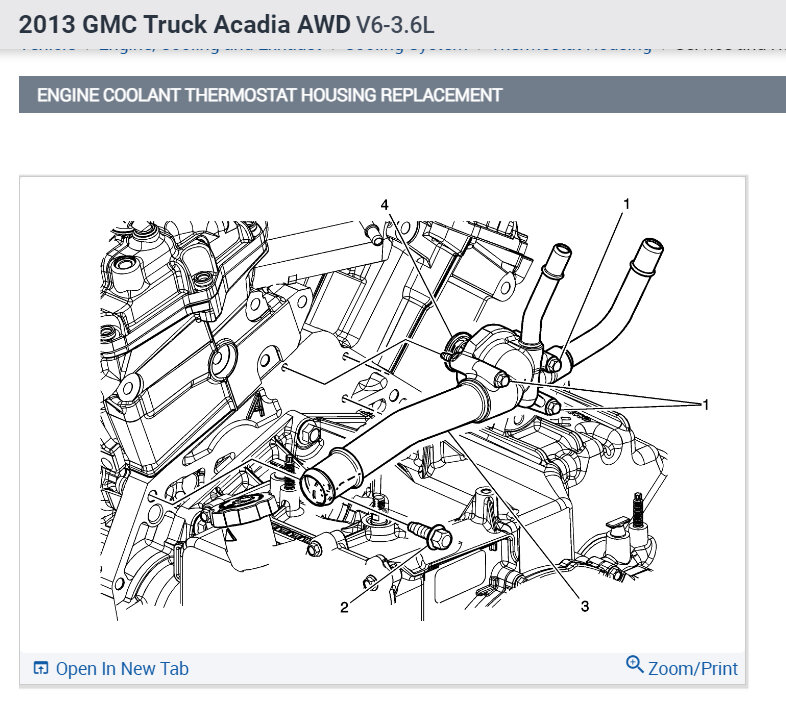

To be clear you fixed the "heater hose line connecting to the thermostat housing" correct? If so, it sounds like the thermostat is stuck closed, here is a guide to help, please go over it:
https://www.2carpros.com/articles/engine-overheating-or-running-hot
Here is how to change the thermostat out. Check out the images (below). Please let us know what you find.

Thank you for the response. Yes, I did fix the heater hose line. I have a new thermostat and housing that I bought before I saw the broken connector. I am hoping it is the thermostat and not the water pump.

I put the new thermostat and housing on. No bubbles in the coolant from the radiator. Heat blowing again in the car. Mind you, it is 50 degrees outside, so I will take it for a drive in the morning.
