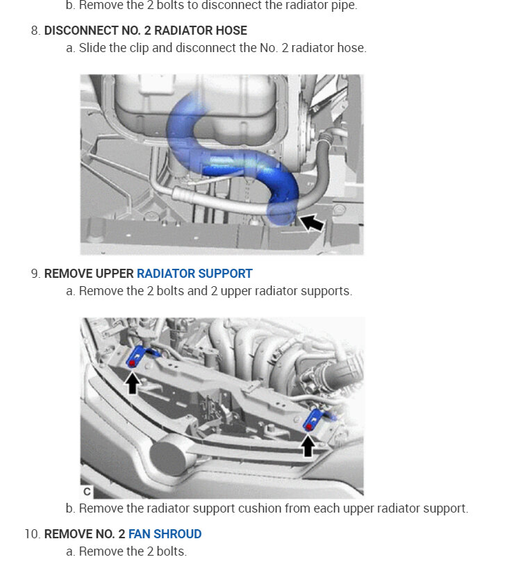

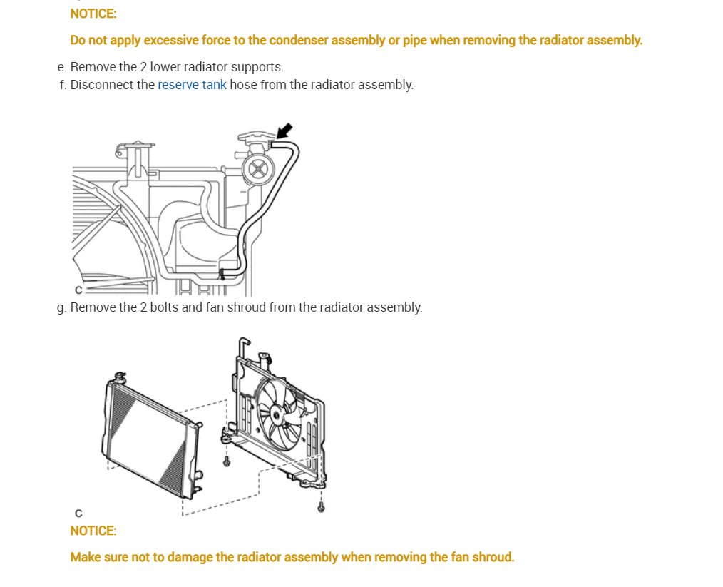

It doesn't fully boil the coolant, but the heat signal comes on and goes away. If i use the A/C it also overheats. I have made sure its bled right. I suspect the radiator is blocked. Please help.
Oct 17, 2022 at 12:54 AM
  • 55,433 POSTS

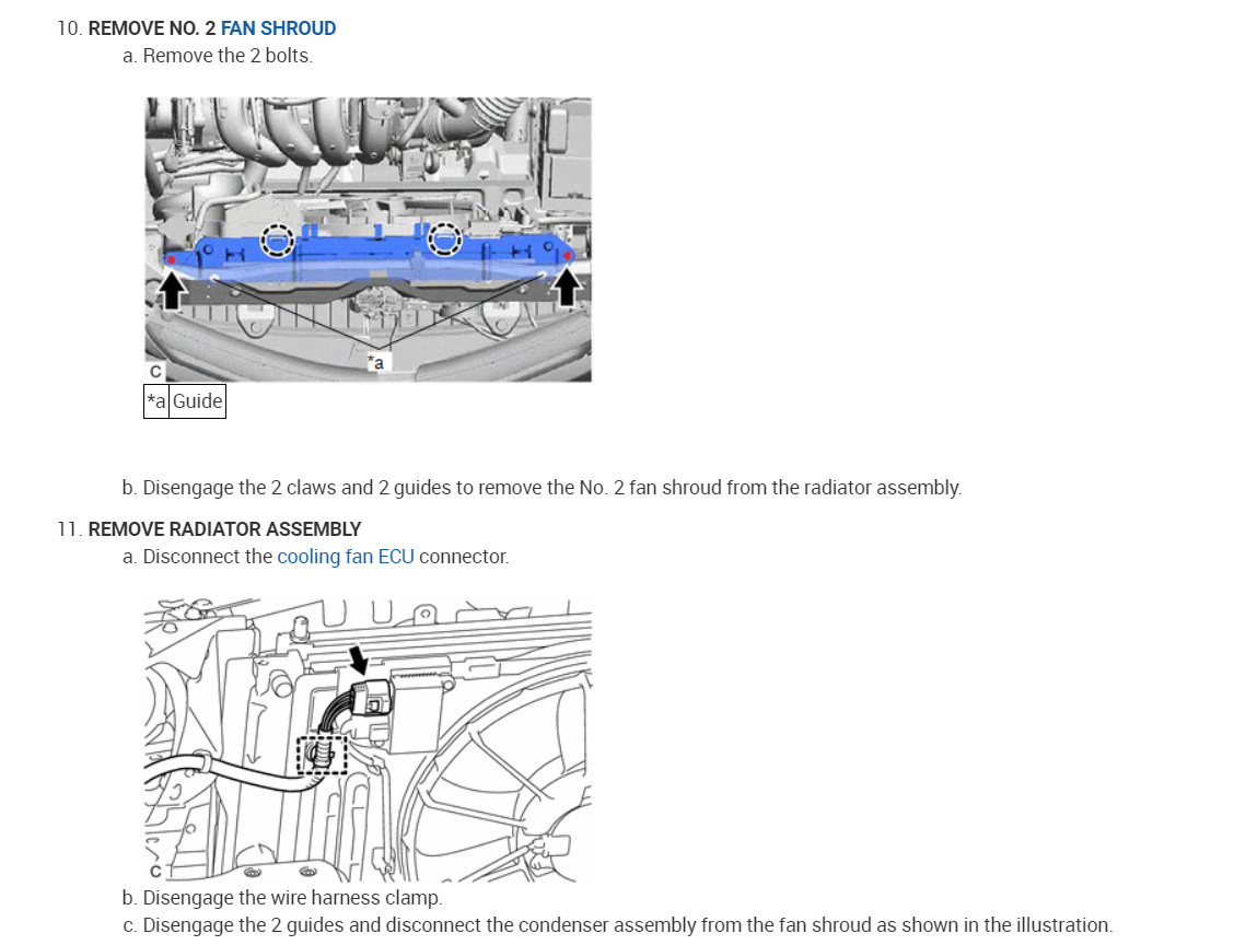

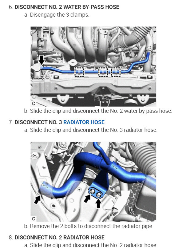

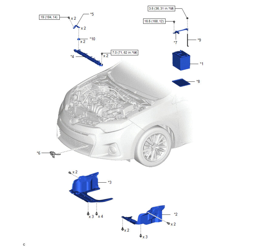

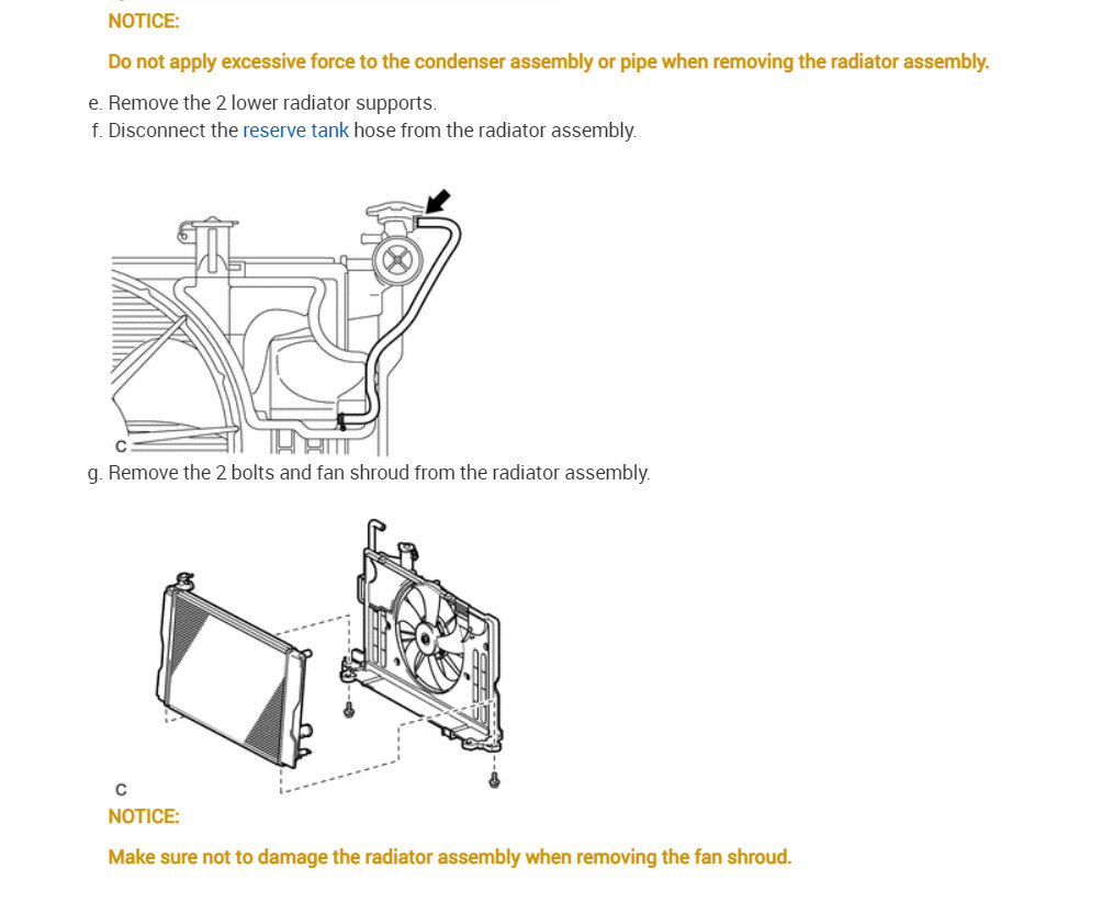

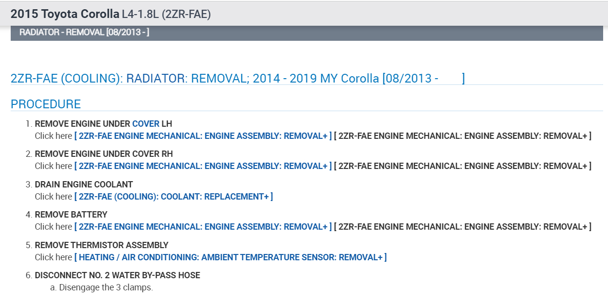

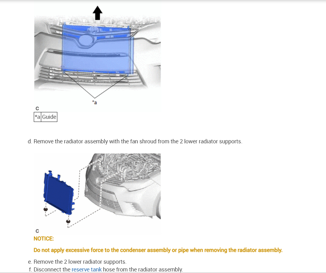

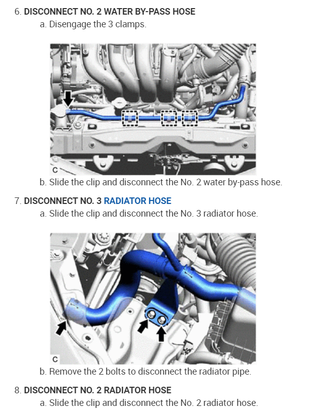

When it is overheating can you hear the cooling fans come on by the radiator? If so, I agree with you that the radiator needs to be replaced. Here is a generic guide on how to replace the radiator with instructions below to show you how to in your car.
https://www.2carpros.com/articles/how-to-replace-a-car-radiator
This guide can help as well:
https://www.2carpros.com/articles/engine-overheating-or-running-hot
Check out the images (below). Let us know what happens and please upload pictures or videos of the problem.
