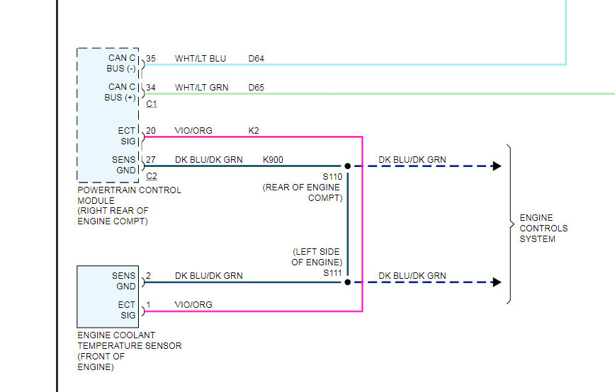

I sat in traffic for awhile and came home hot a shower and went back out to McDonalds. It then overheated sitting there i turned it off after i parked and it began to cool down fast. Only time it has overheated. I check to make sure no leaks but the heat takes awhile and its better when i drive. The fans kick on but only if i mess with it. What should i do to figure it out?

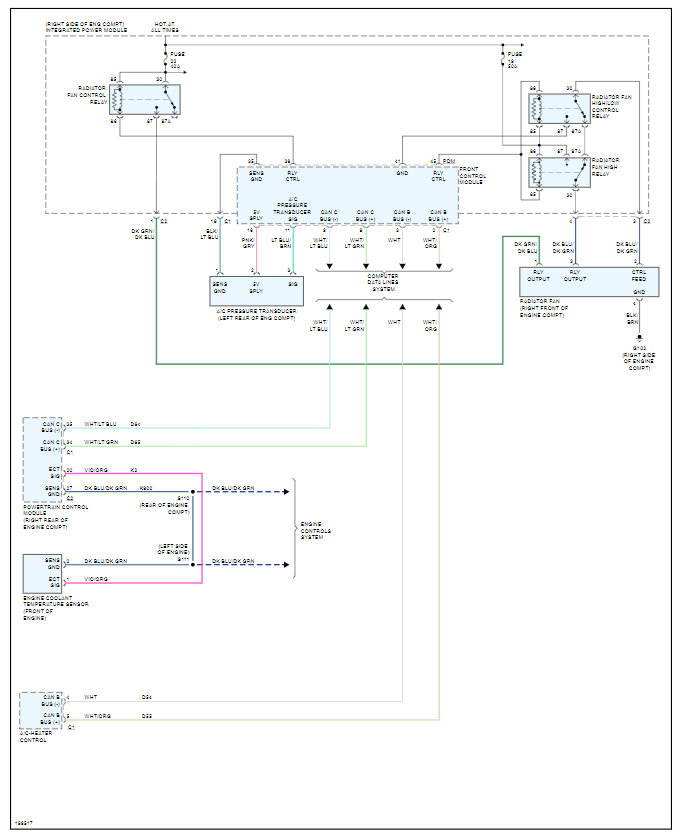

The coolant level hasn't dropped, but I'm going to check it again tomorrow and i want to put it under a pressure test but i work. The fans don't seem like they run unless i unplug the coolant sensor but the relays are good. i have to check the fuses.

So if the fans only come on when the sensor is unplugged then we need to check the operation of the sensor. Does the engine coolant temperature gauge in the dash work properly? Did it show the engine getting hot?

Okay. Any chance you have access to a scan tool that can monitor live data? Do any of your friends have one if you do not? We need to find out if the PCM is commanding them on. I suspect it is not but what is odd is when the sensor is unplugged the PCM commands the fans on. Which would mean the sensor is most likely reading improperly but if the gauge is working then that doesn't prove out because the gauge gets the signal from the ECT as well. I have to imagine the PCM is the issue but I would like some more proof of that first.
