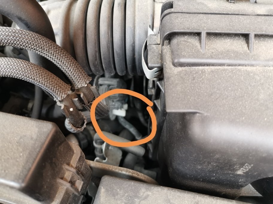

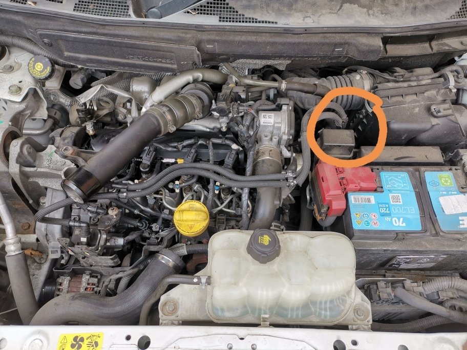

Help with what this part is called. It connects to the high pressure pump to the right hand side as you look at the car. The fuel return connects to it along with two other connections. One is electrical, not sure on the other one.

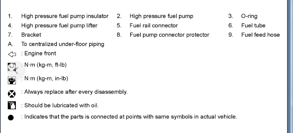

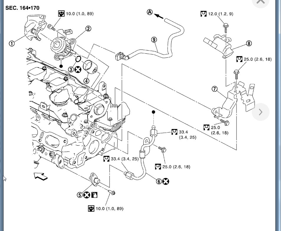

I attached the exploded view to see if you can locate it. If not we will need that picture of it. Thanks

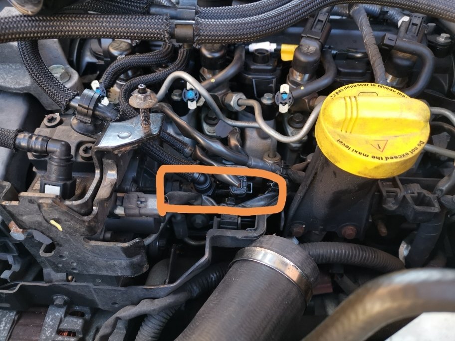

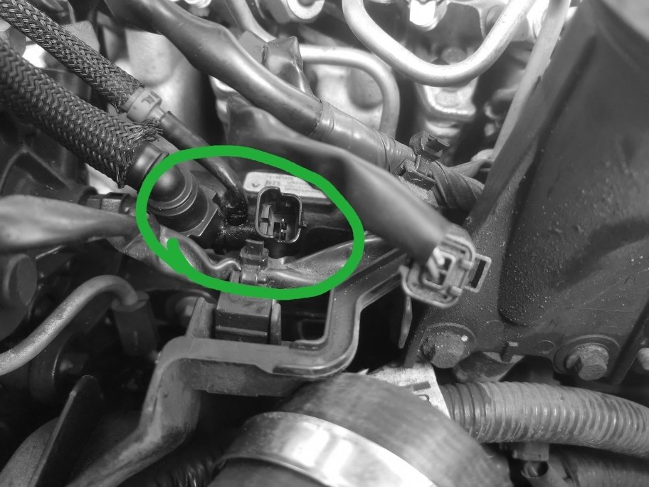

Thanks for the reply. Are these photos any good? Can get some more in the morning if these don't help. The photo with the green circle shows with the elec connection disconnected. The pump is to the left. You can see the over fuel line in the photo and where it is leaking.

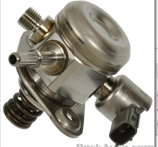

The pictures are okay. They are a little close which makes it hard to orient myself, however, that looks like the high pressure fuel pump. The electrical connector is for the regulator which is part of the pump. Basically this PCM controls the high pressure pump and how much actual pressure to deliver through this. Let me know if this is not it and we can go from there. Maybe get a couple more pics from a little further away. Take a look at the attachment and see if that matches what you are seeing. Thanks.

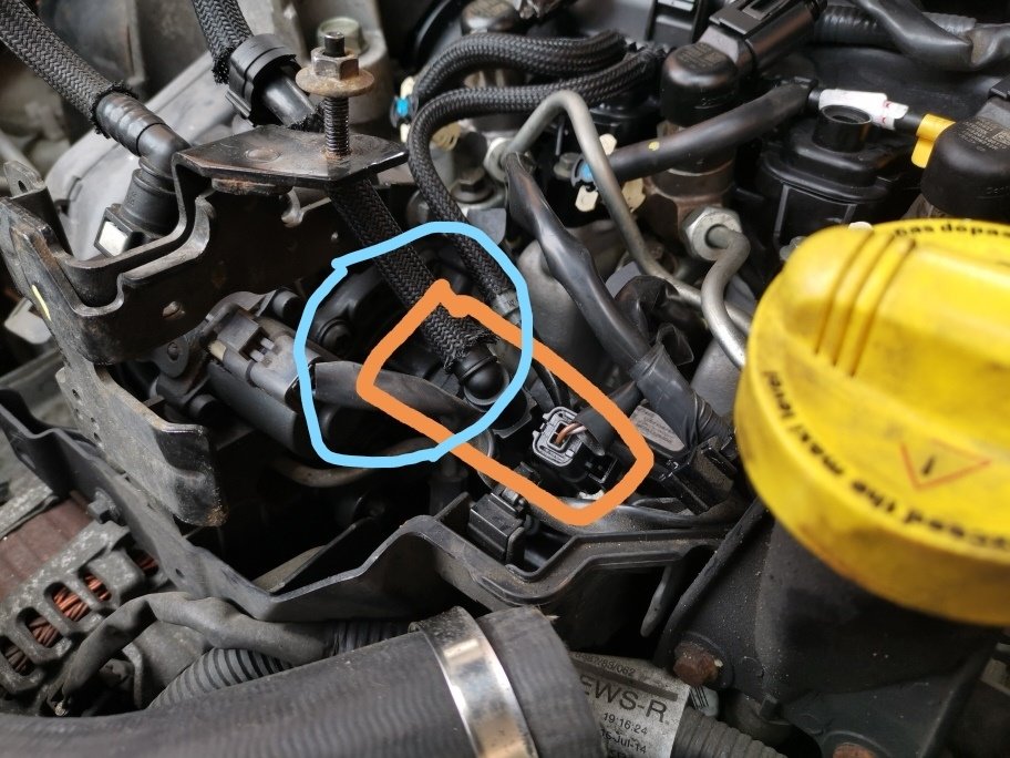

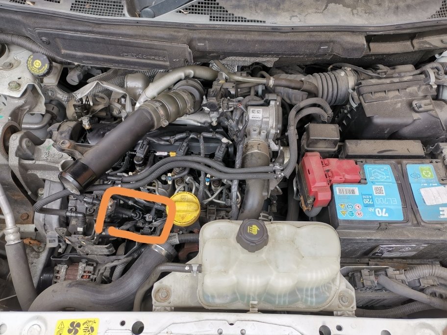

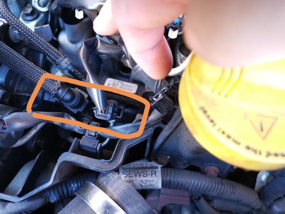

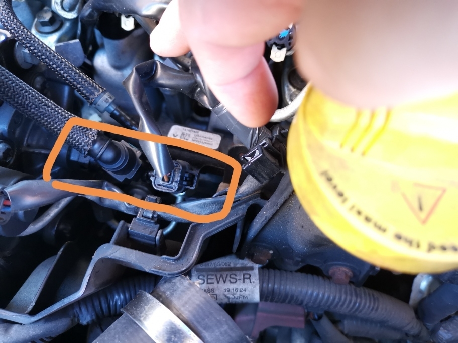

Hi, not the part in the photo above. The part is made out of plastic. Do these photos help? In the first photo the pump is to the left and it is the plastic part circled in orange.

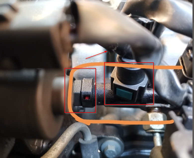

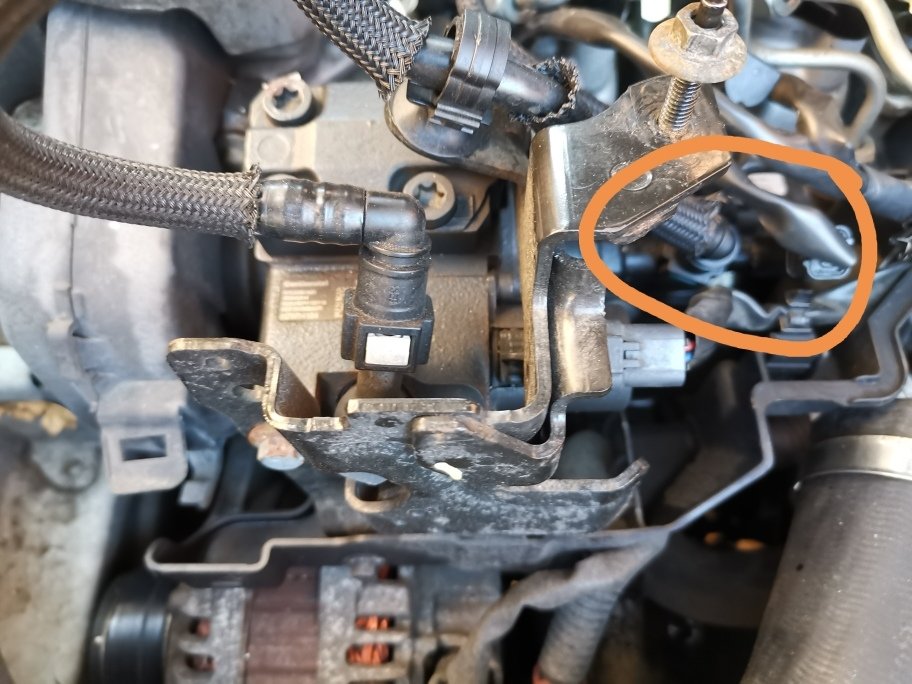

I am sorry. I still can't tell what that would be. Can you take a look at this picture and tell me what those two connectors lead too? Basically what do those connections connect to and where does the line with the green release lead too? What is on the other end of the line?

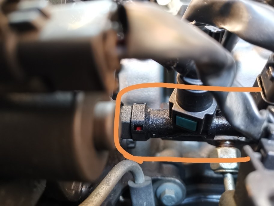

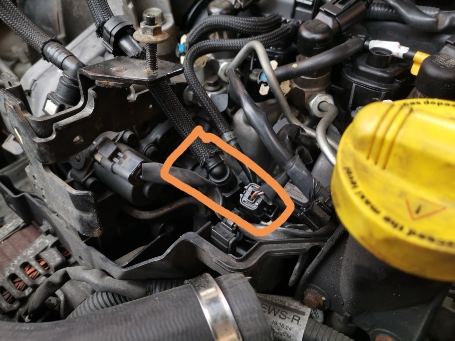

Do these photos help? I have attached where the lead with the green connection goes in photo 3 and 4.. also there is a photo with the green circle on that shows what the smaller of your red squares connect to. I think that it is the high pressure pump that it connect to, in photo 7 it the part number on what i think is the high pressure pump. Thanks for your help.
May 21, 2020 at 7:02 PM
Okay. I think I see the issue. Can you confirm your engine for me? 1.5L DCI?
We don't offer that engine here in the USA so I have been looking at the manuals for the turbo 1.6L which too has a high pressure fuel system but is a much different engine.
