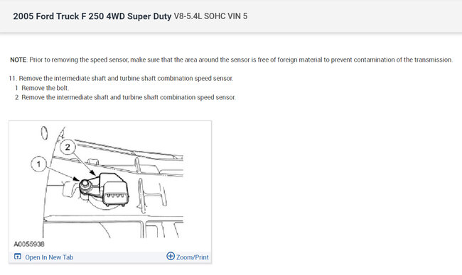

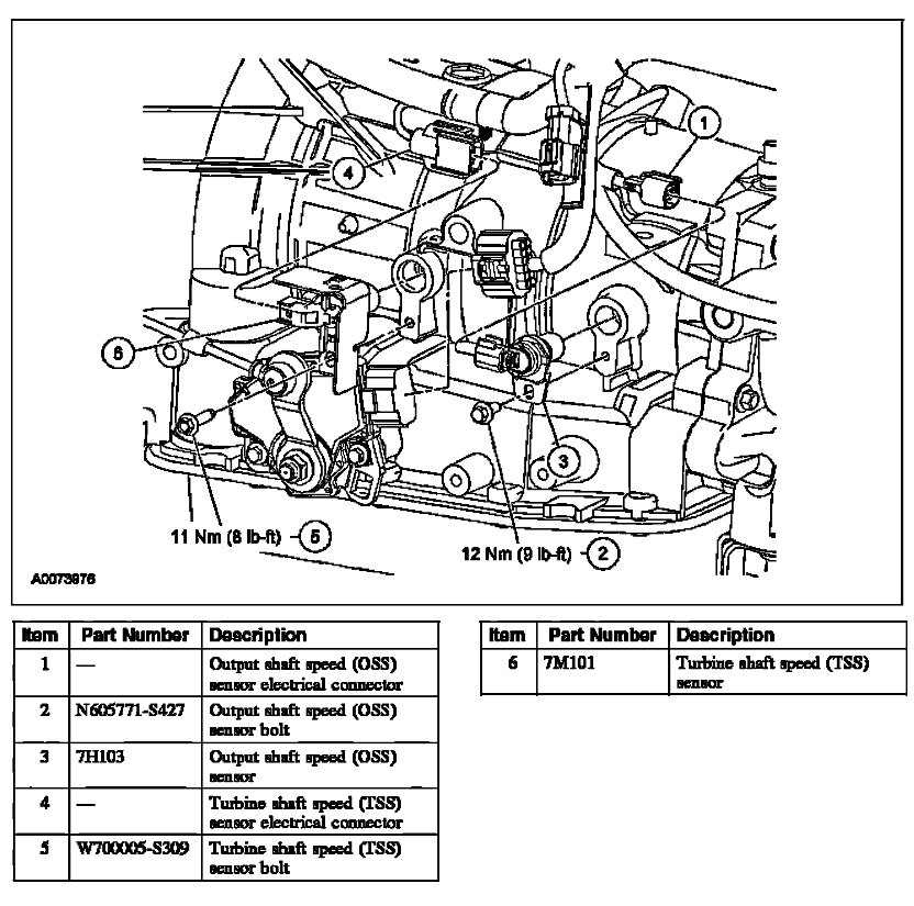

Does the engine temperature gauge stay on cold? I have seen a cooling system thermostat sticks open and cause the PCM no to go into closed loop which will hinder the overdrive operation and leave no codes. Also, how is the shift time of the other gears, are they late or early? This transmission has an turbine shaft and intermediate shaft sensor they may cause it not to go into overdrive as well. It does seem strange that it has no codes. One more thing is the catalytic converter could be partially clogged which will cause the engine vacuum to be lower which can keep the overdrive gear from engaging. Does the engine seem to have good power? Here are the locations of the shaft speed sensors so you can check it out. You will need to remove the transmission crossmember to get at it. Check out the images (below). Please let us know what happens.

Temperature on gauge and scanner are at 208 when up to temp. The rest of the gears shift as they should. I did look at the O2 sensors and bank one sensor 2 is mirroring sensor 1. The sensor is going up and down. I also took temp at pipe in and out of cat and the temp coming out is cooler. I am going to run some cata clean through it to see if it will help. I will check out the sensor, but the pic is for a f250. Looked at diagram on f150 to check for turbine speed sensor.

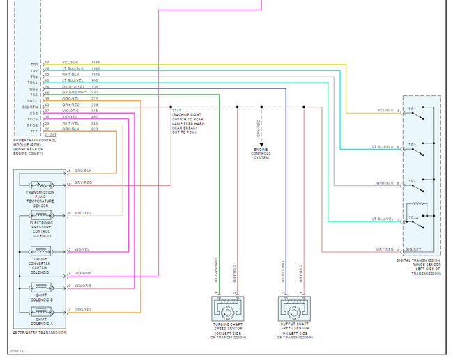

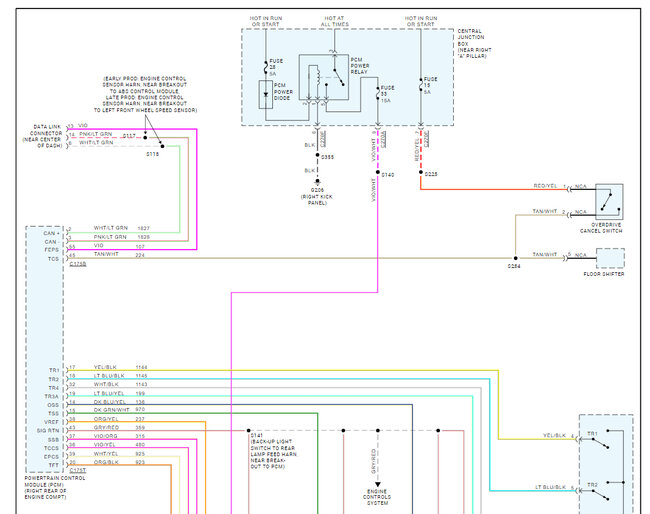

How does the engine power seem? Here is the turbine shaft speed sensor location of the f150 but I think you may have a shift solenoid "B" that is not working correctly. Here is the location so you can test it by putting 12 volts to it, you should hear a "click" drop the pan and remove the filter, it will be the solenoid with the VIO/ORG wire going to it. Here are the transmission wiring diagrams as well so you can see how the system works. Check out the images (below). Let us know what you find.
