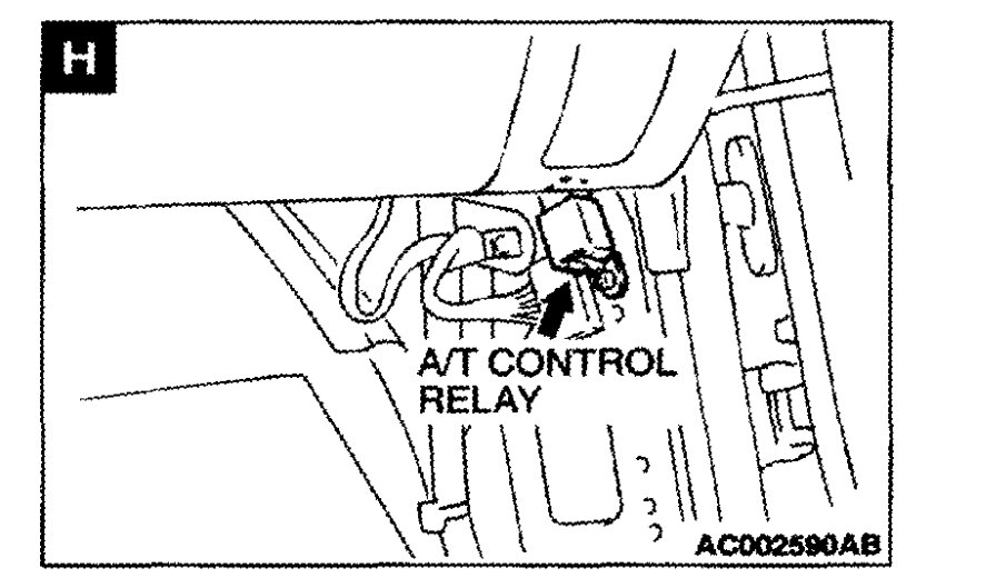

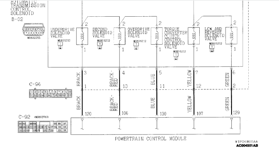

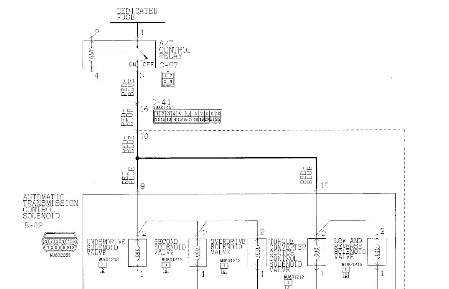

Can you please tell me where to find the overdrive relay on Mitsubishi Nativa (Montero)?
Sep 24, 2023 at 10:48 AM
  • 110,244 POSTS
Please understand, the Montero wasn't offered with a 4-cylinder engine, so I had to go with a 3.0L V6.
As far as the relay, there is one, it is the automatic transmission control relay. Pics 1 and 2 below are the wiring schematic. Pic 3 shows where it is located on the Montero.
Let me know if this helps.
