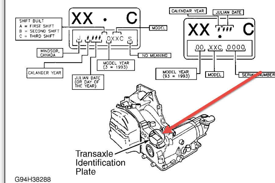

you need someone with atech 1 or 2 with the adapter for that to pull codes.. there are two different transmissions in this a 3t40 or a 4t60e . see pic for id tag. make sure there are no vacuum leaks etc.

FIXITMR
  • 9,990 POSTS
i cant easily get to that ident plate or surface. there is a barcode sticker on side pan i can somewhat read from under hood. i see a large number 5 and large letters K U
Apr 18, 2016 at 3:42 AM
HMAC300
  • 48,601 POSTS
the tag on the trans ides it the one you are talking about is for plant build

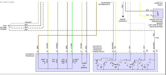

on my older APV van it a simpler setup maybe just a wire to TCC solenoid that when energized produced lockup. ths trans i see has something called PWM TCC along with TCC solenoids. a complication? although i recall from reading some crossover work that they ignored wiring the PWM with no ill effects. im assuming the input is a +12v? dont know how soon i can get a scan or where yet.

FIXITMR
  • 9,990 POSTS
this page has good info on the 4t60e transmission electrics
http://www.automotiveforums.com/t961954-transmission_problem_tcc_.html
i guess the solenoids are all hot until they are grounded by computer. also says TCC should work fulltime unless commanded not to. always on, commanded off which is the opposite of my old van always off commanded on.
Apr 18, 2016 at 10:00 AM
FIXITMR
  • 9,990 POSTS
just to clarify always on meant always getting 12v and using ground as the control. i know, even i got confused! so to test it i just have to check for ground signal if there is 1 then solenoid itself may be problem. hopefully code read will also help if i can get 1 soon.
