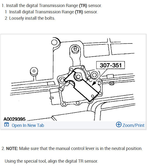

Had the transmission gear shift cable replaced and then the PCV valve hose. Now my overdrive light is off, and blinking.

Off or blinking? If the shift cable wasn’t adjusted correctly after replacement, the PCM may be seeing that the gear lever doesn’t match the actual transmission range. It takes a special tool to do the job correctly. Check out the images (below). Let us know how it goes

Well, my guy came, checked everything, tightened a couple loose screws, and stared it up. Overdrive light is still blinking.
Could it be a safety light telling you that something could be wrong with things for the transmission so you don't do severe damage to it?

Since the overdrive light is blinking lets run the codes to see what we are dealing with. This guide can help.
Please go over this guide and get back to us.

After installing the transmission gear shift cable and checked several times the truck will not go forward when I put it in drive.
Oct 9, 2025 at 3:21 AM
  • 55,748 POSTS
Did the transmission work before the repair? If so the cable can be not adjusted correctly. On level ground with the parking brake on, I would remove the cable from the shift arm of the transmission, and put the shifter in neutral, then put the transmission in neutral and see if the cable lines up perfectly with the shift level of the transmission.
