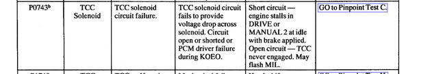

My overdrive light flashing. Code PO743.
Nov 28, 2018 at 9:38 PM
Good morning,

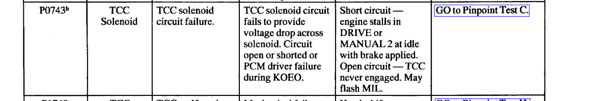

The 743 is for the torque converter clutch solenoid. I listed the possibilities below.
This code is quite common. One of the first things I would do is to change the oil/filter in the transmission. It could be dirty fluid.
P0743
Descriptor
Probable Causes
Powertrain Control Module (PCM)
Torque Converter Clutch (TCC) Solenoid
